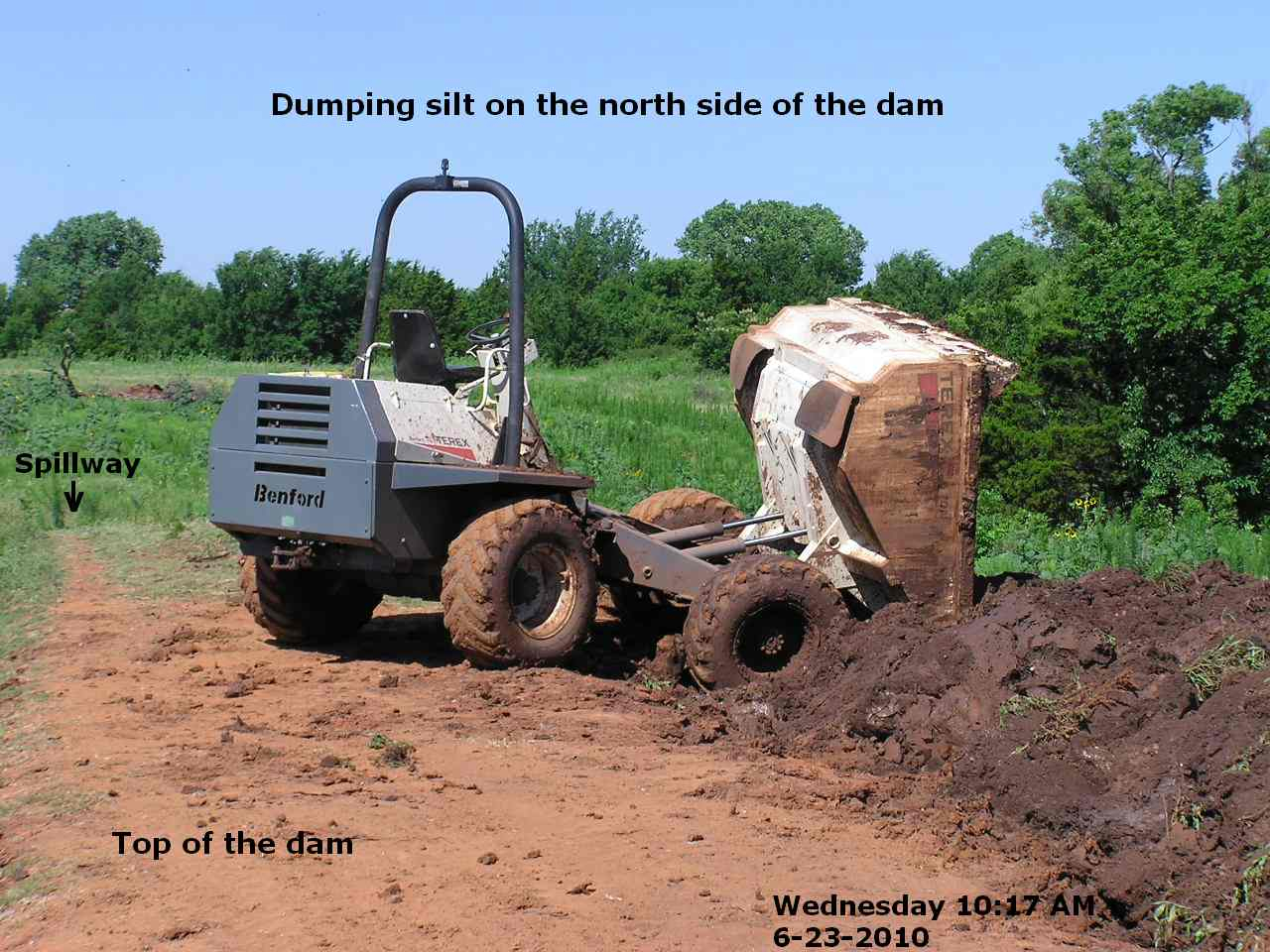

If you have an articulated 4 wheel drive machine (like I do), it has to be able to do this:
- sitting still, turn the steering all the way to the left.
- as it turns, the two left wheels roll towards each other as the two right wheels roll away from each other.
- now turn the steering all the way to the right.
- the two right wheels will start rolling towards each other as the two left wheels start rolling away from each other.
How are you going to accomplish that with 4 electric motors?
Plus, you then have to consider the rate of movement at any speed or direction.

I don't know, my articulated machine is has differentials and is big and heavy:

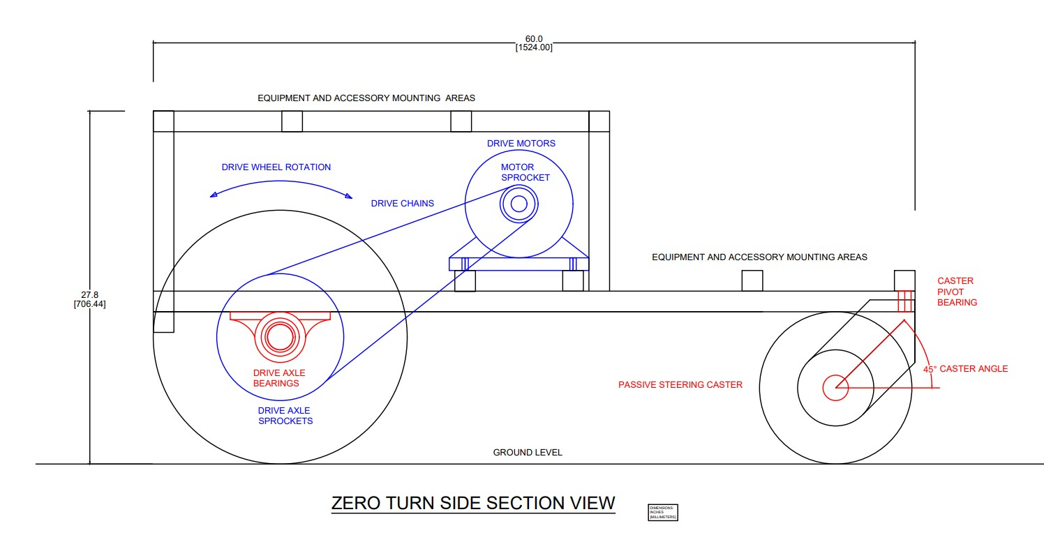

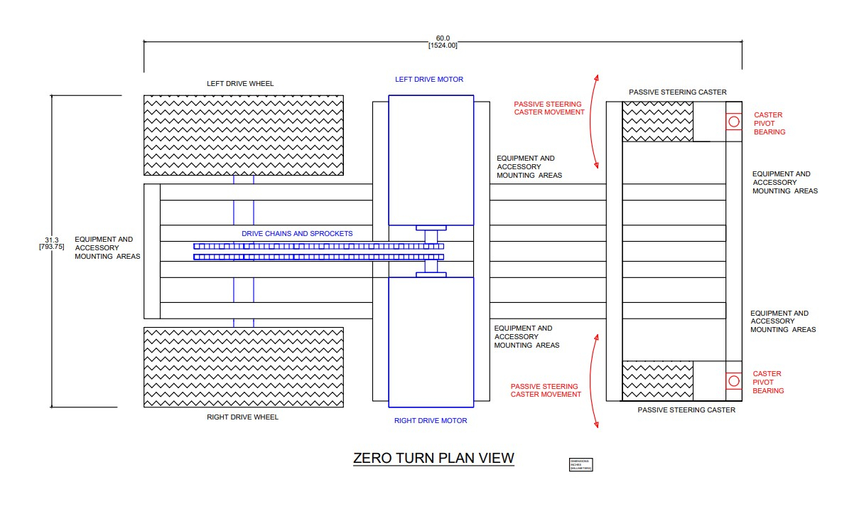

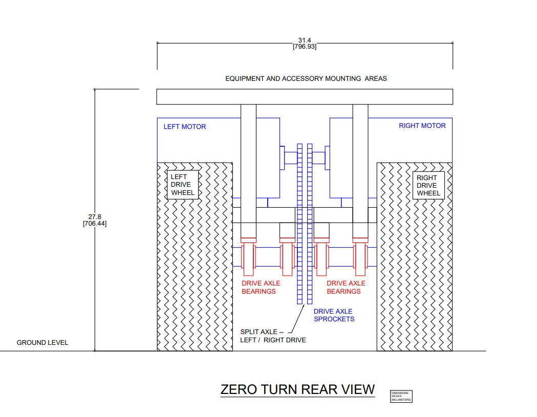

Here is the First Draft on Zero Turn.
Comments, Suggestions, OMGs all welcome.
Here are some notes ==
+ Steering Caster may be too much -- maybe more vertical?
+ Drawn with 20 inch tires. Frame is spaced to handle up to 24 inches.
+ Drawn with 1:5 Sprocket Ratio == motor nominal RPM is 1200 RPM.
+ Bigger tires may be better -- however, the larger the diameter, the more I have to gear down the sprockets.
+ Maybe the Drive Wheels should be "Front?" Lets it climb over things easier.
+ Over all dimensions are just what turned out. Trying to keep width under 3 feet to let it get through narrow paths, doorway, gates, etc. Could cut length down to 4 feet -- just trying to prevent it from flipping backwards with a pulling load.
Add on Edit -- Brakes. I am planning on using VFDs as load regeneration to stop either or both motors -- BUT -- I see I still need Emergency and Parking Brake(s). Looks like the left and right split axles may be the place to put those.
Caster angle isn't 45, it's zero. Measured through the center of the yoke shaft going up through the bushing mount in the frame.
okay. I follow the pivot bearing is straight up and down -- but what about the ideal angle between the center bearing of the wheel, and where the bottom of the pivot is attached?
sample pictures >>> Caster - Wikipedia
Thanks. Also you have the ability for the connections between the front and back section to swivel -- so all 4 wheels stay in contact with the earth on un-even ground.
I figured I might try to avoid that feature to start, but maybe I should do that, as well, as it will put less stress on the frame pivot bearing(s).
That angle is immaterial. You could build it any way you want and if the wheel axle is the same offset distance from the center of the pivot the wheel will act the same.
