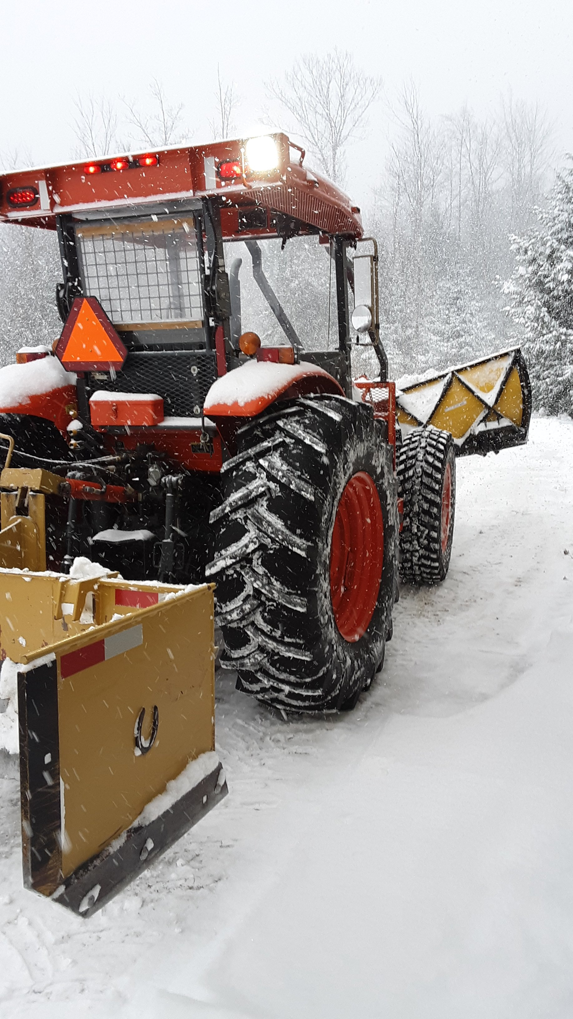

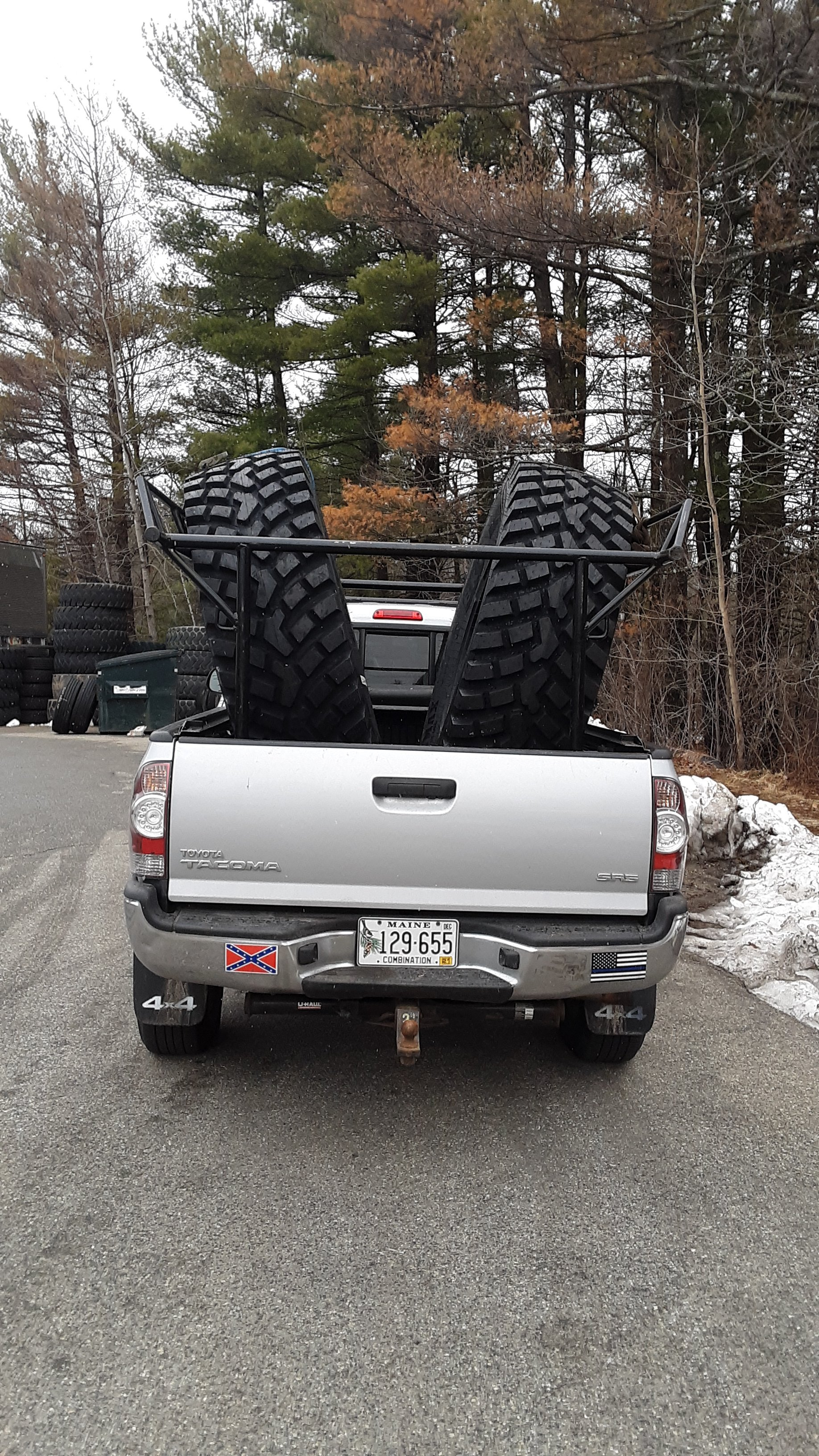

I have some of the Nokian style tread but I don't believe that it's the "softer" rubber. I found a pair, mounted on wheels that were "take off's" from a sprayer for my fronts for a good enough price to try them. They are very good in the snow and I think almost equal to the R-1's with screw in studs. The road ride is incredible.
My rears are developing cracks and I bought a set for them but I'm waiting for a failure before I mount them up. The fronts are by Alliance and the rears, BKT. Both the old and new are/were radials. The fronts seem to offer the same traction for the summer work in my soils, but for those who are operating in clay I'd be concerned with the tread filling up. The rears are still un mounted for any summer appraisal.
I'm expecting much more life out of this thread pattern.
