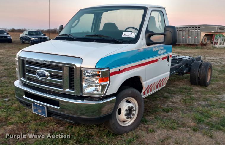

Here you go....
Used Construction, Agricultural Equip., Trucks, Trailers & more
It's ugly and nobody wants it....

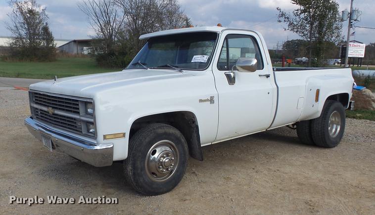

   / Best tow vehicle for 3 grand? Van, Suburban, or truck. #38
It's brand new...1000 miles. Looks like it was in an accident though, said frame bent etc.

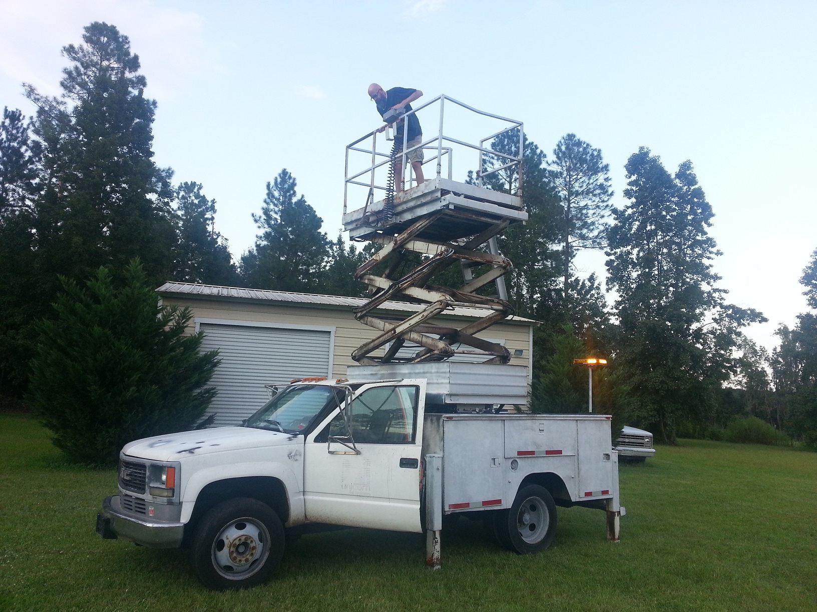

bought mine. 1994 scissor lift truck with service bed. For $1800 drove it home with working a/c. Put on new brakes. Wipers and Water pump. Sold service bed and lift. Made back $1740. Added flat bed for $800. To date truck cost me $860.
Oh yeah shes depenable with a 454 and 74,000 miles.
Not perfect but certainly didnt cost me $50,000 either.

Before and after
