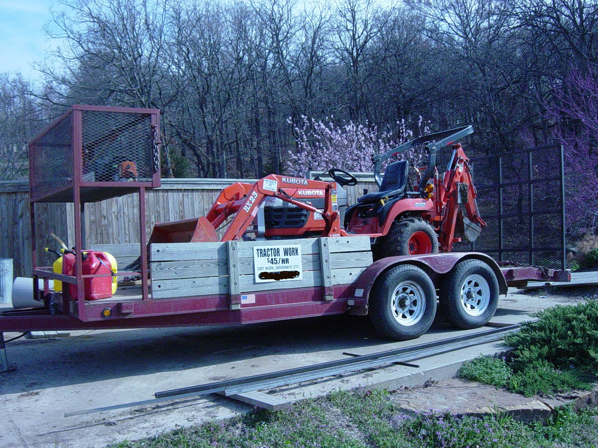

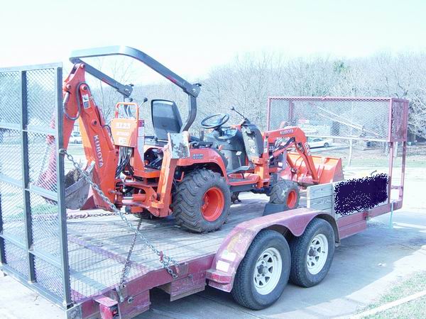

i use a 18 foot car hauler type trailer to move mine, i bought the trailer for 600.00 used and put new tires on it as soon as i got it. I have also done alot of fab work on it to make it better suited to my needs. here is some pics, i do landscape,lawns and tractor work.
my b3030 gets here this am i hope it fits :confused:
Workin . . . I was looking at your photos and noticed that you do not have the backhoe or the loader bucket secured for trailering. If I read the D.O.T. towing regulations correctly for commerical carry (which I believe would apply to you), I believe you need to have the loader and the backhoe individually chained down, in addition to the tractor being changed down. It sounds like overkill, but you might want to look into it before you face an unnecessary fine.
   / Best Trailer Choice? #18
i dont know about the regulations, ive had many a trooper behind me but non has ever pulled me over. when they delivered my b3030 yesterday he had a chain through the front loader and one through the subframe mount on the backhoe. i have had the 3030 on the trialer allready and went with the chains the same way as he did. The rental store my buddy picked up a b21 chained it down to the trailer the same way. i did add a clevis to the draw bar to run the chain through and never transport without the pins in. guess i need to do some diggin for DOT info.
   / Best Trailer Choice? #19
Troopers rarely know the trailering laws until there is a DOT crackdown. We seem to have a regulations check about 1 month a year every year. Then when they do crack down the whole concept of "ignorance of the law is no excuse" will get you a ticket every time! What I see is that people "get away" with stuff that is dangerous, or illegal, or both. The question is do you want to be safe and legal, or do you want to get away with something until you get caught?
I prefer safe & legal; I'm just offering up a friendly bit of advice to check the laws that apply to you.
   / Best Trailer Choice? #20
Bob is right. The attachments need to be secured as well as the tractor. Just because the trooper may not know this and give you a ticket doesn't mean the DOT won't. Usually the DOT in my area works in the rest stops along the highway but I have seen trucks and trailers pulled over on back country roads if they saw a load wasn't secured properly.
