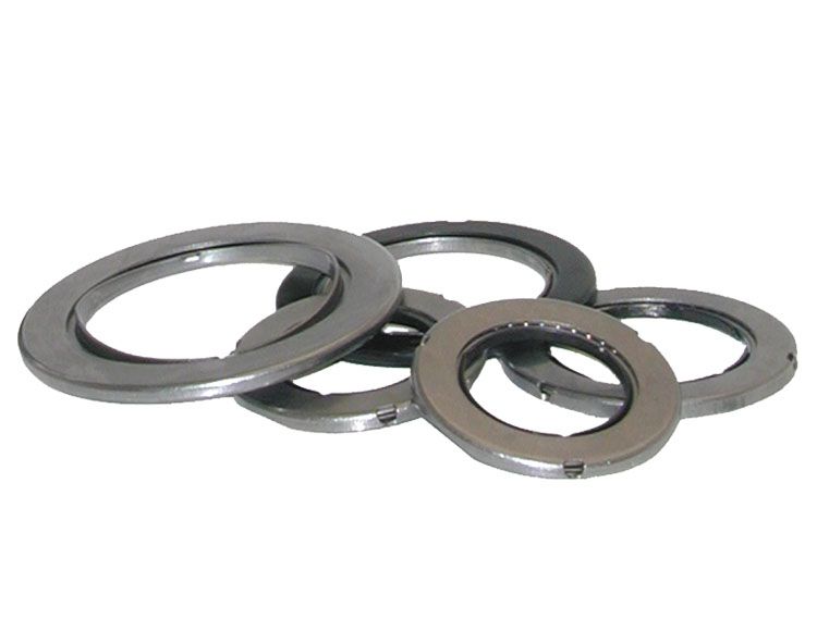

My son had a smarty , ( model # ???? ) on His '06 2500 for a year or so before he blew up the transmission . Transmission was the 68RFE , which , Stock , is o.k. , but adding the extra torque / h.p. , killed it . Rebuilt it myself , although no thanks to him , I had to actually put it together and take it back apart multiple times . Won't go into that fiasco , But the newer transmissions are pretty easy to work on . The one complaint I have heard on programmers around here is the same for any brand of programmer or truck , Transmissions are the weak link . If you do get one , think about adding at least 1 gauge , a transmission temp gauge . You can tell a lot just from that 1 gauge .

Correct , 2007 with the 6.7 , Mine is the 2006 . :duh: The 68RFE can be rebuilt pretty stout with all kinds of clutch plate combo's , custom made shafts , etc... , But the weak link in the whole thing is the roller bearings through out the transmission .
If something goes in transmission , like 1 of the clutch packs , Best to replace and save future headaches .
