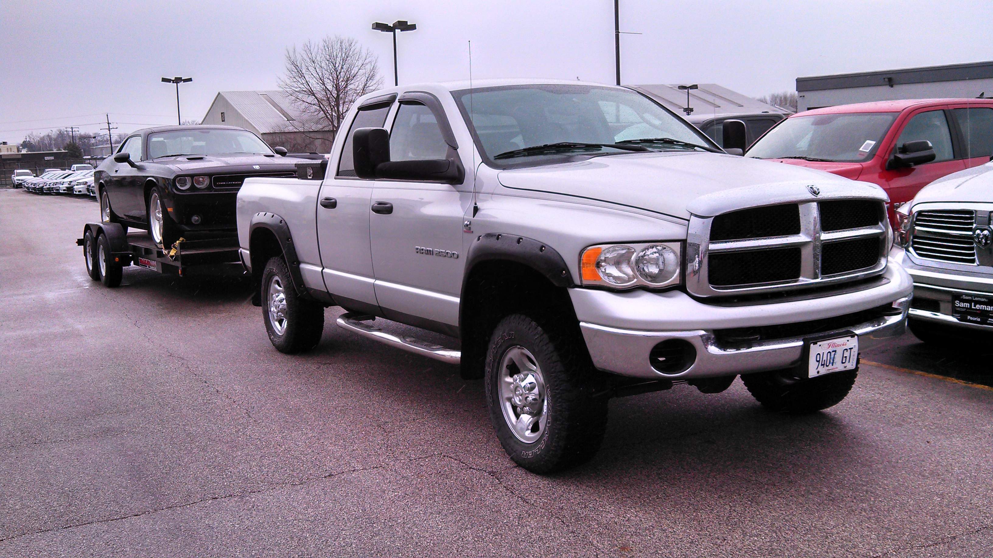

I know when I owned my 04 Cummins I wish it had another gear. It was an auto with 4.10 gears.
A couple of things drove me out of my Dodge. The biggest was rust. I had it reparied a couple of times in different places but it was a constanst battle. I also had a high speed vibration at about interstate speeds. It seems to be a common problem, it was probably a driveshaft issue but I chased the problem a little bit with no luck. Also the truck was very loud. Not the engine, which I liked the sound of it, but wind noise. Going into a head wind was about like being in a open cockpit airplane, poor door seals being the main issue. It was a good truck, but not great. I traded into a Chevy 2500 and love the truck but miss the Cummins and its better fuel mileage.
