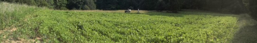

For grains and grasses you really don't need to cut the ground very deeply. A couple of inches on top is sufficient. A sprayer to kill existing vegetation and spray Roundup Ready crops, a disc of some sort and a cultipacker would be good additions to your attachments. Seed to soil contact is critical for grasses and cereals to germinate so a cultipacker is an important tool for food plots. They can be broadcast and don't necessarily have to be "planted".
For beans and corn you will need to plant deeper and will need a deeper seed bed. A disc can get you there. Beans for food plots can be broadcast but need to be covered with a chain harrow or other type of surface drag. I suppose corn could be planted the same way, but most I've seen has been planted with a row type planter. That is something you might be able to borrow.
I am now spoiled by my 72" PTO driven tiller. I dream of a no till drill but for food plots I can't justify the cost.
Here is a panoramic photo of my best plot last year - forage soy beans.
