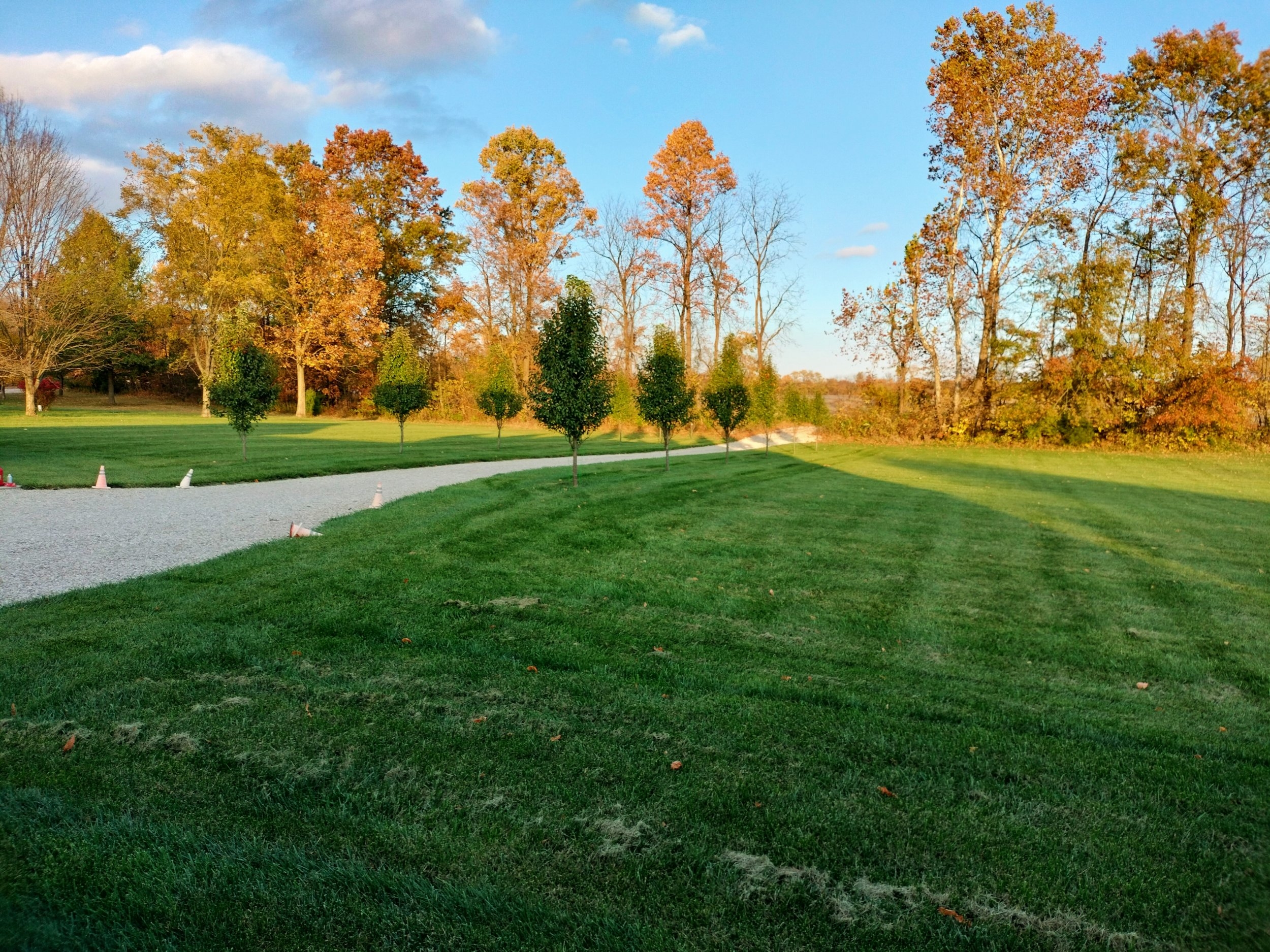

I've always slit seeded my lawn. It's two acres, but thats doable. You can rent 3pt drills. It took a couple years to get a nice solid stand, but it's worth the time. This was a really poor hay field when we built a few years ago. Seeded twice. A little fertilizer. Pre emergent in the spring to knock down the weed seed bank over a few years.

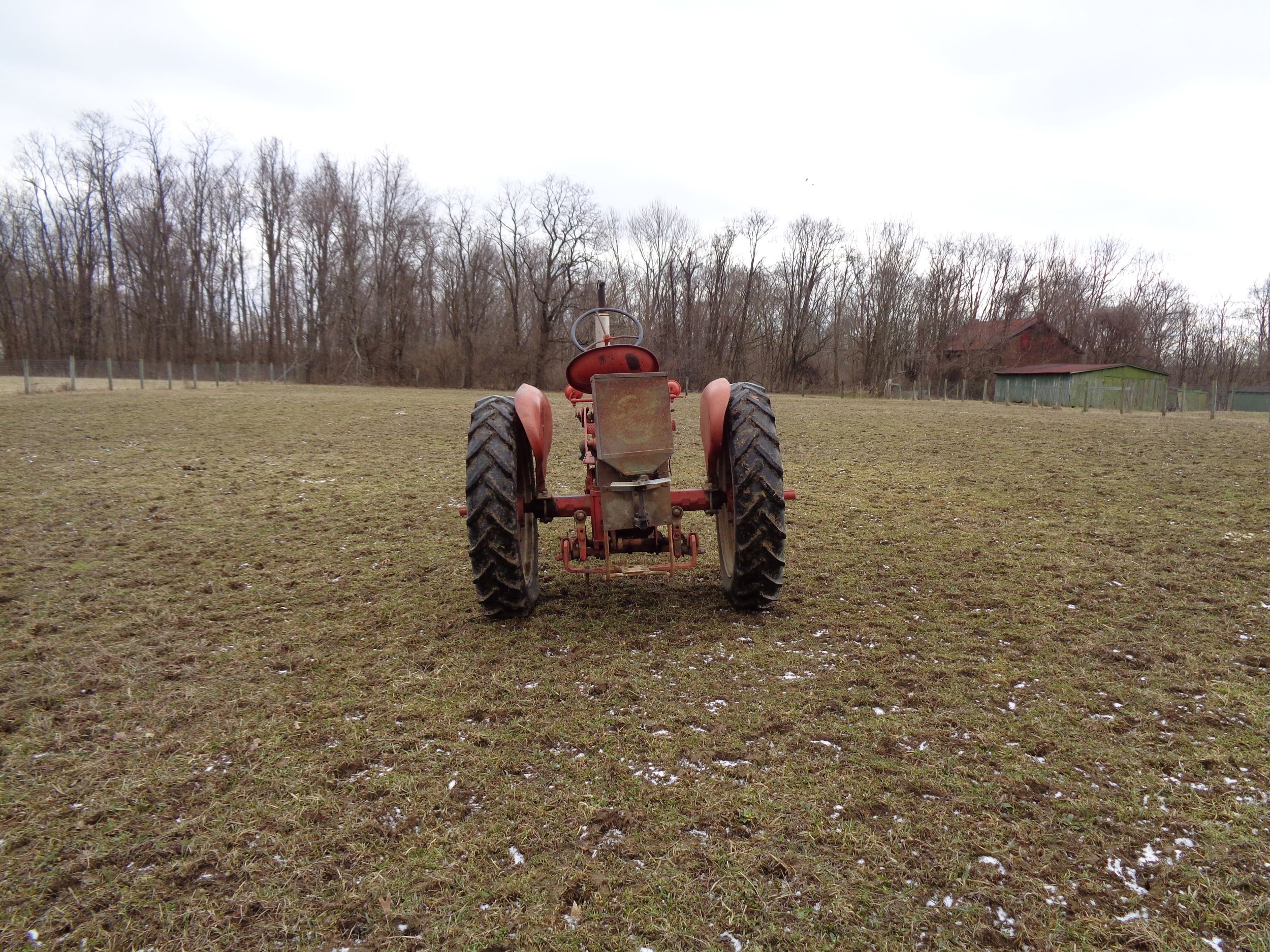

Too bad you're not further North and, seed bed was prepped to take advantage of the weather using the frost seeding method. You're basically mimicking Mother Nature. Spread the seed and when the dirt honeycombs due to freeze, when it thaws it will pull the seed covering it.
That's how I reseed my small pastures, works like a champ. Usually do mine in the last 2 weeks of Feb., first 2 weeks of March. Just have to wait on that window of opportunity when the ground is frozen, and little wind using my old Garber Seed Easy broadcast spreader.

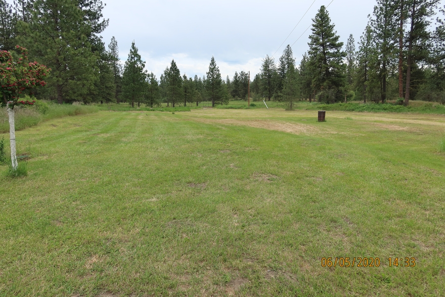

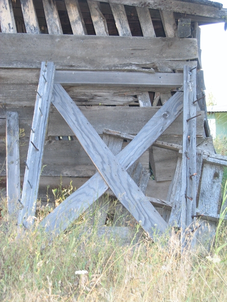

So - this is what I did on a 3/4 acre pasture near my house. I have a homemade "drag". Smooth on one side - turn it over it's toothed.
Hooked it behind my ATV and thoroughly drug the pasture - tooth side down. Hand seeded the pasture with seed from a local seed company. They said - "made for local soil conditions - no need to add any augments" - they were right.
Hand seeded the pasture - turned the drag over - teeth up - drug the pasture to cover the seed.
My home made drag and the pasture now - after three years.

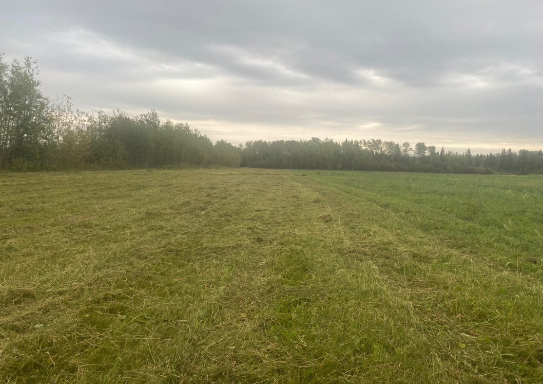

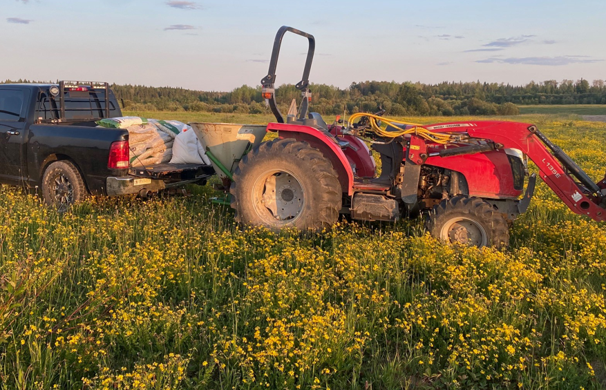

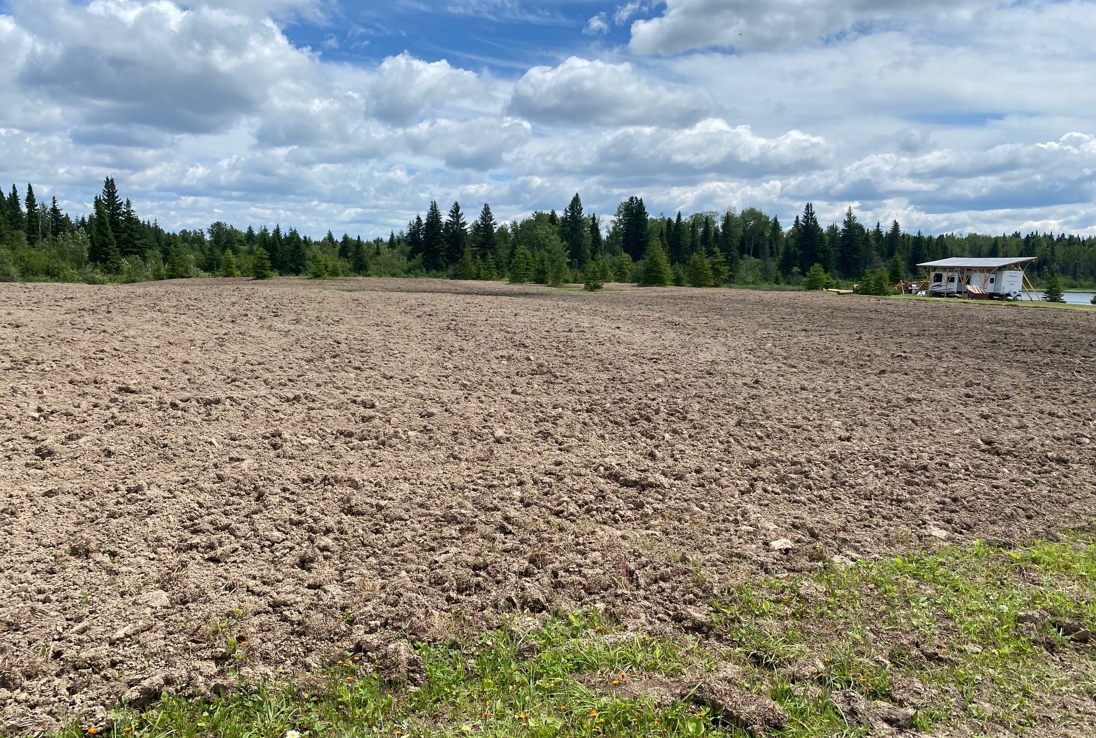

I did 17 acres of field a few years ago, I spreaded my seed and fertilizer with a PTO spreader, then rolled it. This is was for making hay.
before seeding, it was a little too soft it did took a while for the seed to germinate but they did.
First fall (seeded in early June this was late September we also had a wet year) after the first trim
Second year mid summer

The seed I got from the big seed company had all native seed. There were many different mixtures. I bought the one they recommended. There is one spot - next to the burn barrel - where nothing has ever grown. Not enough soil over bedrock.
