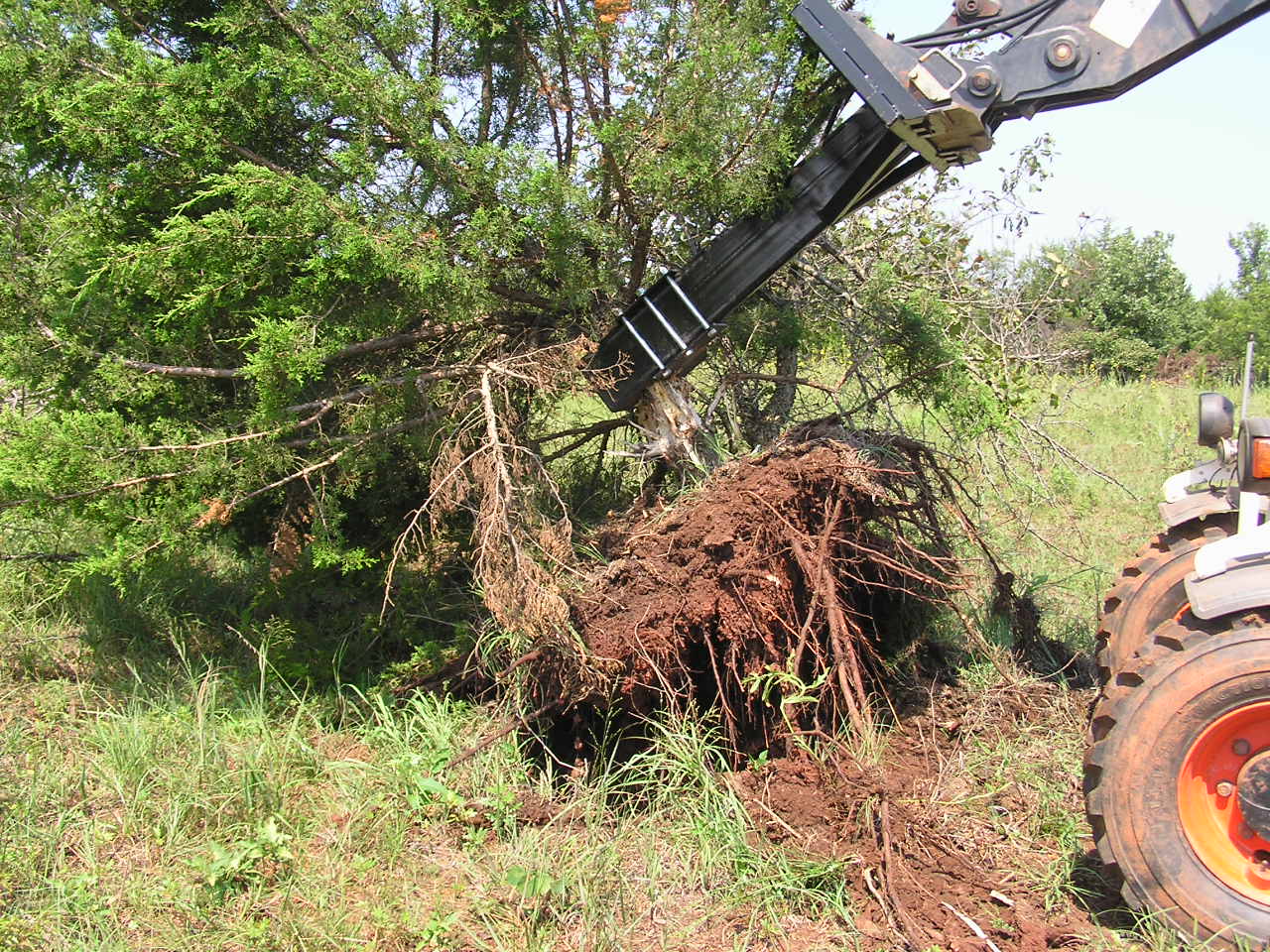

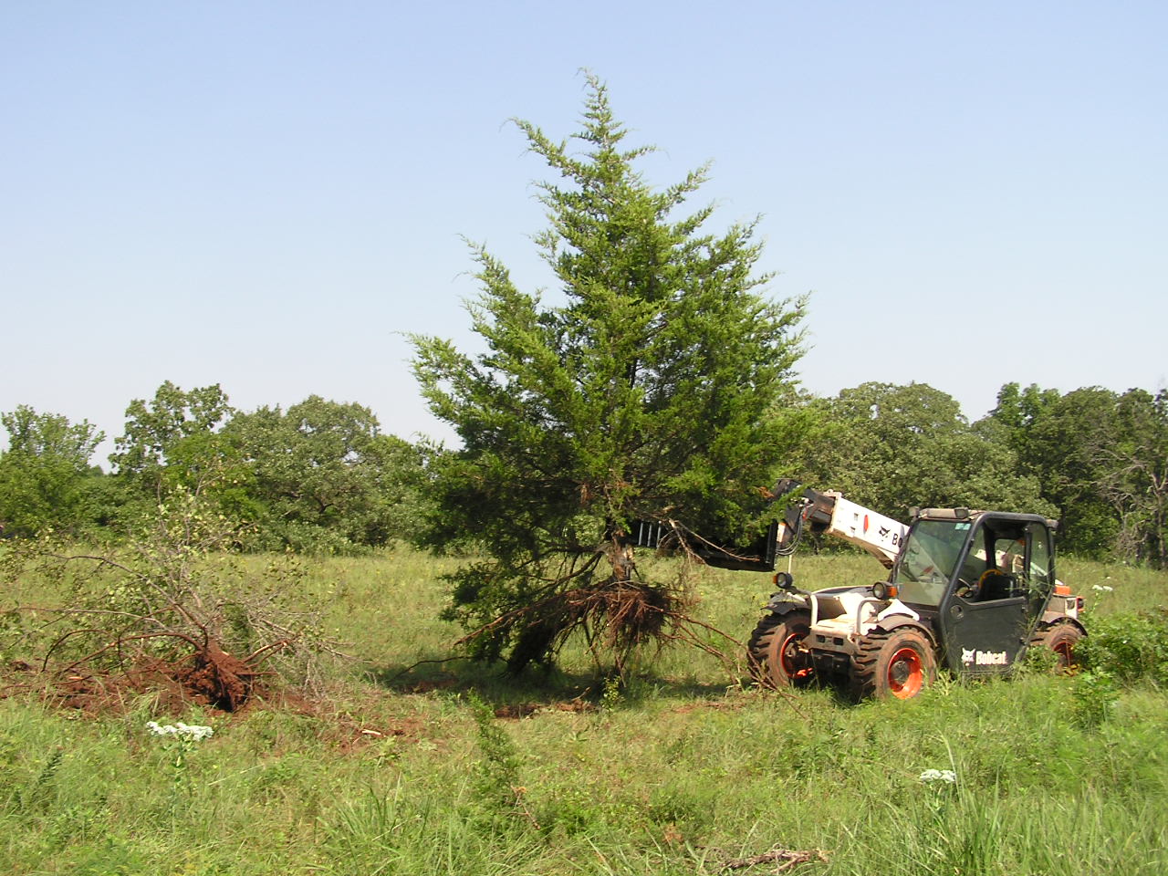

I think that would depend on the tree puller design. I never had one shred.
Mine gets a good grip on the trunk:
   / Best way to clear unwanted trees from pasture
#49
Cool! After you pull the tree, do you use your FEL to push some dirt in the hole and pack it down?
   / Best way to clear unwanted trees from pasture #50
Some dirt comes up with the roots:
Most falls back in the hole when you shake the tree and I drive on it to pack it down:
