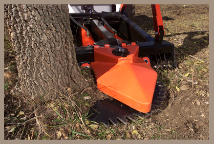

Knoxville. I'm thinking hard about getting one of those TurboSaws. Has it been reliable? Do they have good service? How much does it cost when you need to replace the cutting teeth.

My saw is the one with the grapple. It was designed for use up to 100 hp. I fairly sure that I would destroy my tractor before hurting the saw. I bought a Harbor Freight 3-point quick attach that makes mounting it much easier. It has zerks on the PTO shaft and filler for gear oil on the transfer case. I bought a set of replacement teeth just to have on hand since I had chipped about 1/2 of the teeth due to hitting metal. The teeth are VERY!!! difficult to remove. Do not even try without a 3/8" impact rated allen socket, a breaker bar and propane heat. I do not remember the cost of a set of teeth but the $300 range seems right. I have filled it with gear oil once and greased the U-joints once. It is built like a tank. An Ag equipment dealer had one at a big Ag show and bought the demo unit.
