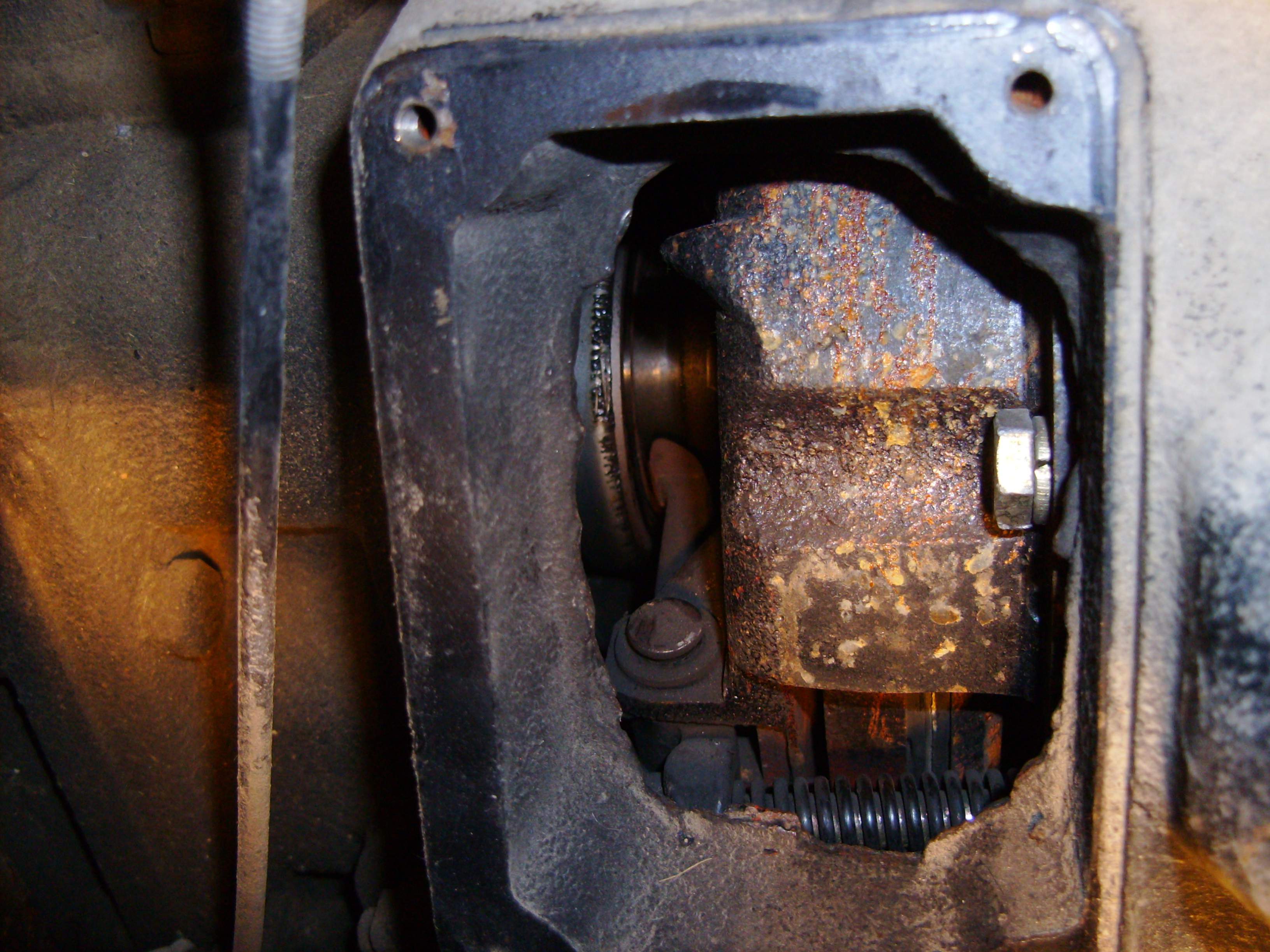

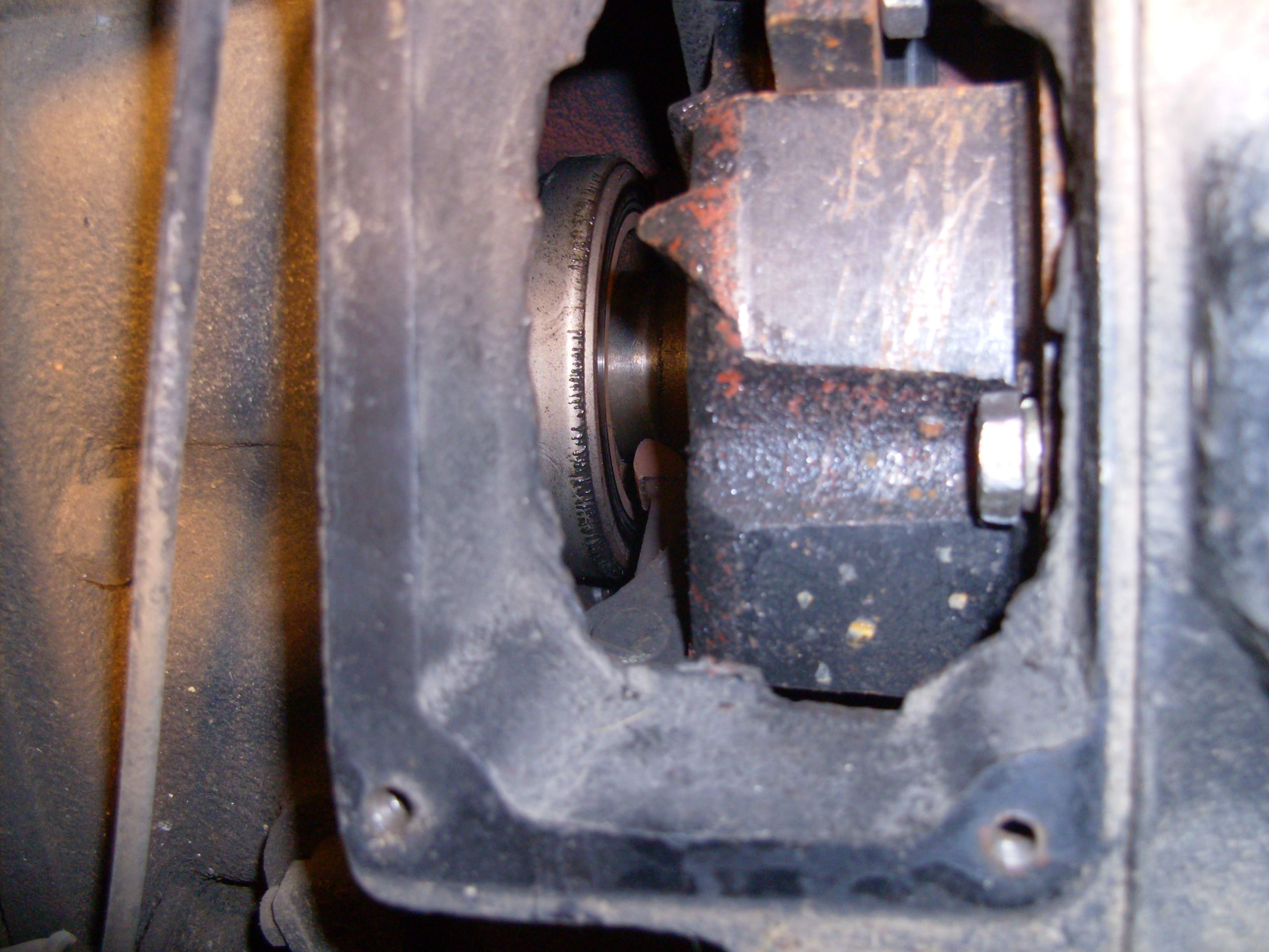

Also note that there (On older JINMAs) is a Grease Port on the throwout Bearing. these typically never got lubed and caused the bearings to lock up and would grind away the clutch fingers as a common problem. I know it is dang near impossible to find it as they tend to fill up with dirt and you cant tell its even there. small round hole that needs a Needle Greaser to get any into it...
The discoloration is a common clue this may be happening. riding clutch also causes it as the bearing is working for extended time and overheats burning right through the clutch fingers then happens and the peddle drops half way down and the clutch action is gone.

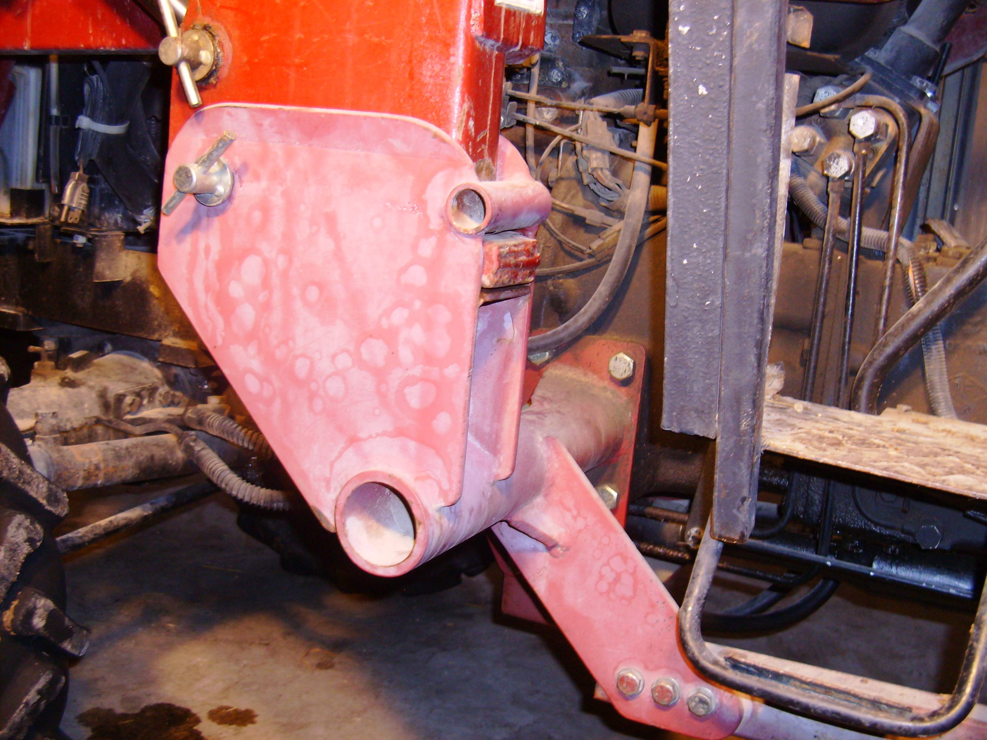

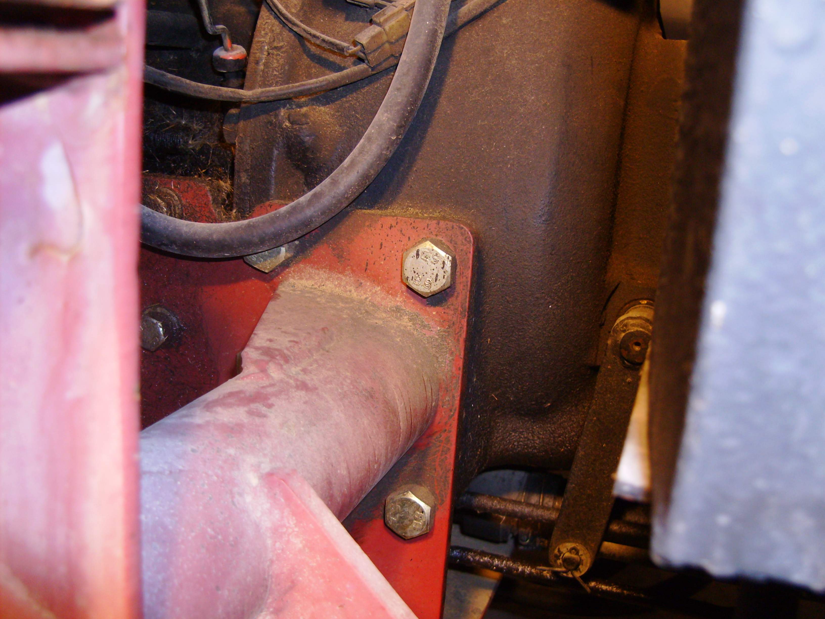

Sounds good, thanks for all the points. Drill bits should work good for a feeler, I was wondering what I could use that would work good. If I take off the FEL bracket shown on the picture can I access the bell housing through there? It looks like I should be able to unless that is closed? There's a whole lot more room through there if that would work!! Thanks again for all the help, I'm back to work tomorrow so probably won't get much done now 'till next week.

   / Best way to fix this??? #23
Yep, pull the mounts and there will be a hole to work in. Its tight but doable.

Well, I just spent the last hour pulling that mount off and I guess the TM432 is a little different b/c there was no access there. The bell housing is cast over where there would have been access!! That only leaves the small inspection port on the other side, I'm not even sure if I can fit my hand in there it's so small!!
   / Best way to fix this??? #25
Sorry I didn't see the post in time to stop you, your photos clearly show the only way in (without splitting). For the benefit of others, TaskMasters are rebadged DFs (aka DongFeng and DFAM). Jinma seems to be the only outfit that's inconsiderate enough to put the inspection ports under the loader mounts.

Does anyone have a picture of what these fingers look like?
You do. They're in several of the photos that you've already posted here. And yes, they're adjustable through that little inspection window as well. Couple of hex head wrenches and a feeler gauge will do it. But quite honestly, they're significantly worn - and we don't even know what the 3rd one looks like yet. Can't help but feel it would be better for someone with a bit more clutch experience to do these adjustments for you. Given the amount of work and expense involved in splitting the tractor to correct mistakes, it's likely more prudent to conduct this as a "watch and learn" project.
And it doesn't have to be a TaskMaster dealer either. All Chinese tractors use the same finger-release style clutchpacks. Given that you've got the more common 3-finger version, any area Chinese tractor dealer with a service department should be able to assist you[/quote]
