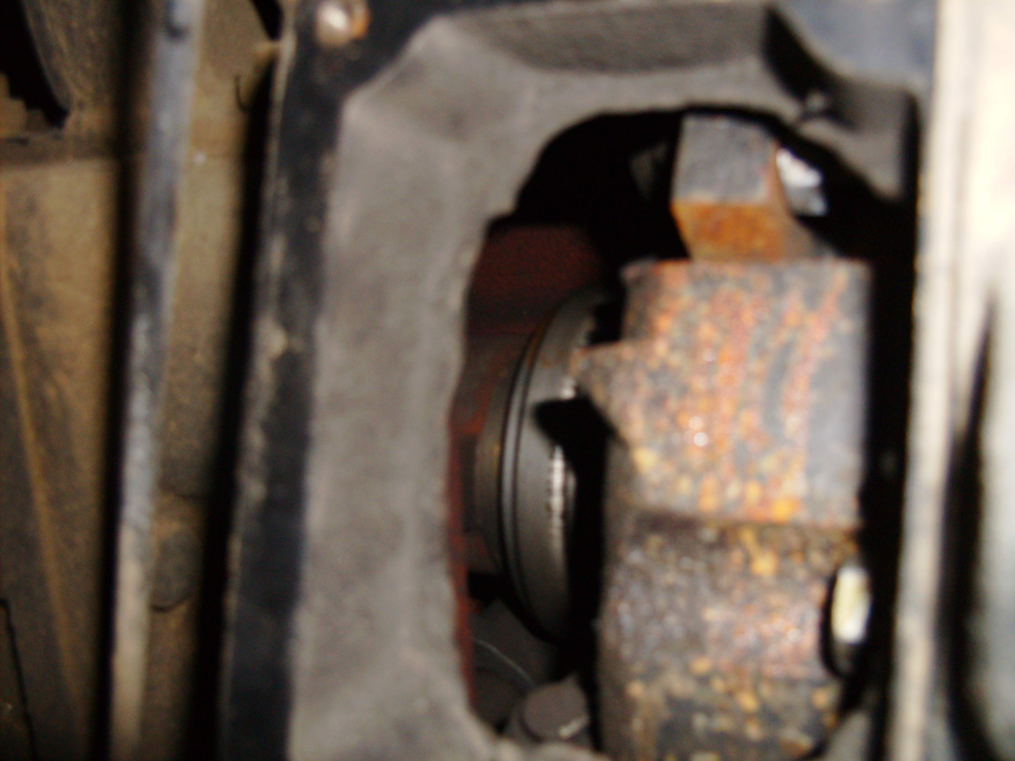

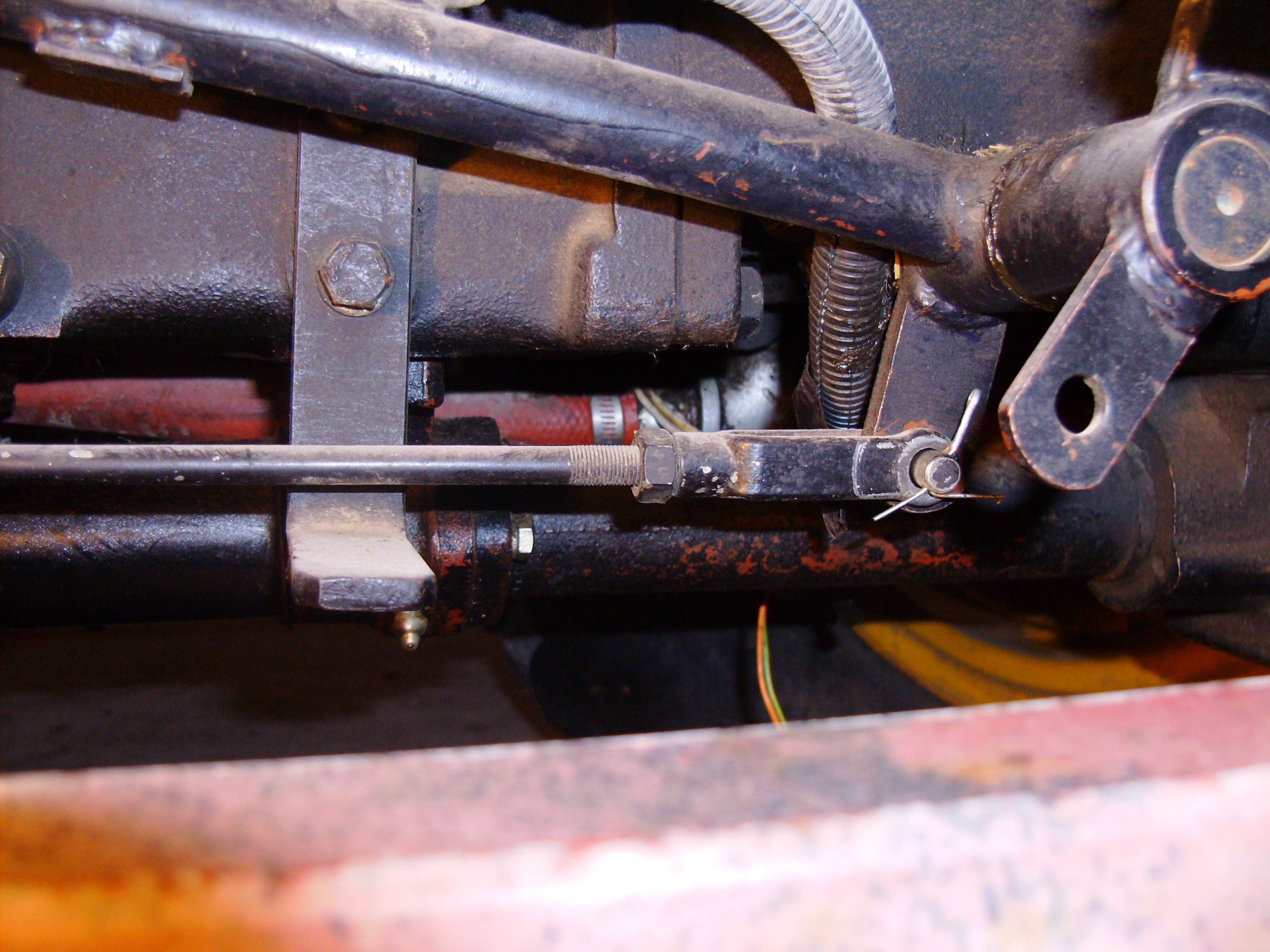

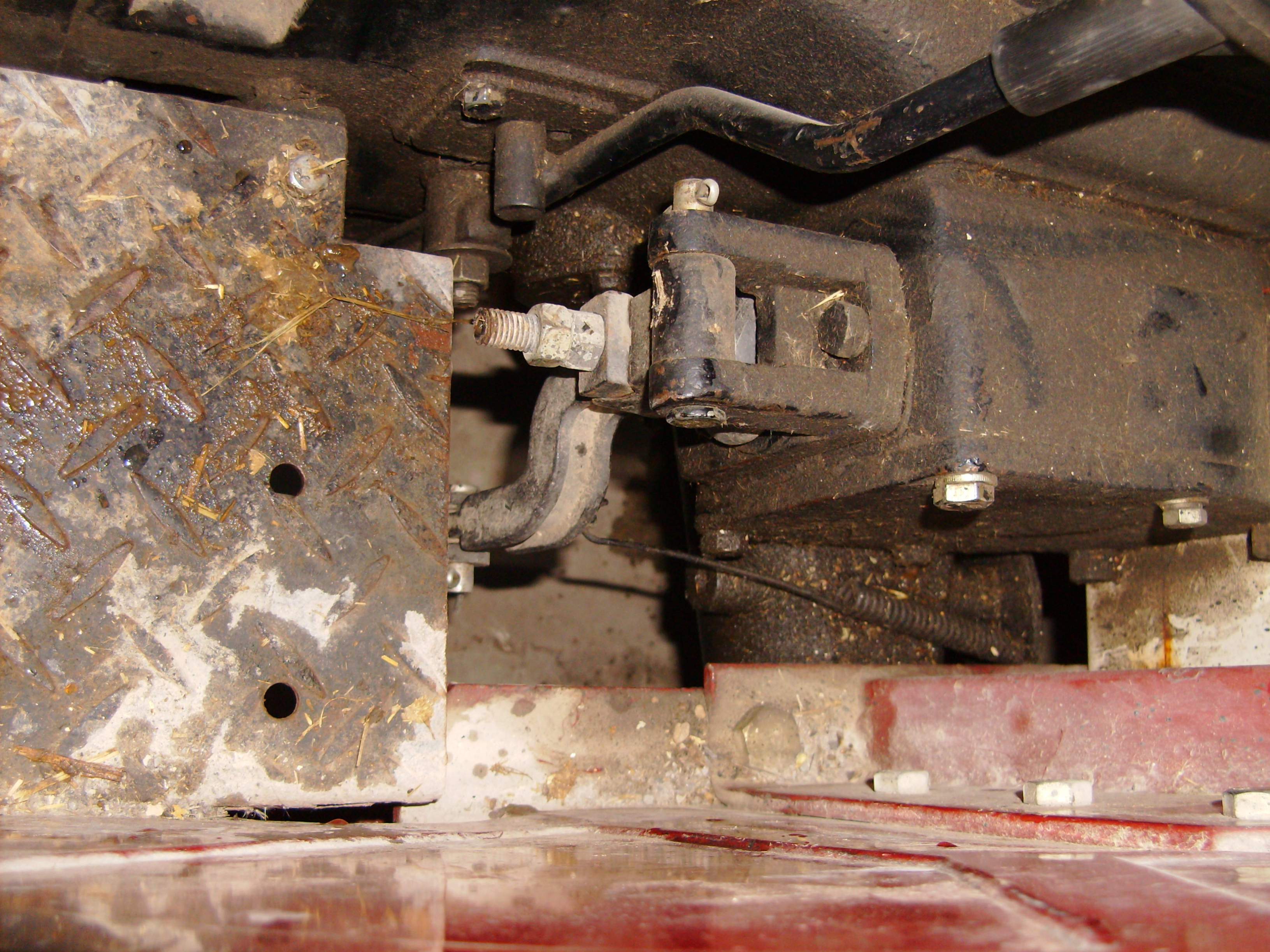

Hi, I attached a couple pics showing what I can see through the side of the bell housing. I'm not sure what it's supposed to look like, but there's not a whole lot of room to see anything. I checked the manual but all it says for the clutch is "2-late, dry type, constand meshing, operating independently double-acting clutch". The last pic I attached just shows the clutch where it goes back to the left side of the seat. Previous owner mentioned a little clutch trouble but said a friend of his fixed it up. That was 2 years ago and I haven't had any problems 'till now.

Seems in the first photo that there's far far too much gap between the visible clutch release finger and the throwout bearing (not visible). That gap is typically no more than 2.5mm (+/- 0.5mm). That applies to all 3 fingers, so you have to rotate the clutchpack and inspect all 3 gaps. Again, not sure about the TM432e, but that gap is typically achieved by adjusting the external pull rod. When there's too much gap, you don't have enough pedal. Not enough pedal will make the PTO grind. But if all 3 gaps are different, that involves an internal adjustment as well.
Can't see anything of use in the 2nd photo. In it, the throwout bearing is visible - but the finger is not. And I'm not at all sure of what I'm lookin' at in the 3rd one.
//greg//

Are you talking about the adjustment on the 3 rd pic ? That pic is of the left brake housing and brake adjustment ? On your clutch you need to take a better pic that includes the clutch finger and clutch release bearing in the same photo in order to see whats going on, it does look like the gap is big from the current pic.

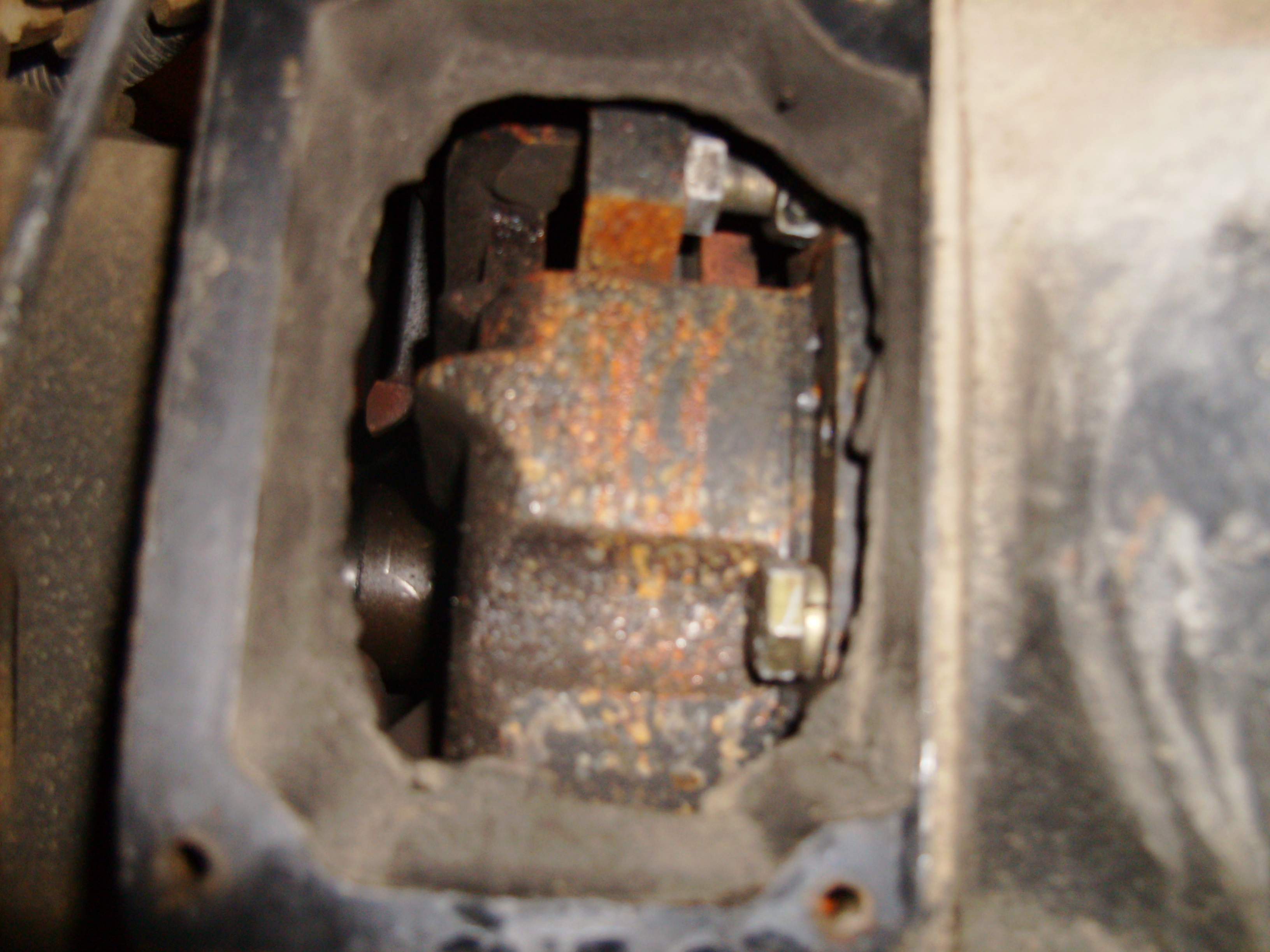

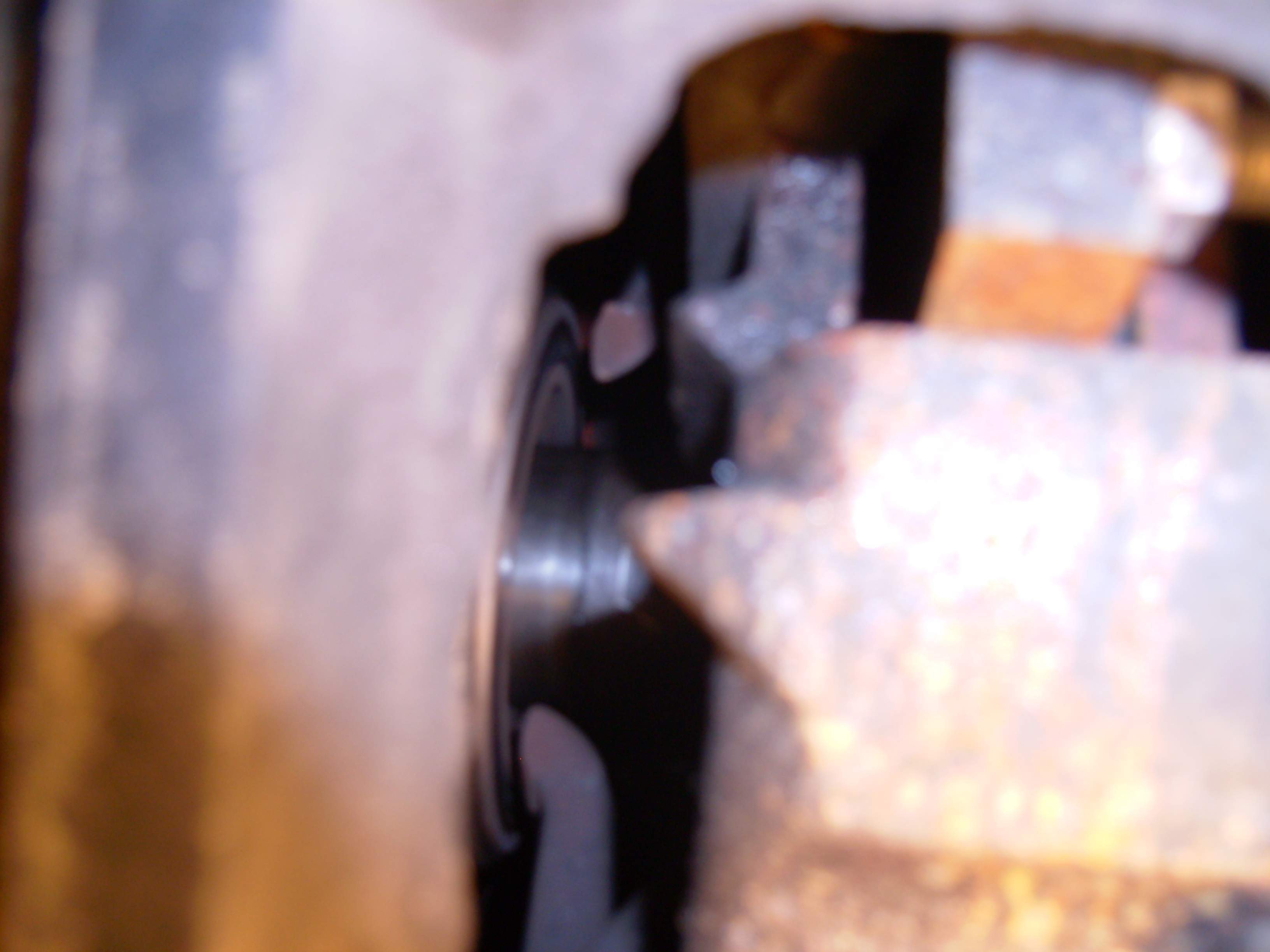

OK, I think I got a good picture here that shows the gap. FYI, it would appear there are 3 fingers, in my manual they are called Release Levers and it does show 3 of them. Secondly, I was wrong before when I said there was no room left for external adjustment. There is actually quite a bit as you can see in the second pic. What would you guys recommend for adjustment? Would doing it externally be enough or does that gap look to large and need to be adjusted as well?

The starting point is to get a set of feeler gauges and check all three finger-to-release bearing face gaps. Make sure they're all within 0.2mm of each other. The closer they are to absolutely equal, the better. Any that are out need to brought into spec or you'll just thrash the fingers in the long (or short) run. You'll need to lock the compression release open, pull the kill cable and lock it out, and turn the engine over with a wrench on the front pulley nut to check each finger gap. It takes some fiddling to get them all the same, back and forth until they're right, but it is necessary for proper clutch life.
Once the fingers are adjusted to the proper gap, then you can adjust the external pull rod to set the 2.5mm finger-to-bearing face gap and you should be in business.

1. it's clear that the two visible fingers are out of adjustment. All three should meet the 2.5mm spec (9+/-0.5mm) AND be within 0.1mm of each other.
2. finger wear. New fingers have ball tips, yours are flat. And not much of them left at that. Flat fingers are typically caused by (a) riding the clutch, and/or (b) incorrectly adjusted pull rod.
3. bearing wear. Excessive contact by the fingers prematurely ages the throwout bearing. Can't tell by the photo, but a telltale sign is blue discoloration.
Unless there's something wrong with the 3rd finger - and/or unless the TOB is blue - it may not be absolutely necessary to split the tractor at this particular time. But understand that they're not in good shape. Problem will be - without the proper ball end - you're gonna have trouble accurately adjusting the individual gaps to spec.

I agree, get the fingers adjusted then go to the pedal free play.
I did mine with a drill bit as a feeler gauge. Just found one that was 2.5mm and used it to be my feeler gauge. Its tough to get wrenches in there but its doable.
