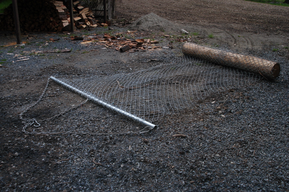

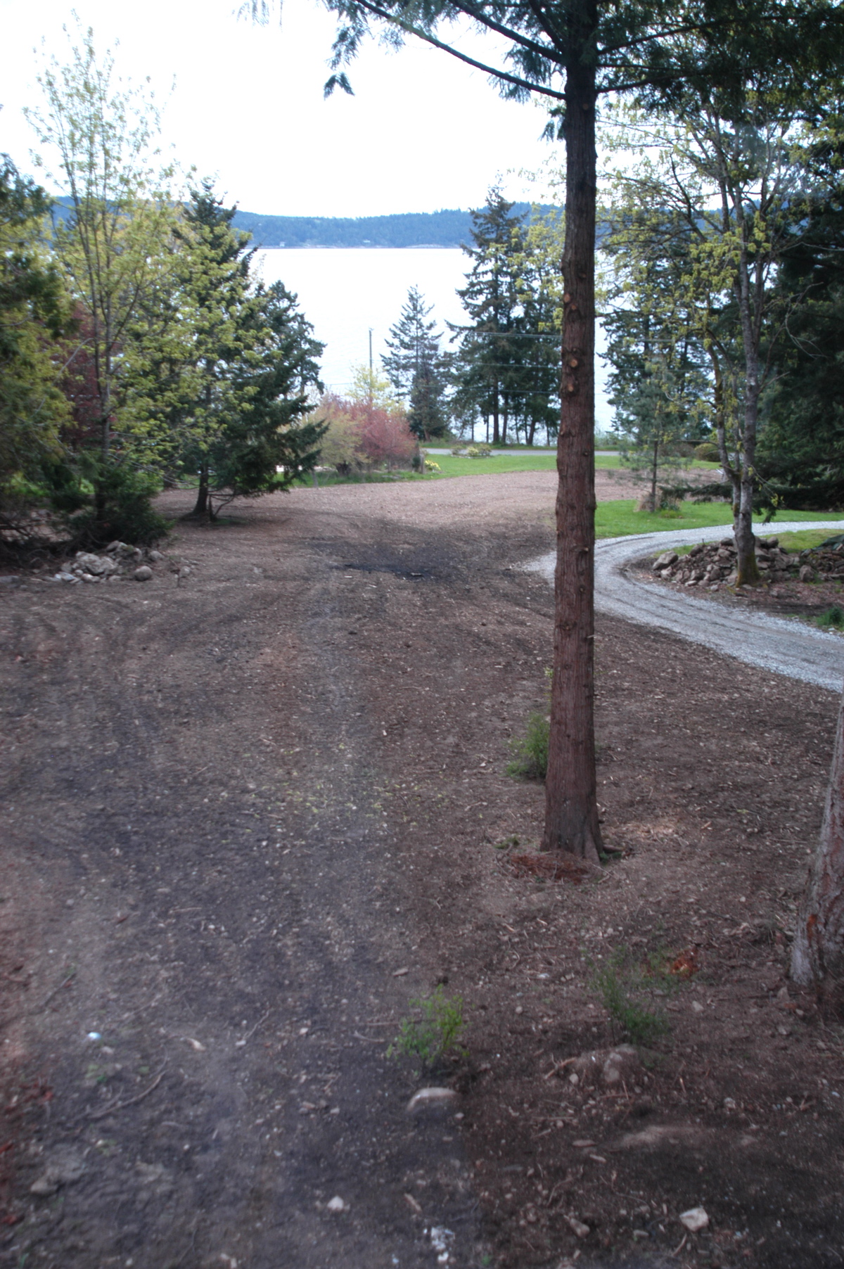

Here's a shot of a chain link harrow I knocked together to help level a 3 acre section of meadow, a small section of which you can see in the background. It took a bit of a beating but did the job ok. I hit the meadow first with the box blade, roughly leveling it and using the teeth when needed to break up hardpan. I then tilled twice (up and down then across), harrowed, sowed then harrowed again to cover the seed. All it needs now is for the seed to sprout.
The idea for this thing came from Egon. The log I had lying around and I got all the hardware at my local builders merchant.
Attached also is the finished result. I won't be able to play tennis on it but it's fit for purpose which is a bit of rolling lawn leading from the ocean up to the house.

Egon thinks maybe he just passed on others advise.:D
Nice view of Galiano.:D
