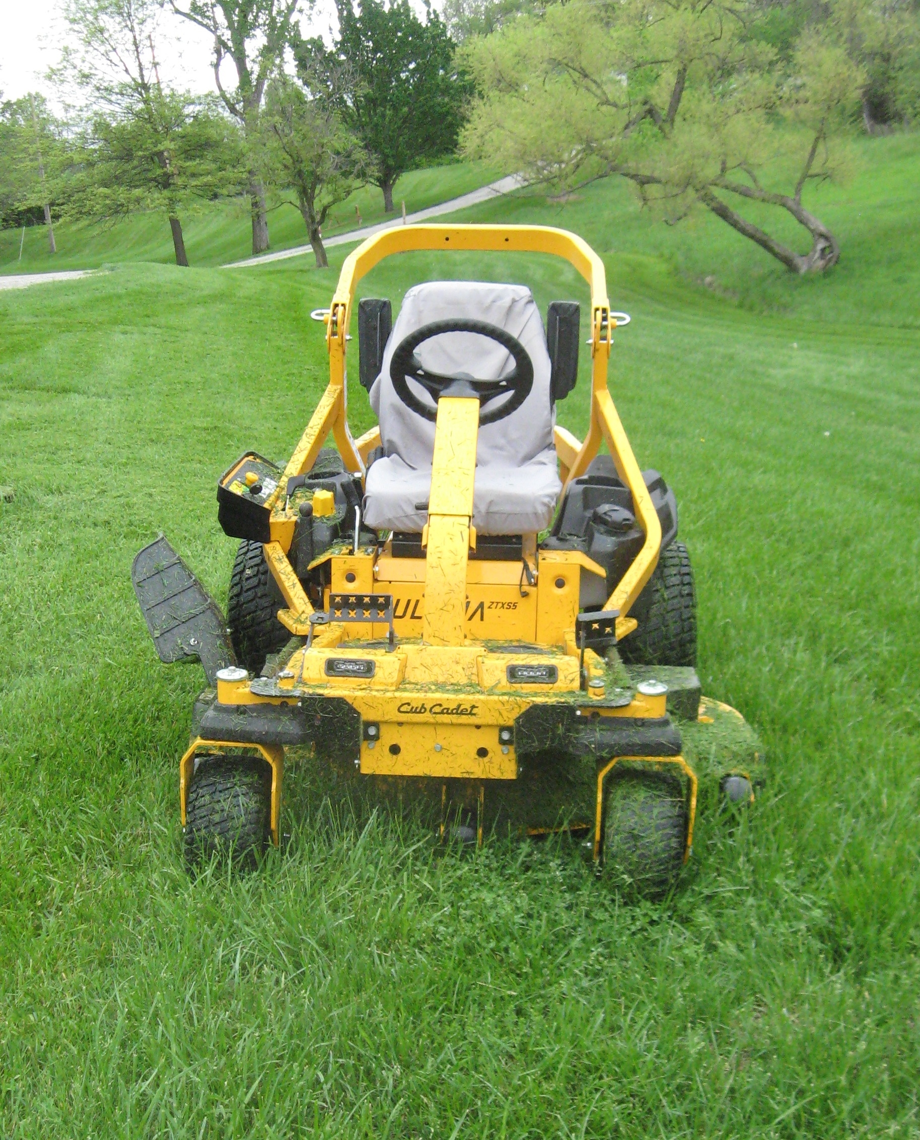

Cub plowing through 8 to 10 inches of thick, wet fescue in the rain yesterday. Handled it like a boss. Started raining after I began mowing, but it was supposed to rain for the next couple of days, so I decided to forge ahead.
Seat position mod seems to be about right and the ride was pretty comfy (except for the rain...). Machine was quite the mess afterward.
39 hours now and no issues other than the oil drip which seems to have subsided, or maybe the oil is just being shaken off from all the mowing.
