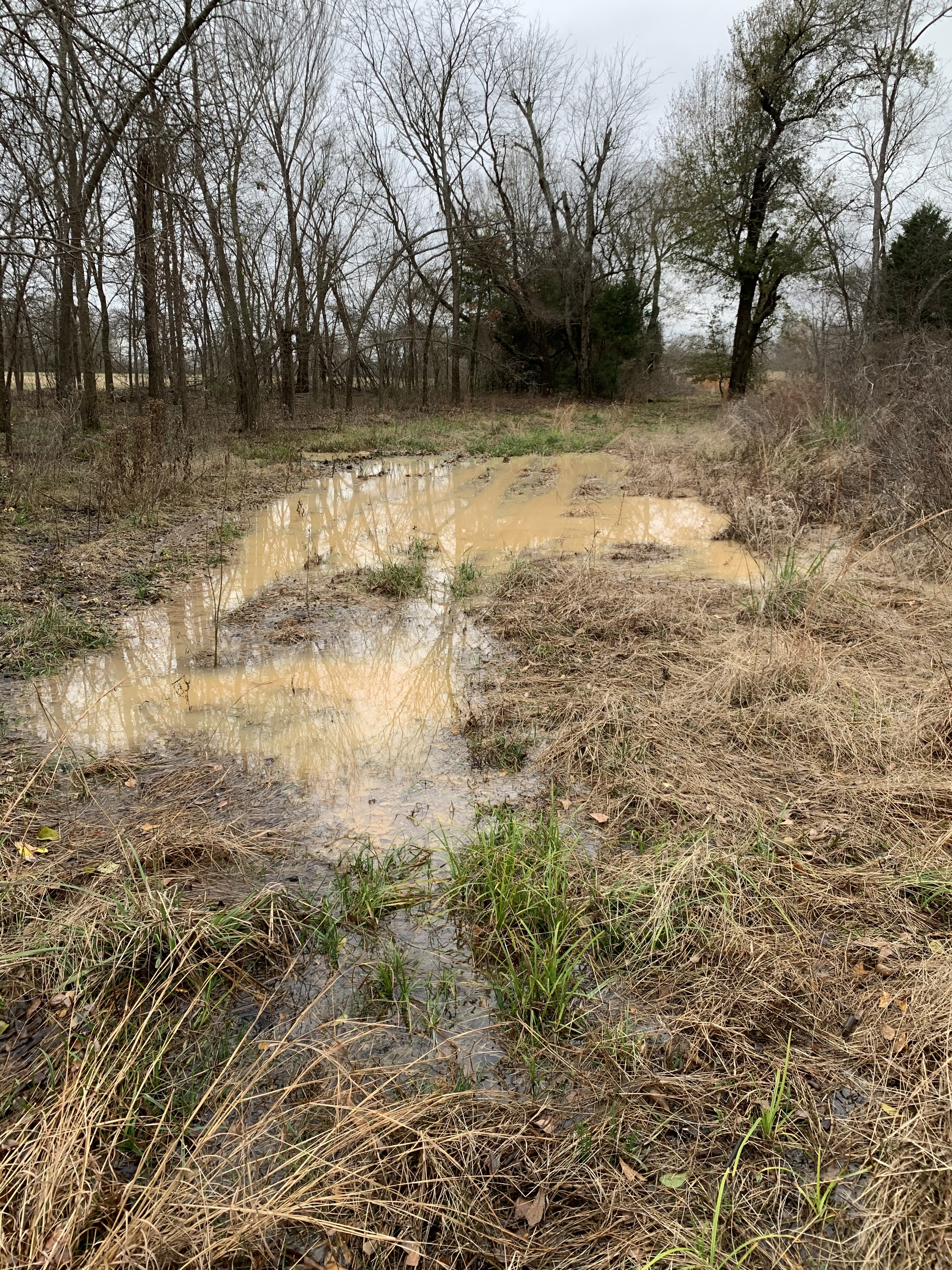

Best way to make a 4 season trail through this low spot
   / Best way to make a 4 season trail through this low spot #11
Looks like you could put a culvert in where you marked on photo and then fill in approach on each side of it.
Make culvert twice as big as you think you need.
   / Best way to make a 4 season trail through this low spot #12

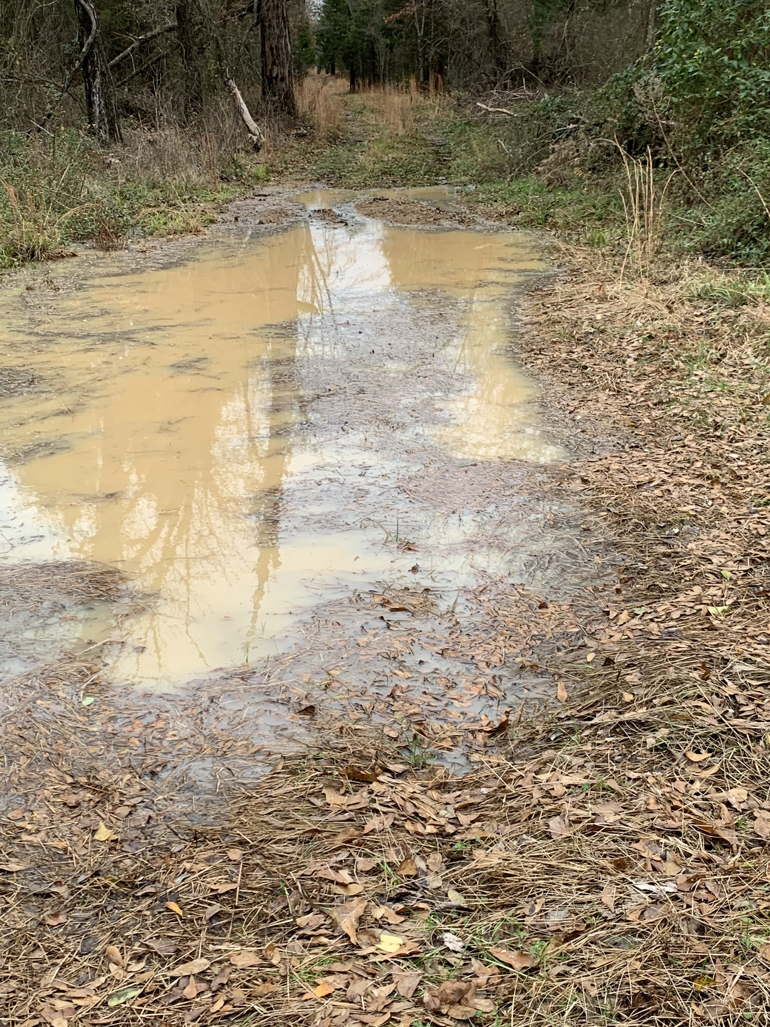

I have 2 areas like yours, but I have about 6 months in the dry. I have done the same brainstorming as you. Lately, I have been think of sinking 2 7/8 drill stem into concrete about one every 8 feet. Then welding drill stem on top, elevated above the waterline. Kinda-like the top rail of a pipe fence. And then I would have a piece of drill stem, like a rib every 8 feet. One on each side. The only thing I can’t figure out is what I will use to put between the two rails that I can drive on. Heavy gauge sheet metal would be too expensive (I expect). Maybe I could weld drill stem side by side lengthwise. My expanse is only about 50 feet on one road and 6 feet on the other. Below are pics of each.

I don't understand the picture and marking at all. How about a textile to support the road?
I had a similar problem and thought wood chips, seriously under-estimating the number of trees and WORK involved in chipping them.
   / Best way to make a 4 season trail through this low spot #14
Wood chips in my wet climate turned to mush in a few months.
Bruce
   / Best way to make a 4 season trail through this low spot #15
You could cut it down several inches, lay down highway fabric and cover with 4-6" of gravel.
Even with water laying on it you would be able to traverse it then, with light loads.
   / Best way to make a 4 season trail through this low spot #16
I would use fabric with gravel on top. I think it's called geotextile road fabric. I would remove the topsoil down maybe 6" and then put the fabric down and fill with gravel to the same height as the surrounding soil.
   / Best way to make a 4 season trail through this low spot #17
Good post. The only thing I disagree with is disturbing the soil surface. Unless there's objects which will puncture the fabric he's better off laying it on the undisturbed soil, then graveling over the top. Elevating the road surface lets the water run off, rather than soaking in and turning the gravel to mud.
   / Best way to make a 4 season trail through this low spot #18
The only reason for removing soil was to not create a dam that any water had to cross. If flush with the rest of the field then nothing else should be needed.
