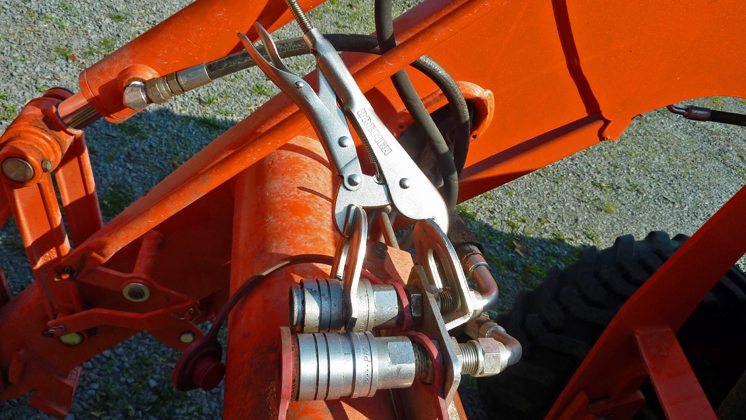

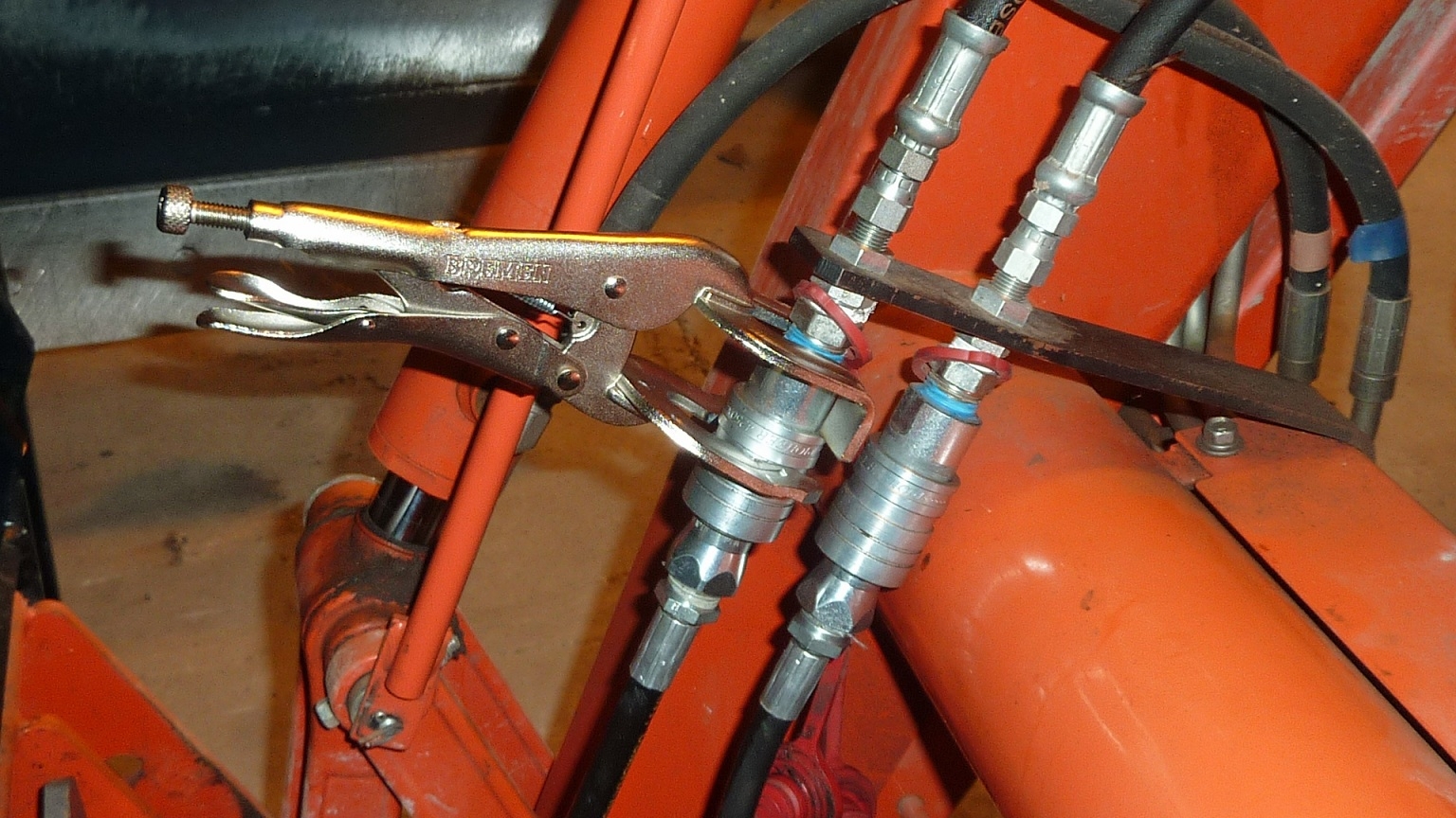

The loader cross tube mounting brackets that came with the W&R Long 3rd function valves work fine on my Kubota L6060 and MX5800:
One vertical, the other horizontal. Both are at a convenient height for making hose connections. The vice grips are a tool I made for opening the connectors.

The handy vice grip tool fabbed by bdhsfz6 is quite interesting, and some more detail would be appreciated, if possible.
   / Best way to mount hydralic hookups for grapple #24
Looks like Vice Grip welding pliers, probably modified to just fit over the OD of the coupler.
   / Best way to mount hydralic hookups for grapple #25
See post #6 in this thread:
   / Best way to mount hydralic hookups for grapple #26
Correct.
Just a little work with an angle grinder opens the jaw enough to fit the notch in the coupler barrel:

The breakaway couplers have the sleeve fixed, and as the body moves it releases. This means that you can push or pull on the hose to connect or disconnect.

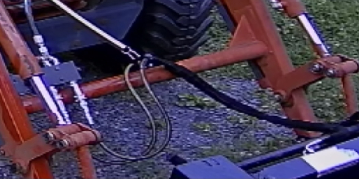

   / Best way to mount hydralic hookups for grapple #29

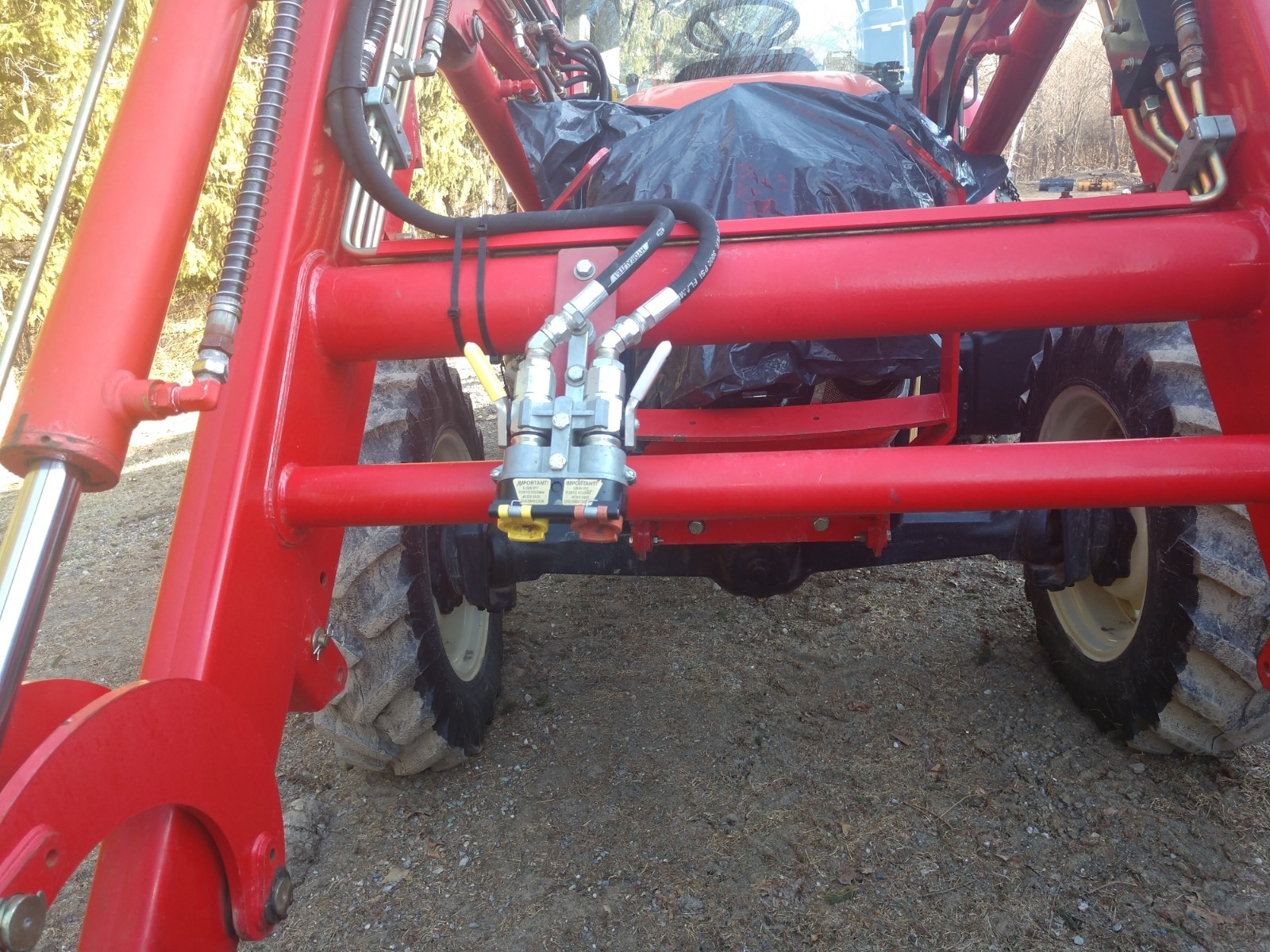

Anyone have suggestions for how to best mount these on the loader? PN for a plate or other idea? Which direction is best?
Thanks!
I mounted a check-block in the gusset stiffener of my loader with disconnects directly below. I have a 25" spring to manage any hydraulic hose movement from the curling function. Waiting on my supply hoses.
