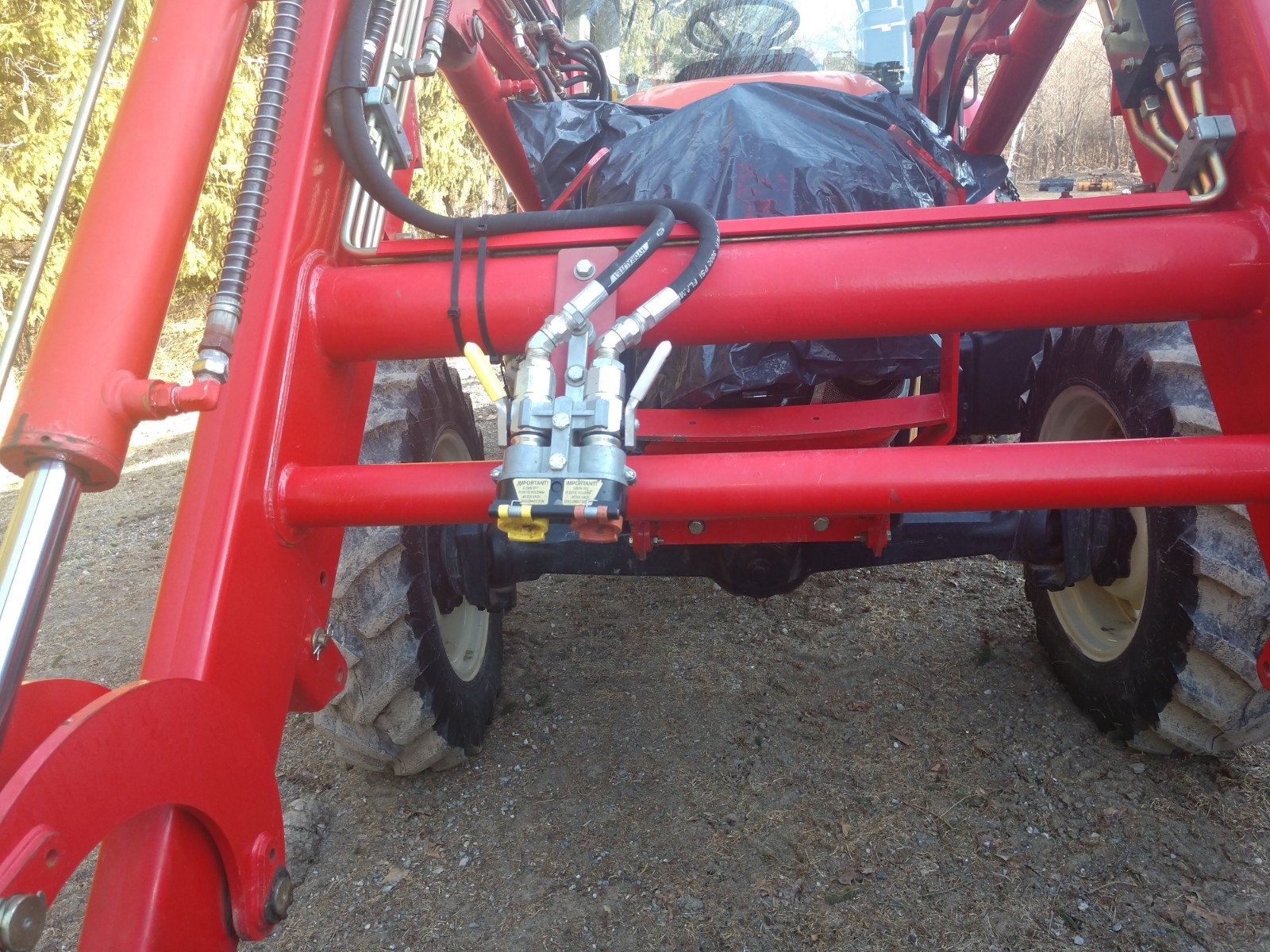

Mine is set up a bit different, it can be a pain at times;
If I was to redo it I'd be tempted to mount it sideways.
For dirt contamination/spillage while using the loader? I thought about that and may change up.
   / Best way to mount hydralic hookups for grapple #32
Sideways to make it easier to reach and push in to latch, that has the spring loaded flaps to keep most of the dirt out when not in use. But, I still grab a can of brake clean or WD when I'm going to use them, spray and wipe out and off.
