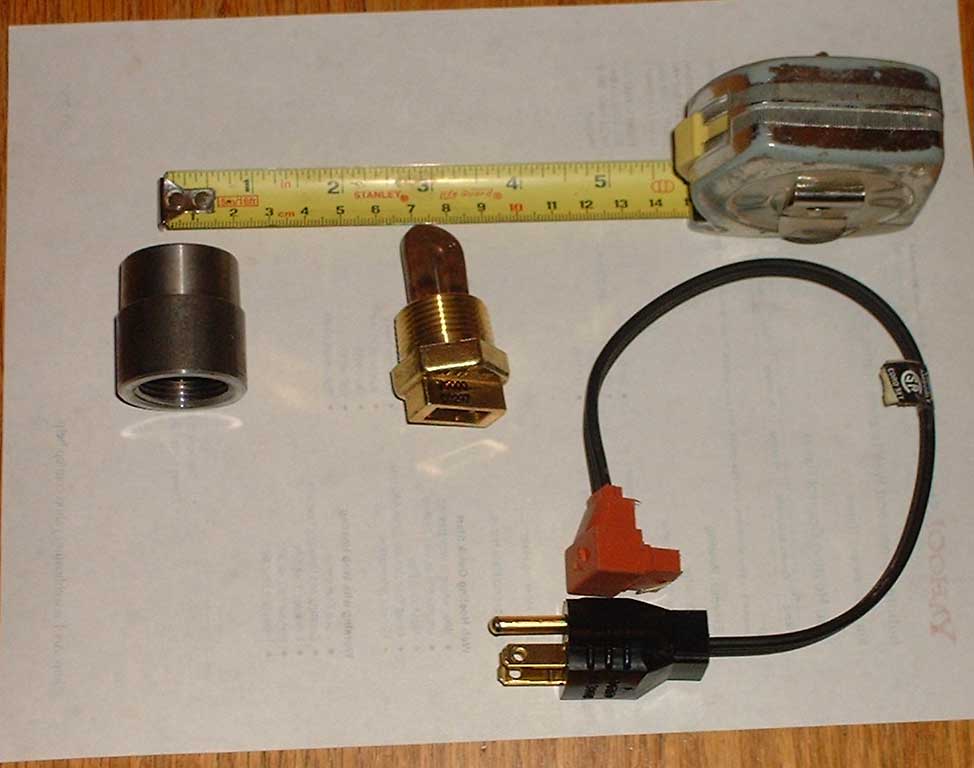

DLMaine01, Does the B Heater have a rubber seal around it ?? If so, I would only use antifreeze on it.
If it has a center nut to tighten it into to hole ?? maybe they want locktite on that?
Ronald
   / Best way to remove freeze plug?
#12
No rubber seal here, see attached pic. Directions say "Loctite should be used to help seal adapter bushing into the block. Teflon tape should be used on heating element threads".
Pretty specific directions I was just wondering how it worked in the real world.
Thanks
Dave
   / Best way to remove freeze plug? #13
DlMaine01, I see said the blind man.
Get the old freeze plug removed with out marking the sealing area....provide a CLEAN and dry surface for the loctite coated adapter.
Be sure to have it straight , use a hammer big enough to make it move [dont tap on it..soft metal]
Teflon tape the threads is correct.
Ronald

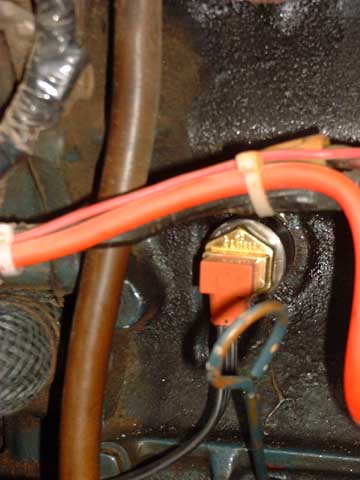

Update on the freeze plug. I was not able to get the freeze plug to turn inside it's hole. The side I tried to drive back moved about 1/8" and stopped. So I tried the other side and was able to rock it back and forth a very little bit. After a quick consult with local wise old farmer it was decided to drill a small hole in the plug to insert a screw to remove it. It worked! Turns out the plug was inserted into the hole farther than it needed to be and the water jacket is quite thin in this area. Another thing I discovered after I got the plug out was I was not the first person to use this method on this tractor. And while I drilled with extreme caution the last person had not. That is what the dark spot in the middle of the plug hole in the pic is, a drill bit gone a little to far!
The heater sleeve went in fine and left plenty of room for coolant flow.

After the block heater was in I measured again and there was no way it would have fit behind the starter so I guess this is the best spot for it. Best of all no leaks! /forums/images/graemlins/grin.gif
Now on to bigger and better things like the hyd. remotes.
Dave
