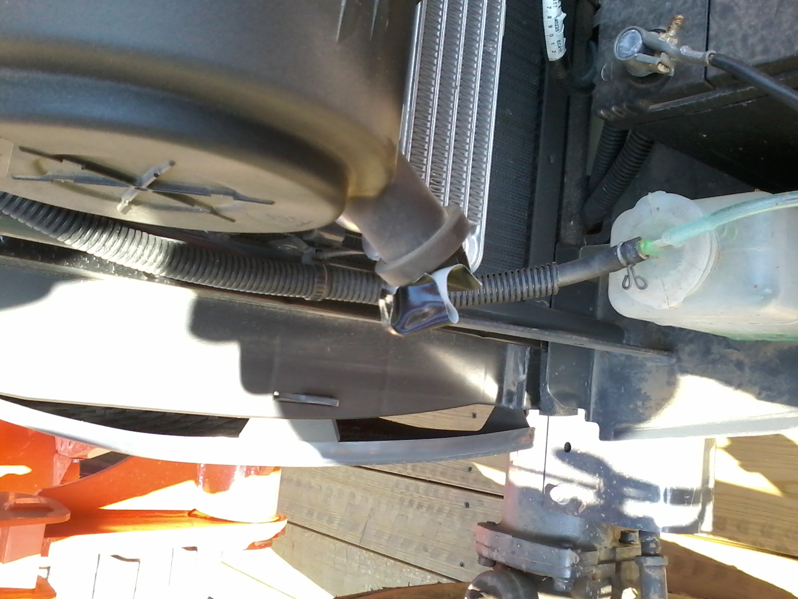

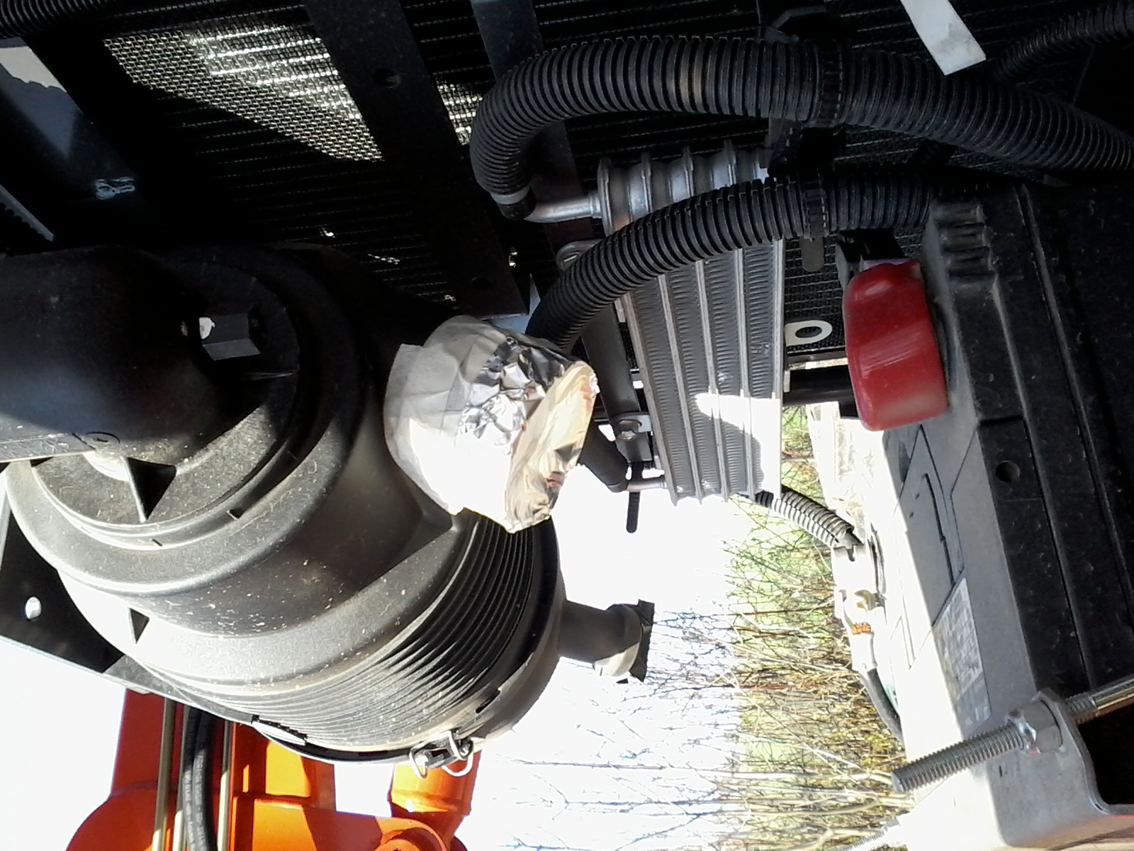

Hauled the tractor today. I taped aluminum foil over the intake and dimpled it in some. Also taped evacuator valve shut so all air, if any would go to aluminum foil and push it outward, thus showing air flow in exhaust, through turbo, and out valves and intke. I checked after I got to job (13 miles away at 55 mph), and found that the aluminum foil lookd the same as before I left.

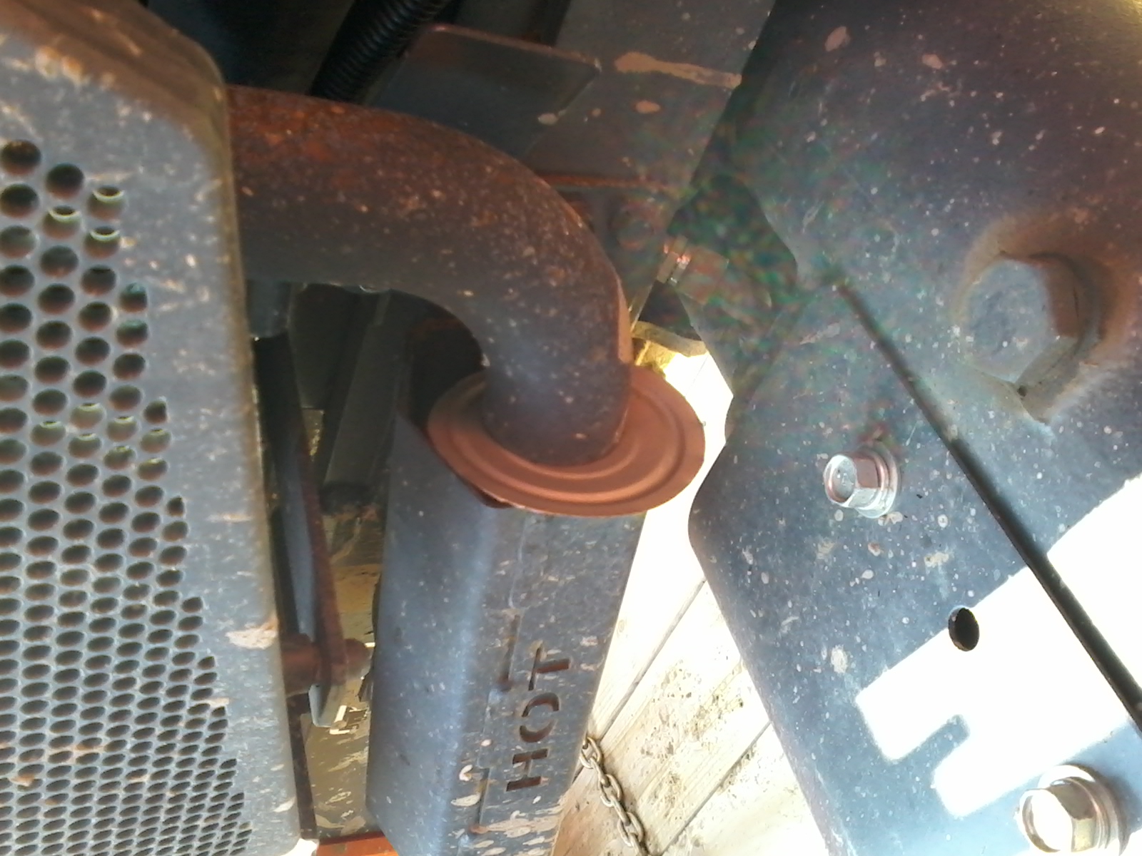

After thinking more of the tin can cover idea to cheat if the exhaust was still hot, but I wanted to cover pipe and go, here is what I came up with.
Not the can, but just the thin disk lid to a can. On a mx 5200 it wedges perfectly inbetween the exhaust pipe end and the heat sheild. Quick and simple. Just have to watch I dont get cut!
