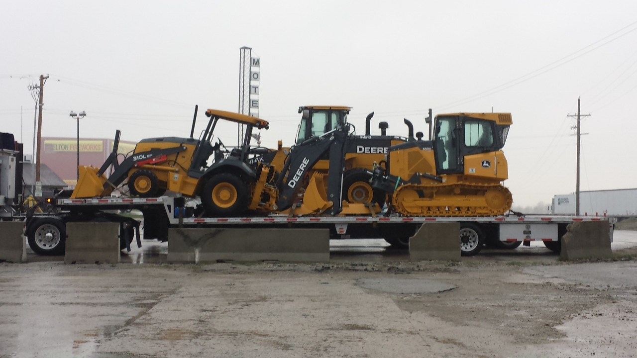

I see loads like this every day that I spend on or near Interstate Hiway 35. :)
