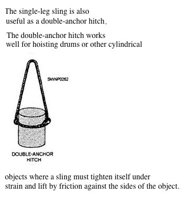

Nine feet long means you wrap the sling just about 4'6" from one end. The taper should put the center of gravity just below the sling. Either use the bucket or fork plate for the lift which could be only 6 feet...Your wife can guide the pole into the hole once you get the right spot for the sling/choker.
   / Best way to vertically lift phone poles for fence #30
That's not what I found when setting power poles. Hooking a pole as you suggest would make the pole want to hang much closer to horizontal rather than vertical. Best is to hook as close to the snipe as possible while still being able to raise it high enough to get the butt into the hole.

If its a 9 foot pole, you only have to lift it slightly over center, in this case, a tad over 4.5'. Gravity will tip the heavy end down. Sure you can lift it higher on the pole and it will hang straighter, but generally, only a bit over centered will do the trick. You can maneuver the butt end into the hole and work it in with gravity and wiggles of the loader controls.

Granted my tractor is a little bigger but I just used the front bucket. I have a large flat rock that's about 4' tall that I placed the end of the pole I wanted to be the top of the post. I drove up to the post with the front bucked into the dump position (both top and bottom of the bucket touching the pole) and chained the pole on both top and bottom of the bucket. I could get about 3' up from the bottom. The edge of the bucket kept the pole from slipping as I used the curl function to raise the pole into the vertical position. I have a 55 gallon drum filled with cement for the 3pt as a counter weight but they stood right up. It worked fine for both rail road ties and power poles that were 10' long. My friend had an auger on his 3pt and I was following behind him dropping the posts into the holes.

I used one of the first ideas...choked chains just above 3 foot mark and at top of fork back (or whatever you call it) and then set the pole with 6 feet above ground all by my lonesome.. worked great. These are very large diameter heavy treated poles, much too heavy for 2 men. Was at the top end of the capacity for lift with my 7800. Thanks to all who chimed in, Hal
