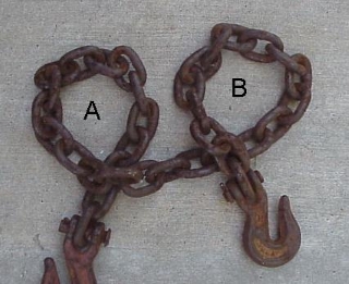

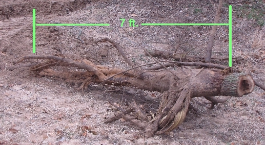

Cut the shrub off and drop a clove hitch knot over the stump. To do, form 2 loops with a counter clockwise motion, place loop A on top of loop B and drop this over the stump and you have a clove hitch knot, or tie the knot the more difficult way shown in the scout book and on the net. With a long chain and short chains you can pull as many as desired at one setting. It just depends on how many short chains you have. If you will keep the knot's 2 loops together as you slip it off the shrub you pulled you don't have to tie it again for the next.
