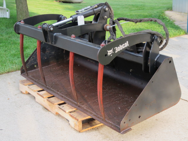

I wish I had this grapple years ago.........hand loading and unloading brush from trailers is a drag.
