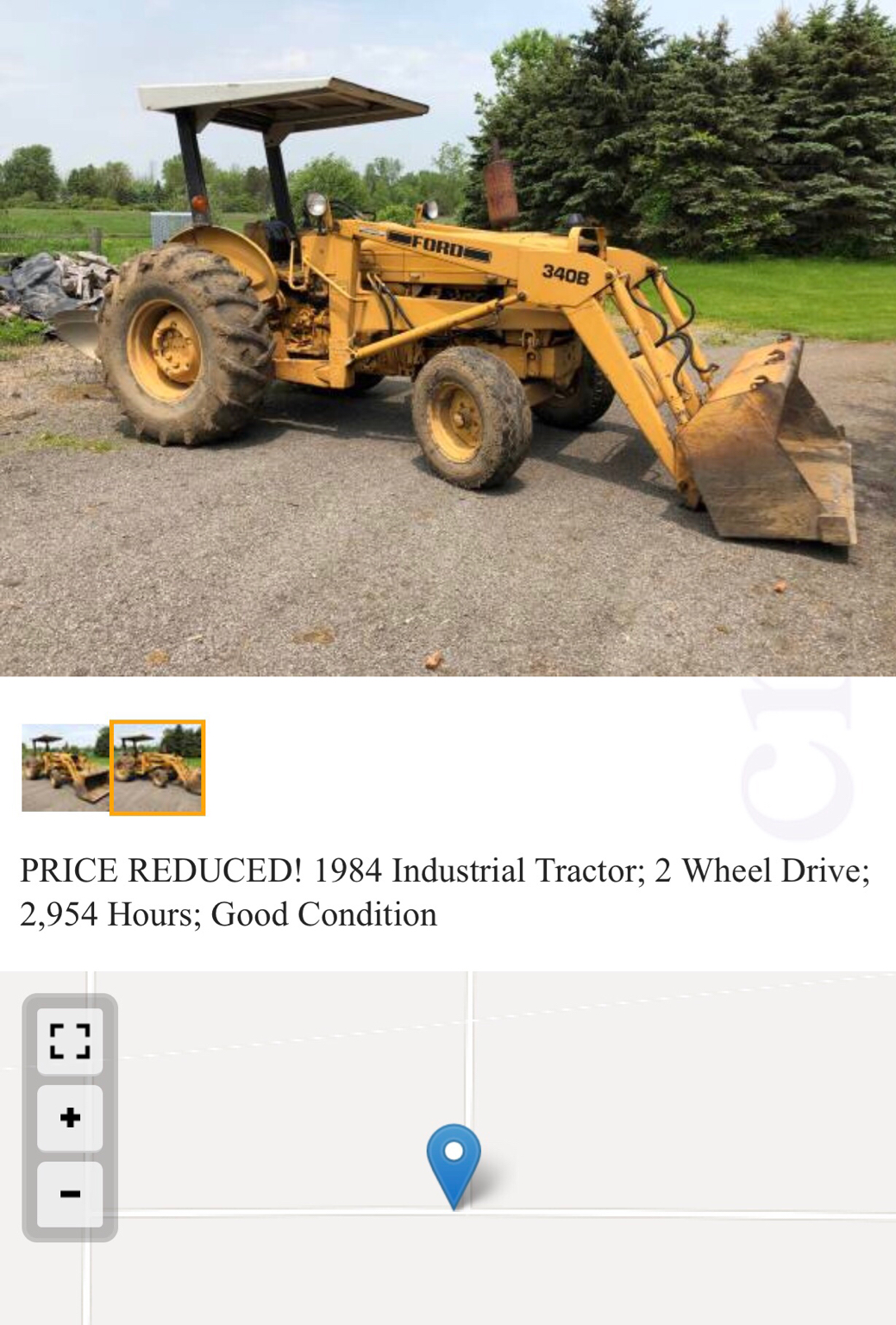

One reason I had my eye on the 340B was because it’s just as strong as my 4320, stronger than many other physically larger machines and I can buy one for 6-8k range. I also wanted a tractor that sat lower for stability reasons since I’m not working fields with it.
It doesn’t have to be a 340B, that tractor just fit what I was looking for.
• Power steering.
• Synchronized transmission
• powerful yet fast loader
• heavy for the size which helps the 2wd loader work
• open station, I don’t want another cabbed tractor. My personal opinion, older cabs aren’t that nice anyway.
They also made a 540B, similar size, just more HP. But I can’t find one within 150miles of me lol.

There is a 340 for sale on FB or CL for $6,000 right now, they are quite rare and weren’t made very long. But they had many problems, I would be going after the 340B tractors. There is a couple for sale right now within 60 miles to Columbus around 7k
They made that tractor with a cab, the cab TLB would prob weigh a lot but it’s really hard to believe the weights Tractor data posted. I can’t see the loader being more than 1500lbs. The Ford 4400’s loader is 1495lbs and it’s around the same size tractor just older.
They also made a 540, 540A & 540B. Same wights posted for those on tractor data.

This was the only one that meets the guidelines (no cab), but has more hours then I like. 2955
The only way it fits in my barn is I have to take off the rops. They are 91” tall, my door is only 84in tall.
