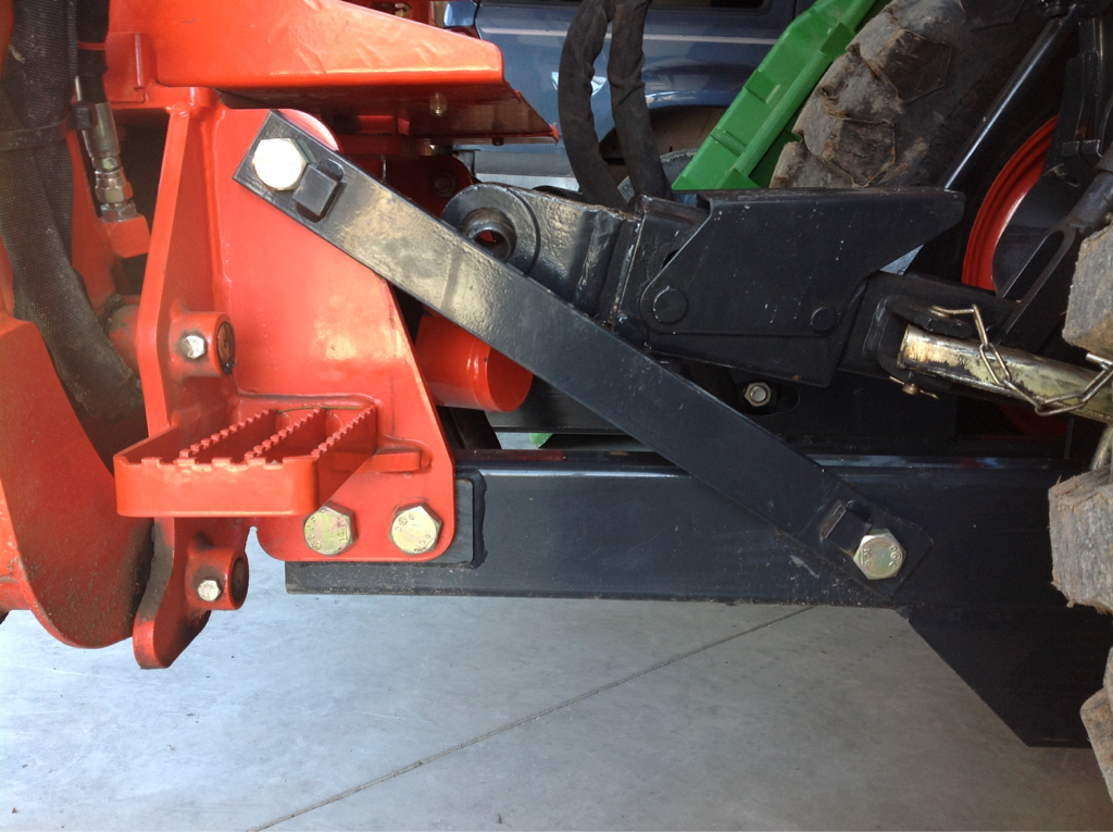

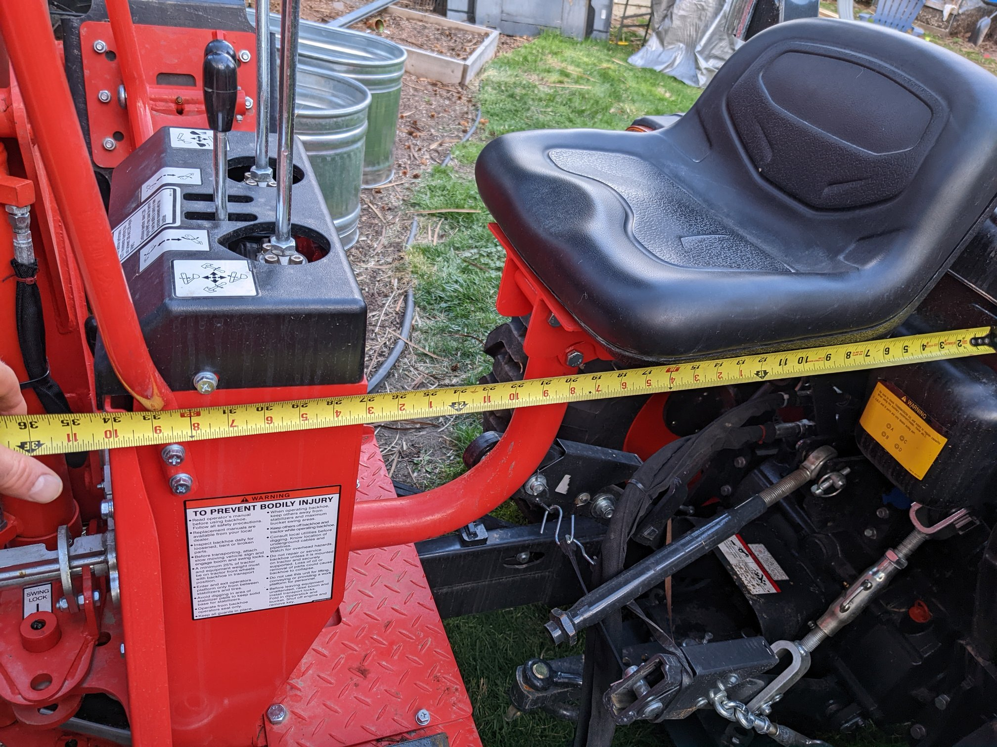

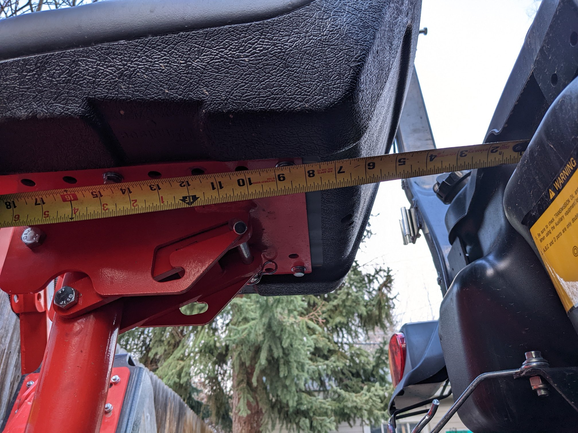

I took some measurements for ya last night, orange.
As i found it (nothing on ssqa, front loader on floor) parked in my garage that has a pretty decently flat concrete floor - 11.25" under the backhoe kingpin. It looked like my rear tires were well on the concrete about 52" forward of there. = ~12 degrees departure angle.
I grabbed a nearly full bucket of moist dirt and measured again, had about 12" under the kingpin now. = 13 degrees.
I measured about 4 to 4.5" clearance between my backhoe seat and the fuel tank cap. Could definitely fix that and have the whole backhoe be about 6-8" closer to the machine. But you know what? That would only improve your departure angle to about 14 degrees. Is it worth it? Probably not.
I forgot to check my rear tire pressure but I think they are at around 25 psi. What are yours at, by the way?
But then I went out and dug some small tree root balls that are in the way of a new project. In practice on my land, I've never gotten stuck from the rear angle. Maybe it drags the dirt here and there, no big deal. Only matters when loading a steep trailer on pavement, I suppose.

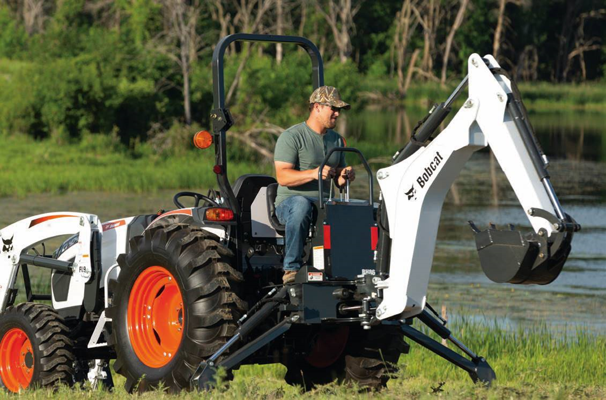

Bobcat does not use the Kioti backhoe or loader.

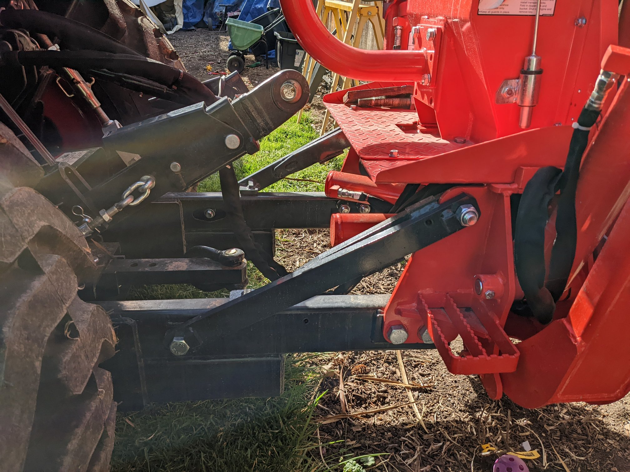

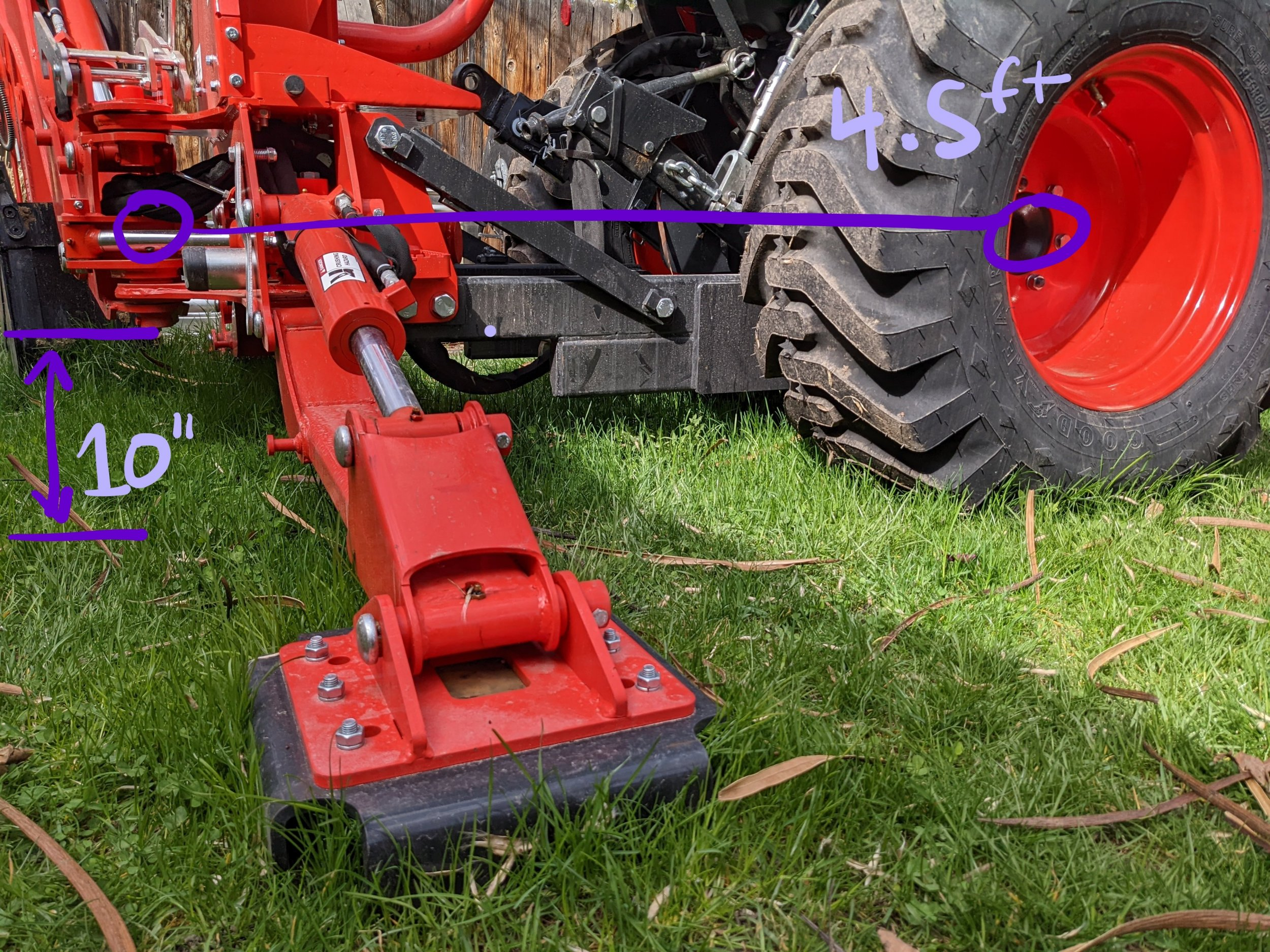

Amvcane (sans the @mention...) confirmed (before deleting his post & pic above) that his 2012 CK3510se-hst, with kb2475 (no 'L') also has ~10" ground clearance to the kingpin, and that his kingpin is ~46" aft of the rear axles.
it is interesting that both deezler and amvcane have a ck3510, but while the pics are from different angles, amvcane's subframe SURE looks further forward in the pics: (below is amvcane's)
but this DOES match with the numbers you both reported:
  • amvcane kb2475 (no L) is 46 inches axle->kingpin
  • deezler's kb2475L is 52 inches
  • my kb2475L from a few years later is 54 inches
Next year, it will be 6 feet! :)
(Obviously I have a completely different SUBframe part - but the specs on the ck2610 and ck3510se (at least per Kioti.com April 2022) are identical in the relevant matters: same wheelbase (should be identical frame), both use 15-19.5 rear industrial tires.)
Thanks, and greatly appreciate the measurements.
It's odd that you and avmcane have different distances axle->kingpin. Kioti keeps making it longer.
BTW, I read ~100psi on my rears (might be a tad high; i was trying to prevent beet juice from running into my gauge).
That's interesting - I know that kioti makes some bobcat; not sure if that is "all" of the CK's (yes?), and if they are 1-to-1's (eg, is the bobcat you show exactly a ck2610, ck3510, etc).
do you have a model for the hoe shown? Would be curious to see how it mounts / specs / cost. Perhaps if the dealer can't get me something remotely close the advertised specs, I'll return or sell it and look at the bobcat branded hoe?

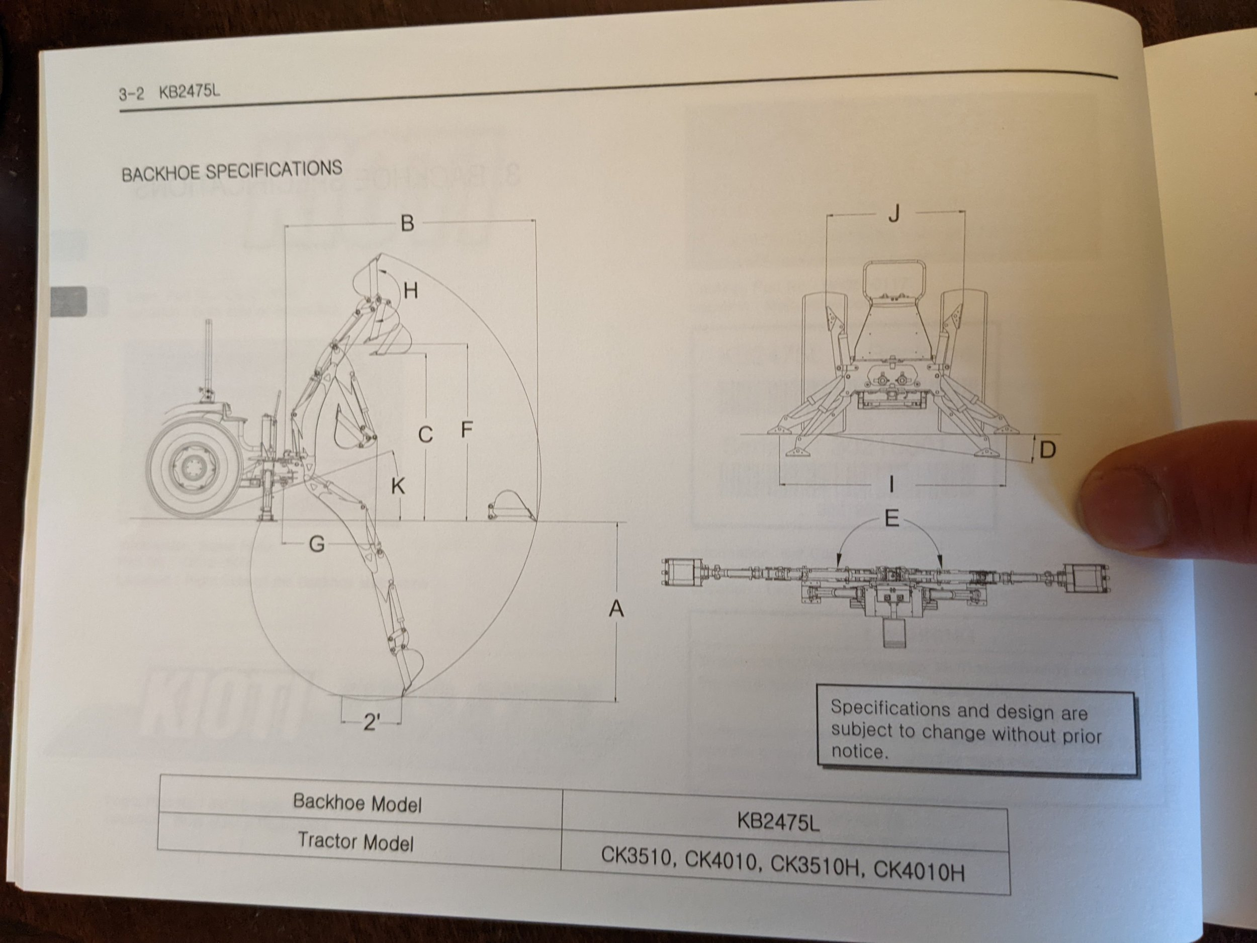

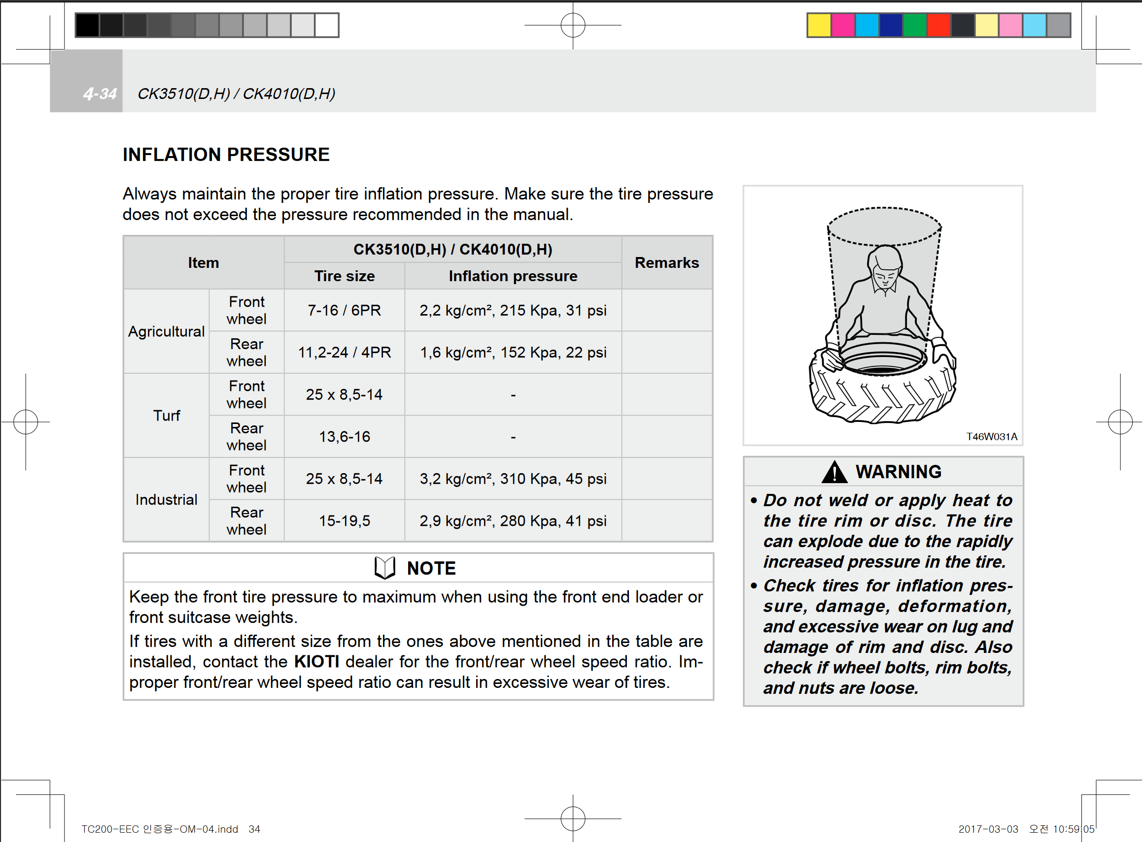

Thats too high. My OM shows 41psi max for the 35 and 40. Can't imagine it being any different for the 26. Mine are loaded and set to 35psi (maybe 30, forget). Not as low as deezler's, but I'm running R14's which require a few more pounds.
  • Screenshot 2022-04-21 at 14-51-37 CK3510(D H)_CK4010(D H))-OM-ALL-161220.pdf.png

My DK 35, I run 40 PSI in the front tires and 15 psi in the loaded rears
Thanks. Yeah, it sounds quite high. With all going on, i forgot to check it since I had CommercialTire fill all four tires with beet juice. Guess they juiced the pressure up to tractor-trailer levels ...
Thankfully it hasn't got hot yet, I'll get it lowered to 40.

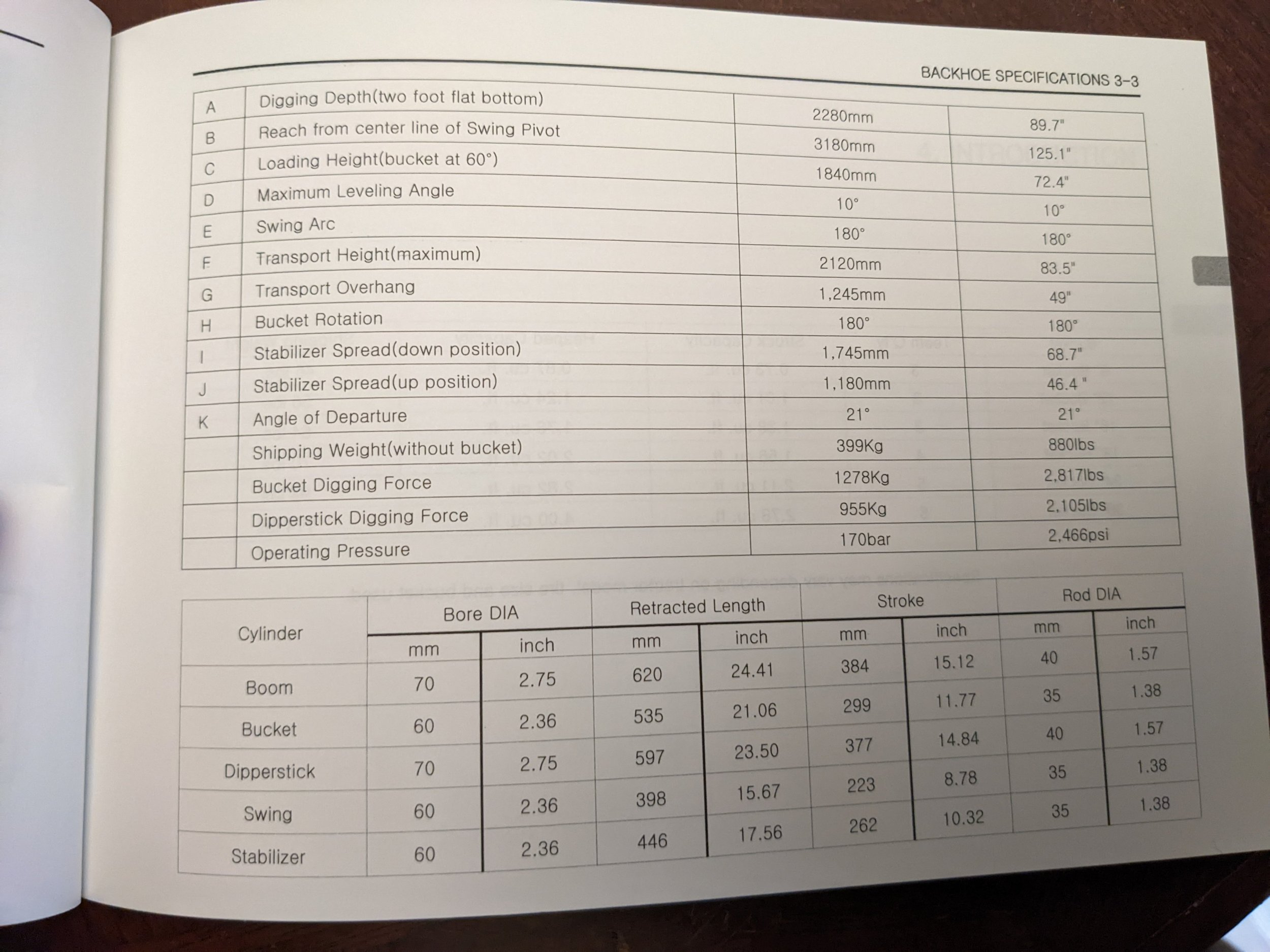

dealer says they've contacted Kioti, but the frame i have looks like the others they've installed.
Assuming Kioti comes back as expected and says "good to go!" ... not sure what my options are, even though kioti advertises 21 degrees.
I don't mind giving up 4 inches of dig depth (cutting off the end of the subframe, and bracing / re-welding it up _and_ forward 4 inches each direction) - but besides the fact this will be a PITA, I clearly can't modify the unit and keep it's warranty (so that hack is 5 years out). I suppose I could sell it private party for what i paid (they are backordered, and have increased in price) - but that would leave me with no hoe, and having to find an aftermarket one.

I have the Bobcat Ct2025 with the backhoe.
On my bobcat the Kingpin measures about 48" from the center of the rear axle, and the pin is 13.5" from the ground. So based on you guys, 3.5" higher but about the same distance back.
I have not hit anything on the kingpin yet, but depending on the angle I have drug the bucket. So I learned that if I'm loading into the dump trailer or a steep angle, all I have to do is shift the backhoe arm to the side or lift the bucket to clear. But getting into the dump trailer is pretty steep, it'll drag the brush mower too if I don't park the trailer in a good spot.
