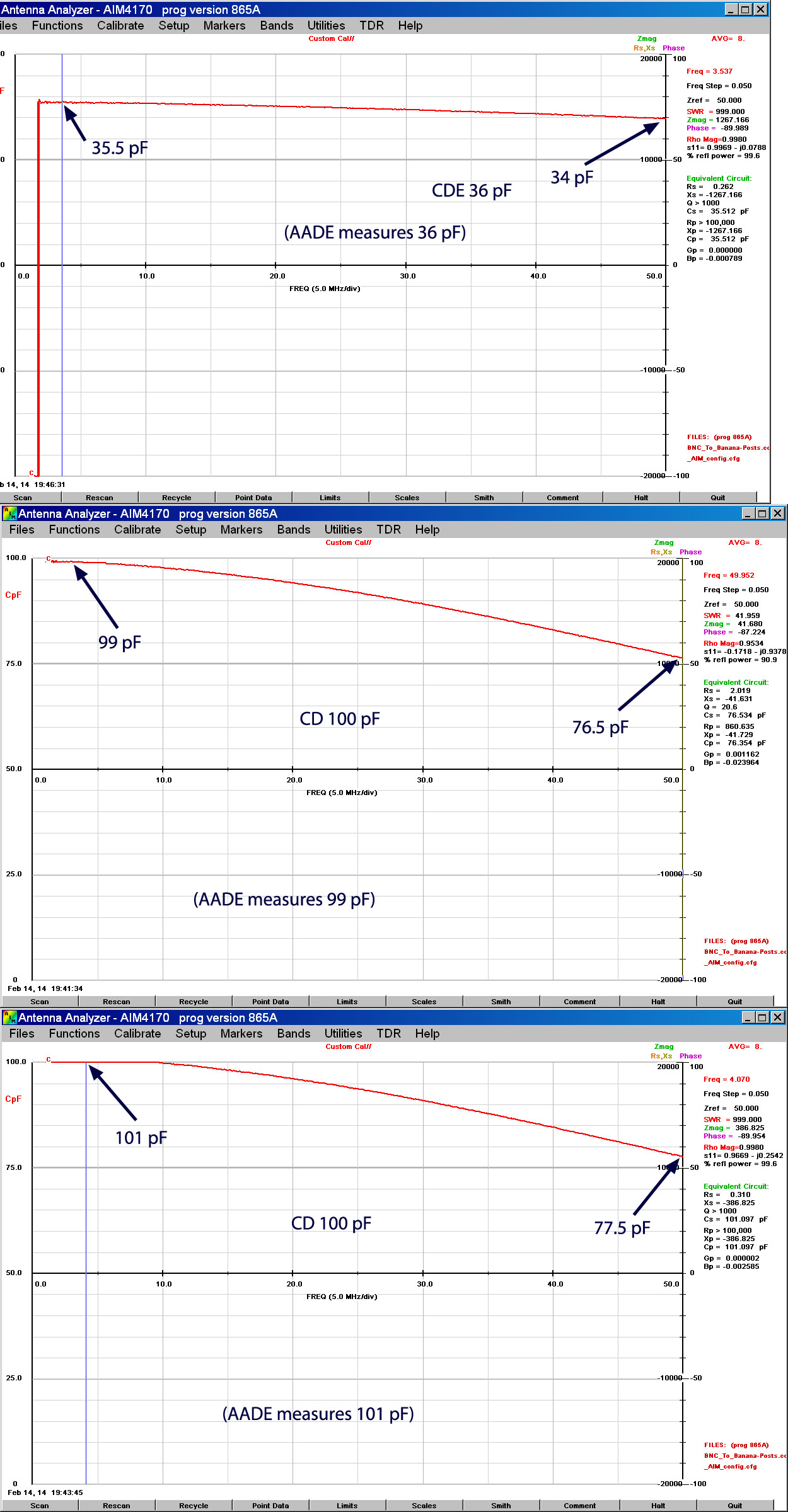

Some time ago for giggles I tested on a VNA how the capacitance of a capacitor changes with frequency. A lot of folks think when they shunt or bypass a DC line with, say, a 10 uF cap, that it will be 10 uF from DC to daylight. That is not always true. I was even testing expensive RF chip caps made for transmitting applications and saw changes starting even down at low frequencies.
I did this as I was designing a LPF for a 1 kW RF amplifier for our 6m amatuer band and the prototype I built did not match the predicted performance curves I was expecting based on modeling. Anyway, some tests on the VNA showed my why.....it was fascinating and eye opening, even to an RF engineer. Not all caps are made the same. Lets see if I can get a plot below of several caps I tested that show the fall off of capacitance as the frequency is increased. Believe it or not (SOME) Silver Mica caps were better then very expensive chip caps made for transmitting applications.
