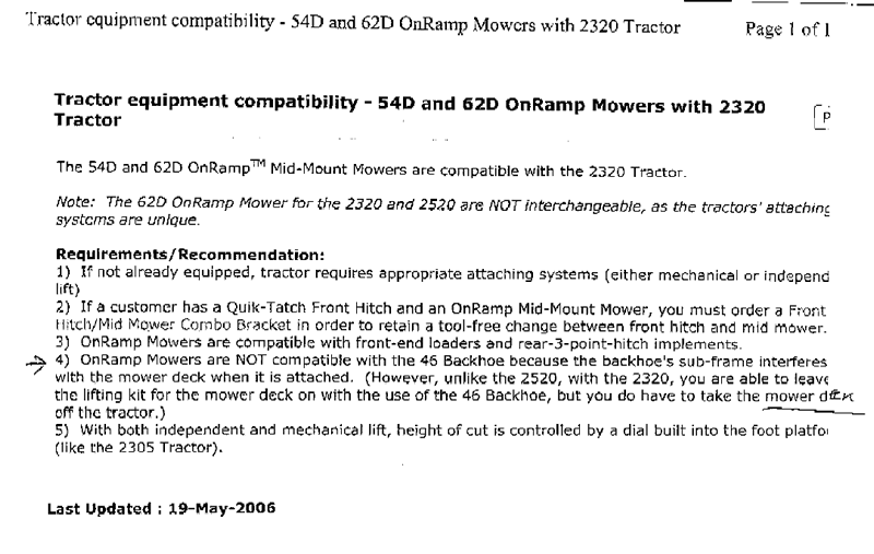

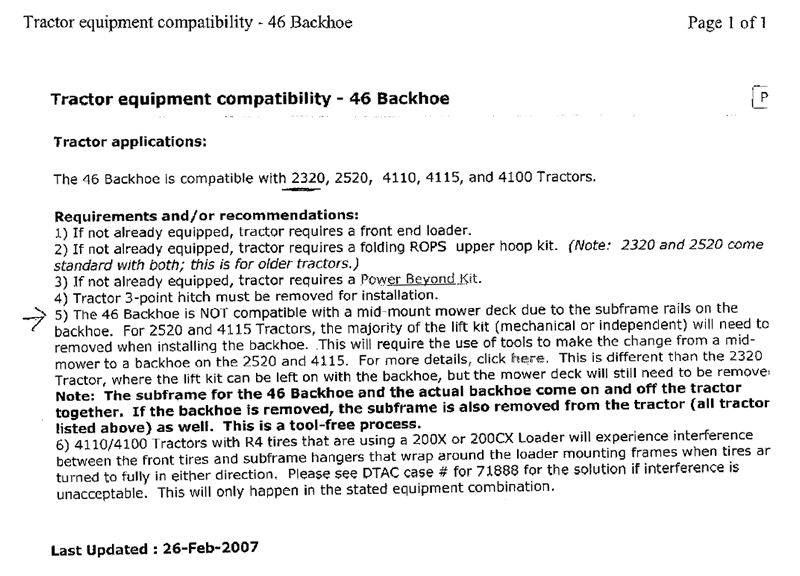

Thanks for all of the very useful information and suggestions. It seems that the dilemma is getting shifted to money: if I could afford the tractor plus all of the attachments, I would be set. Currently my dealer is quoting me $24K for the 2030 tractor, 200cx loader, 46 bh, 54D MMM, 5' box blade and 4' rotary cutter. That is a whole pile of cash.
A follow-up question on the attaching and removal of the backhoe: how long an operation is this? Since I am planning to use this tractor as the primary mower, but will have frequent dig jobs as well, I would have to do the swap quite often.

It's not horrible, I'm guessing the 2320 is pretty close to my 2520. Removing the 3PH I do at a slow pace in about 10-15 minutes - I could probably do it under 5 if I hurried. Removing the mower deck with the On-Ramp is probably about 5 minutes. Removing the mower deck mounting brackets (if required) is an unknown to me as of now. Mounting the backhoe may be another 15-20 minutes (I've only had to mount it once after I unmounted the dealer install). I'm guessing I can go from lawnmower to backhoe in under an hour once I figure out the cylinder removal. Of course, you may want to set aside a weekend for the first time you do this :)
If you have to do this frequently you may want to consider evaluating the cost of the mower deck with the cost of a standalone riding mower/ZTR. The MMM is probably the most troublesome attachment since it affects the backhoe and the ground clearance.

My dealer helped me dig up the "official word" on the subject. I am attaching the relevant info from JD for the benefit of all.
Thanks to all who helped me figure this out!

Fantastic, this really clears things up. I am debating 2305 or 2320. I have not had a chance to play with a 2320 / 46BH, but did get to demo a 2305 / 260bh and really liked it. At first I was really excited about the drive-over deck on the 2320, but it sounds like the 2305 will be faster overall for going from dirt machine (FEL, BH) to mowing machine (MMM). Also, I think the 260bh will take up a lot less space in my garage than the 46 bh.
I wish they had an option to mount the 260bh on a 2320.
   / BH / mower question for 2320 #19
Sounds great as long as you understand what you give up in the process by going smaller. Deck gets removed regardless of the machine chosen (2305/2320) when the BH is attached.
