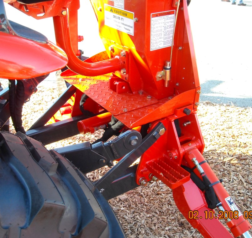

I have a CK30hst with KB2375 bh. I have never connected the top link. I let all the bh pressure be put into the sub frame as I believe it was designed to handle. If you're digging some hard stuff, the bh will flex a little putting the force on the rear bh mount on the tractor where the subframe is pinned to. I don't think the tractor's top link mount can handle this kind of force. My bh manual also never advised to connect the top link.

Nothing in the hoe manual, hunh?
The 2475 subframe depends on dual beams of about 4 inch height each,
positioned quite low. These will flex noticably when under loads from the
hoe. Flex is bad. Using the toplink will make a much stiffer attachment,
but the tension and compression forces on the toplink will be far far less
than on a 3-point hitch attachment where the lower support is free to
pivot.
Take a look at the better types of subframes out there. They flex much
less than the Kioti style subframe if you don't connect the toplink. The
Woods old style subframes are very similar to the Kioti style, and Woods
requires the toplink. The newer Woods style (4-point subframes) do not
require a toplink, and are a much improved design.

Seems to me like its time for Kioti to take responsibility for their design of their Backhoe and settle this question once and for all, Top link connected or top link not connected? Fred

If it wasn't supposed to be used why did they bother to put the tabs on the b'hoe frame for a top-link? :cool:
/ BH top link or not? #15
I think many tractor backhoes are setup to be sold as 3 point backhoes (my Rhino was that way and the subframe was an option, so it also has the tabs)

DK35vince you are right for sure Kioti BH are built to mount as 3ph or subframe that is why the top link is there.

It occurs to me that if using the BH as a 3PH setup than one would use the top link and when using as a sub-frame install then one would not need the top link. :thumbsup:

For the record,
KIOTI Tractors position is to NOT use the toplink on the Backhoe. The tabs are there, but KIOTI intends for the subframe to distribute the backhoe forces to the tractor without the top-link. We raised the question several years ago when the new 24XX series backhoes came out, and received a written response from KIOTI Techinical Department to not use the toplink.
Hope this helps
/ BH top link or not? #19
Thanks Michigan Iron, thats what I'm going with. Fred
