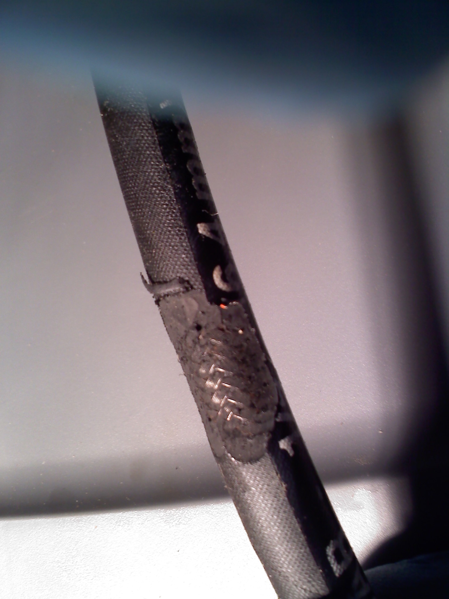

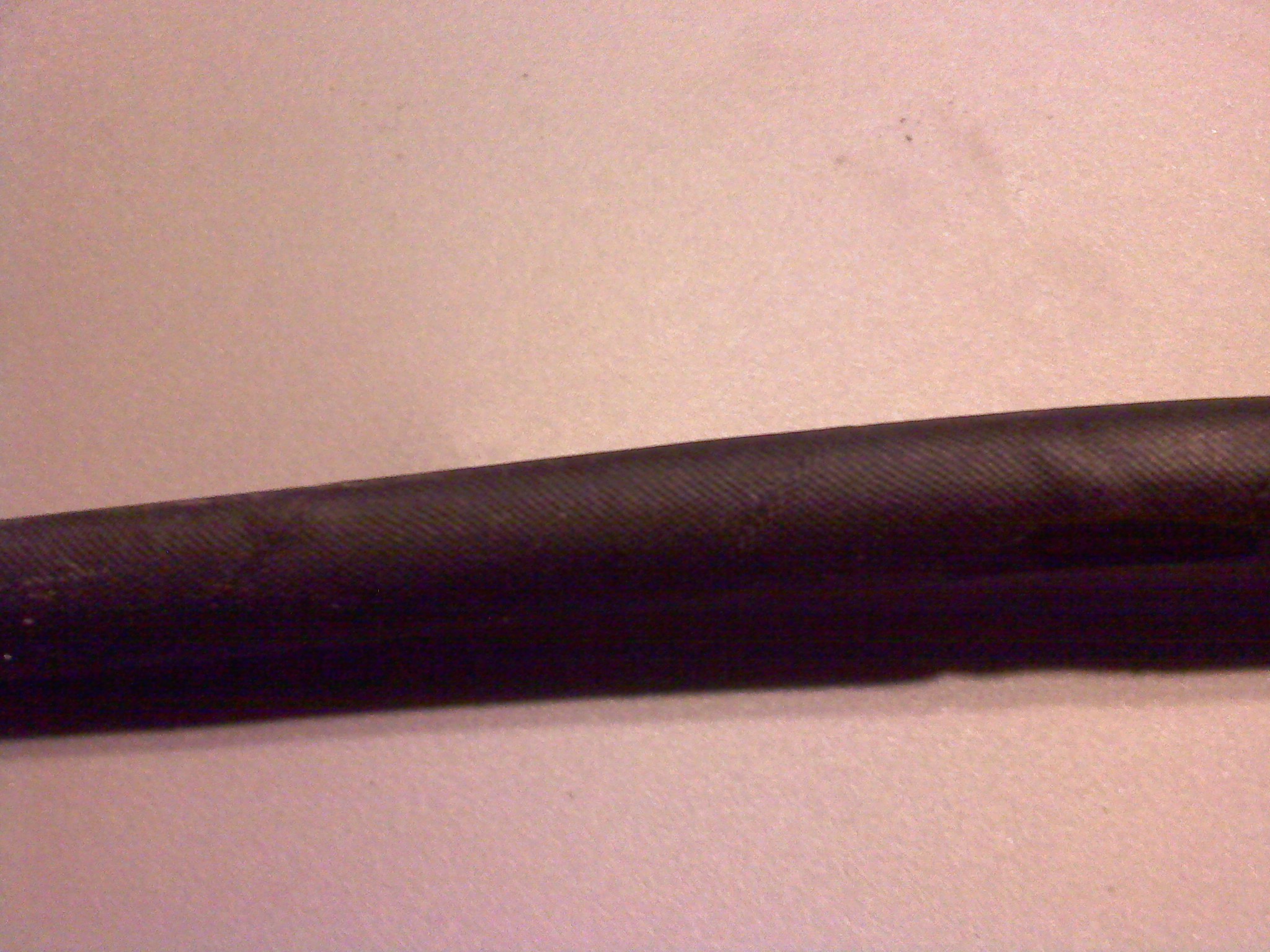

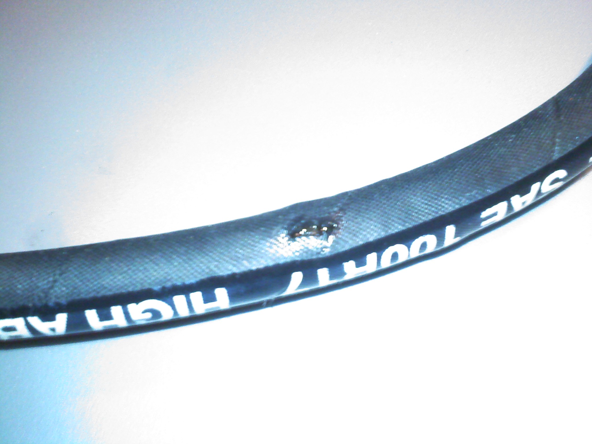

I decided to cut into the hose where they blew out to see what the steel reinforcement looked like - (pictures below) - it looked corroded to me, so then I cut open a part that was OK, it looked like normal shiny steel. Then I inspected the hoses carefully and noticed that there were some lumpy areas - so I cut these open as well - and found a bunch of rust under the rubber outer layer !
So the problem is not relief pressure - it is that in at least 2 circuits, there is corrosion inside the hose reinforcing steel, causing them to lose strength.

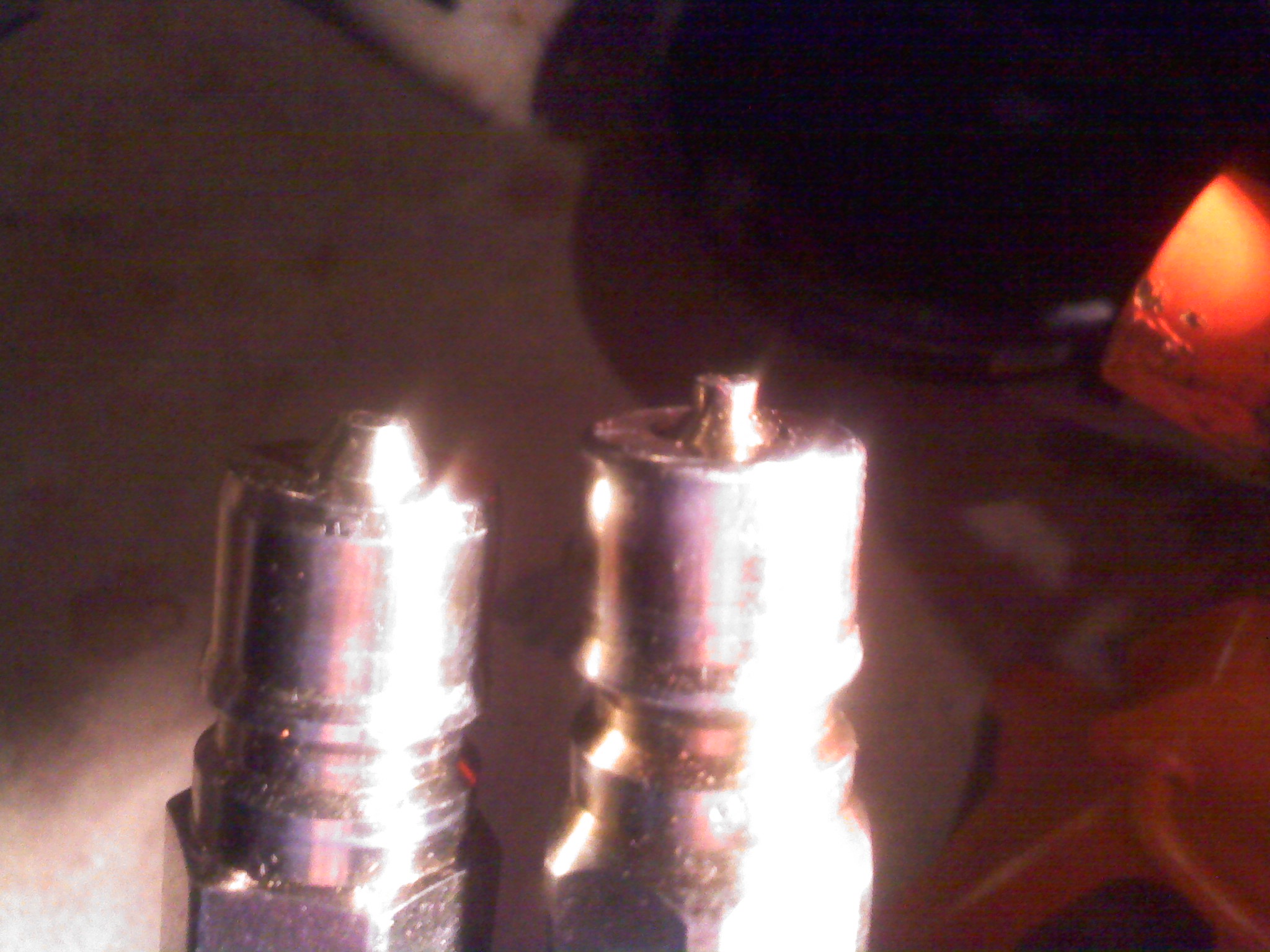

Also for anyone interested the differences in the QC tips - doesn't seem to be a problem...
