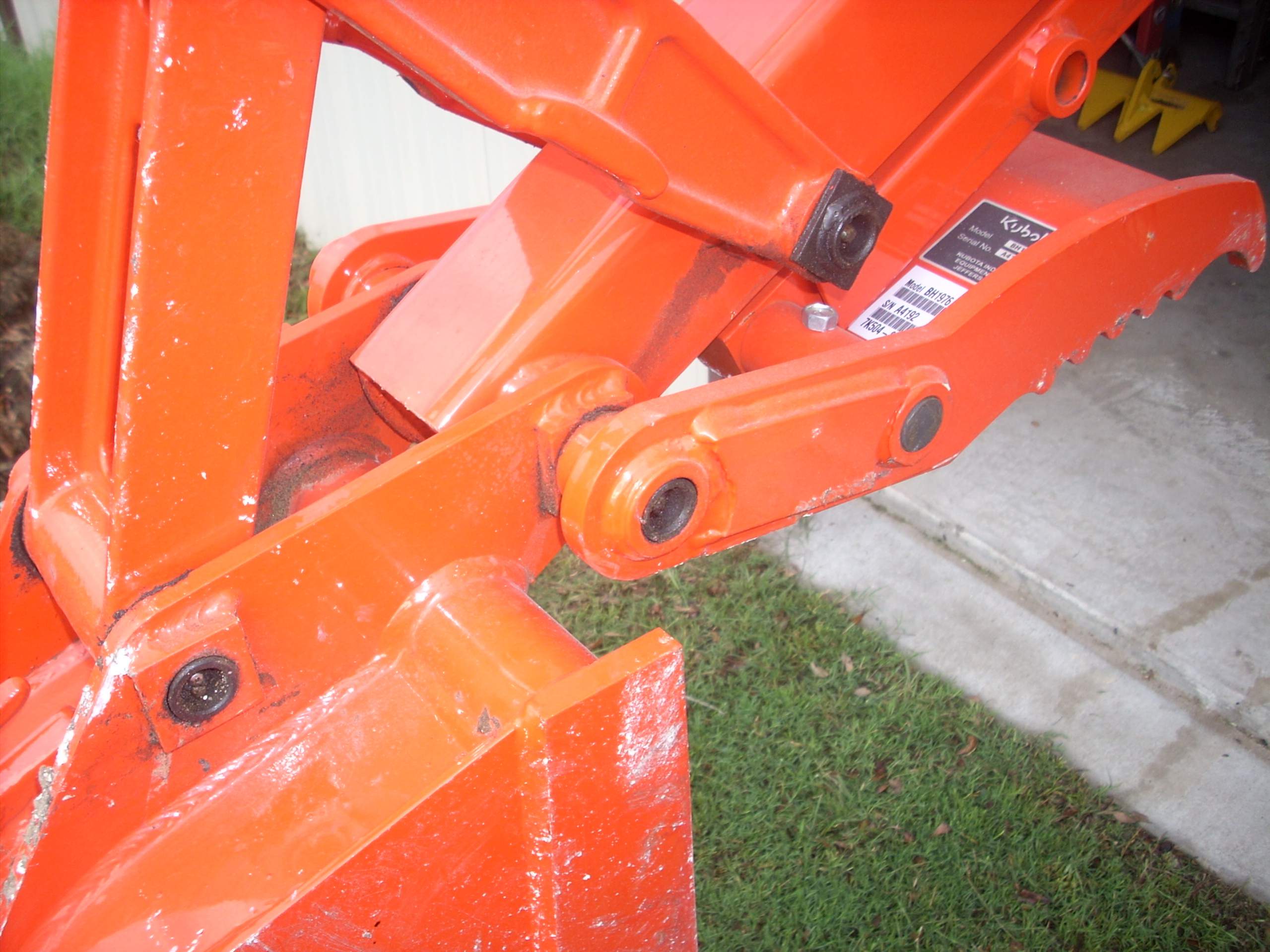

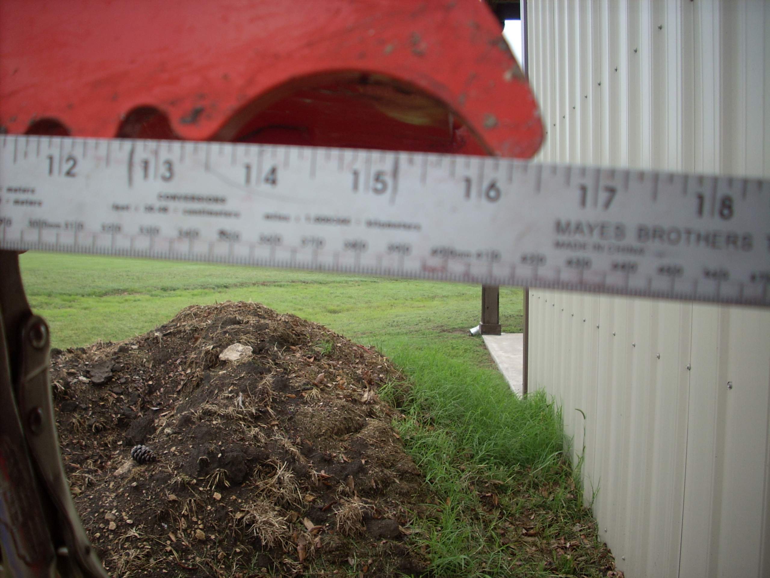

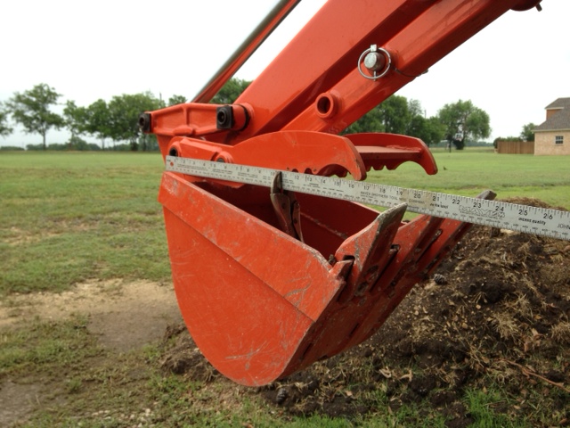

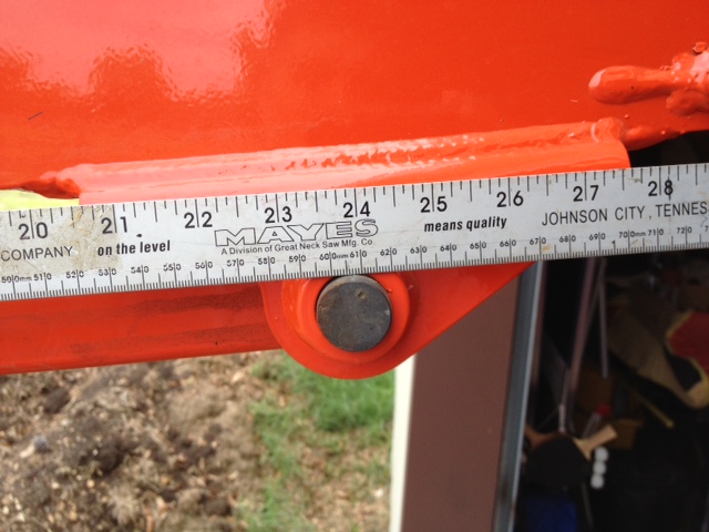

I'd like to adapt a BH77 mechanical thumb to a KX008 excavator. Is there an owner of a BH77 backhoe that could provide me with the outside width of the BH77 bucket where it attaches to the stick with the main pin, or if you have the Kubota 6 position mechcanical thumb, the inside dimension of the thumb where it attaches to the bucket at the main pin. Thanks

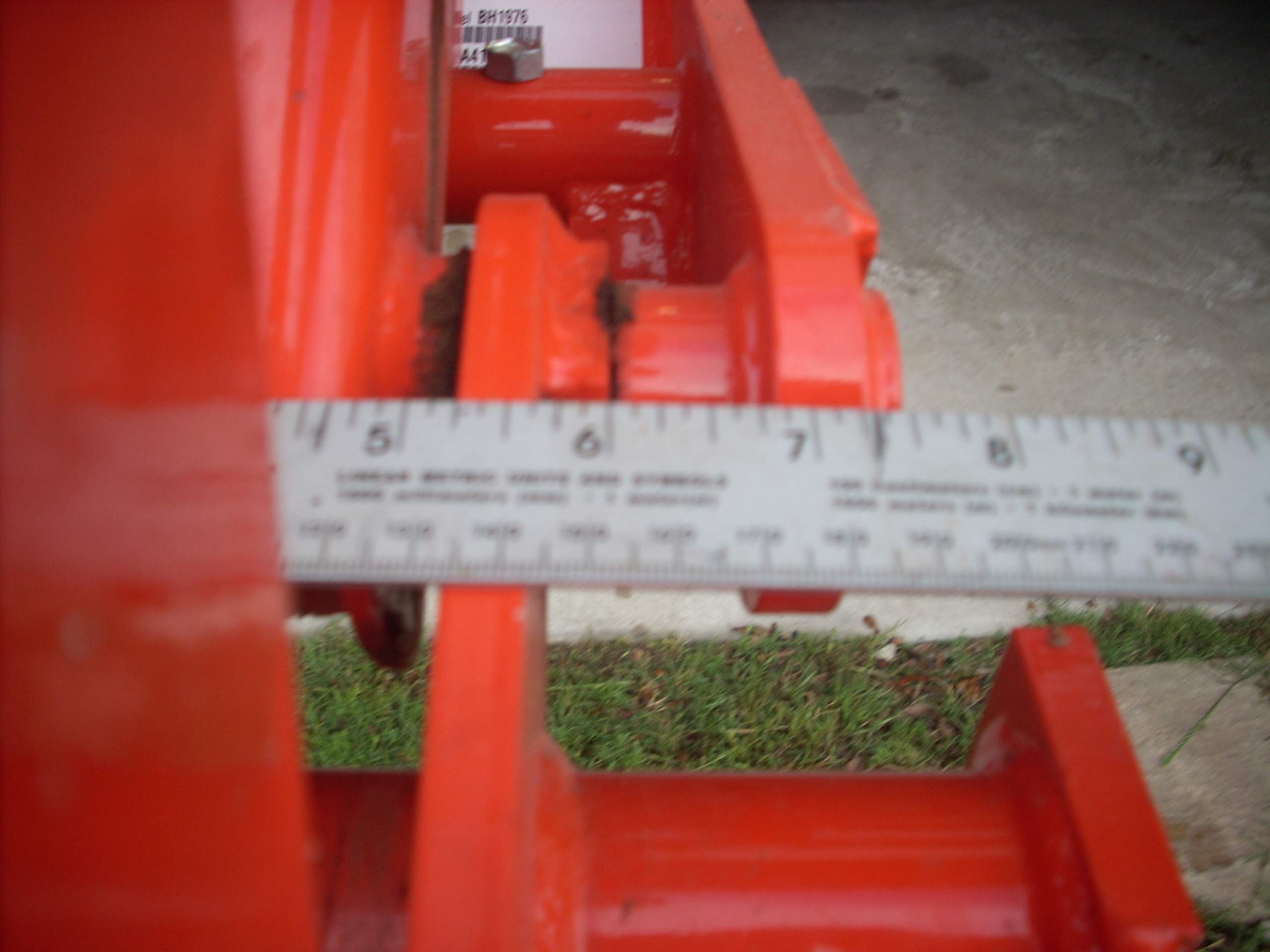

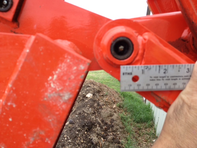

Looks to be exactly 6 inches. Maybe just a hair over 6 if anything, probably due to the thickness of the powder coating. First picture is deceiving due to the angle I snapped it. Let me know if you need anymore info.
Take care,
Russ

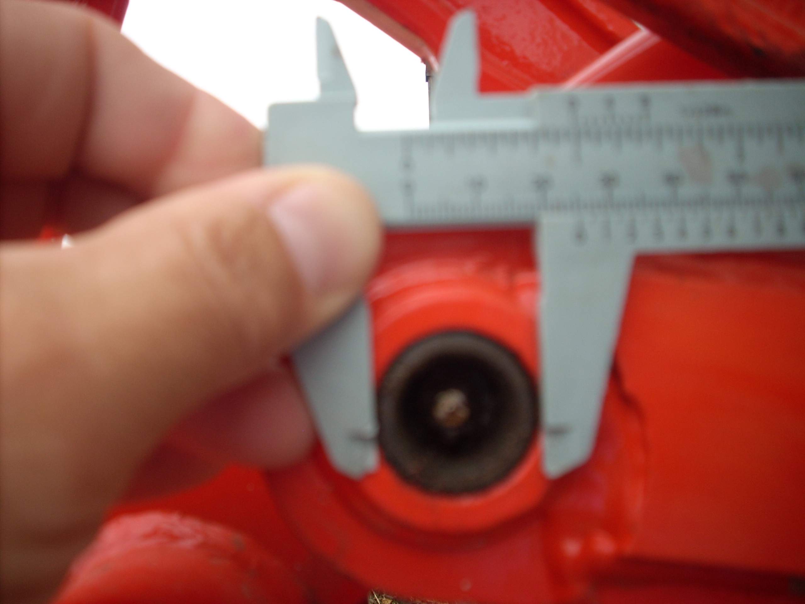

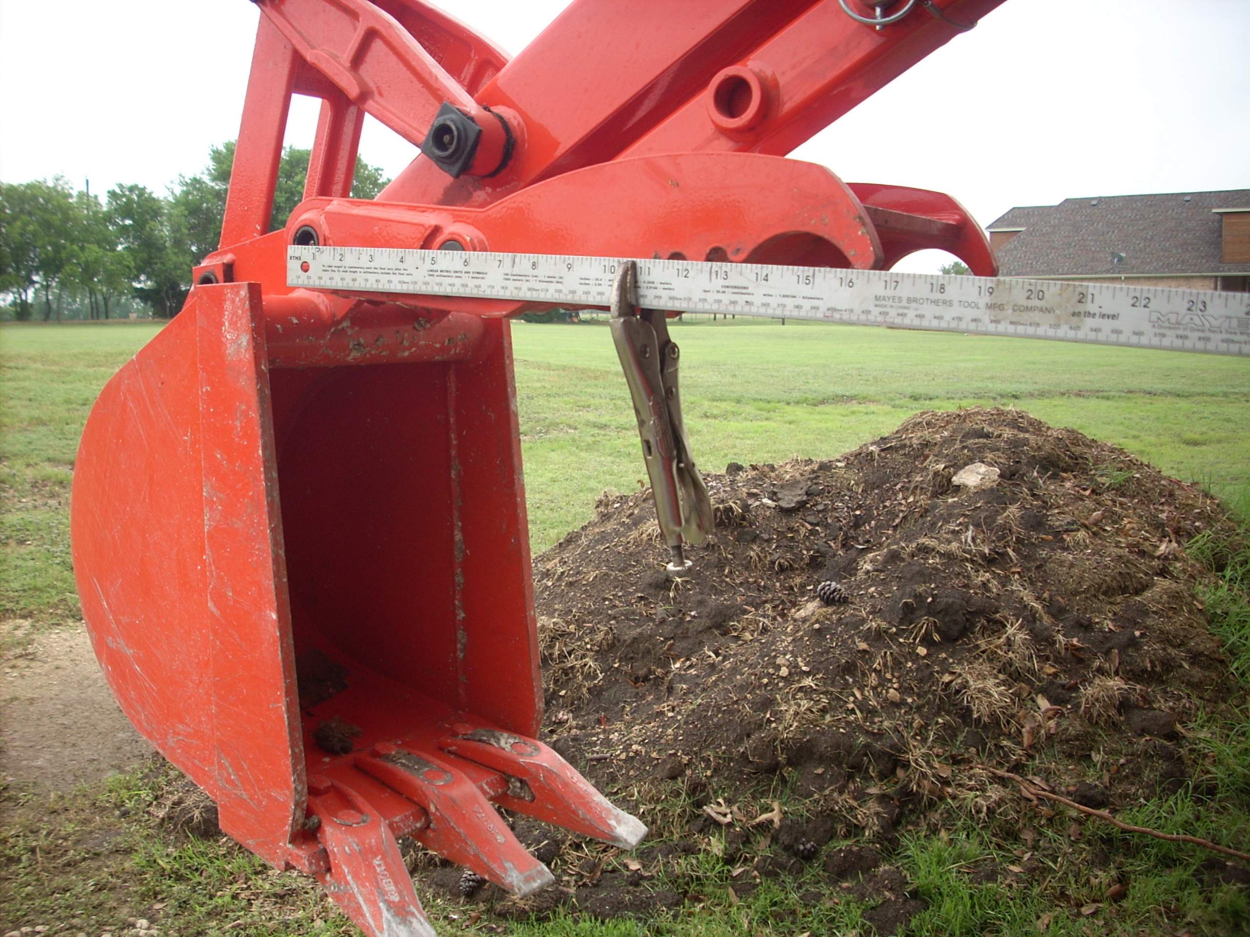

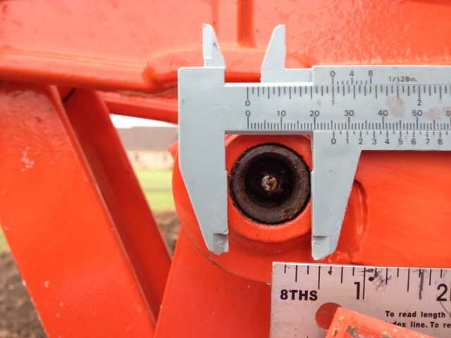

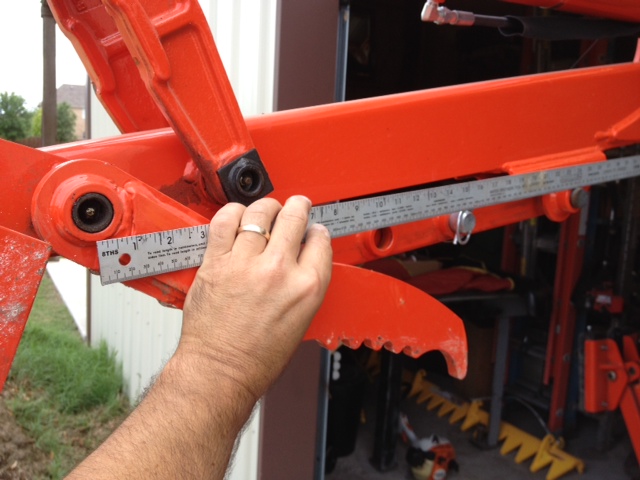

Thanks Russ. Good pictures. That's the measurement I wanted. It looks like it will work with my KX008. I believe it's the same pin diameter, just under an inch. Since you offered, can you measure the length from the pin to the tip of the thumb?

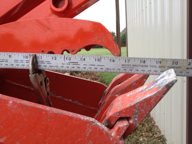

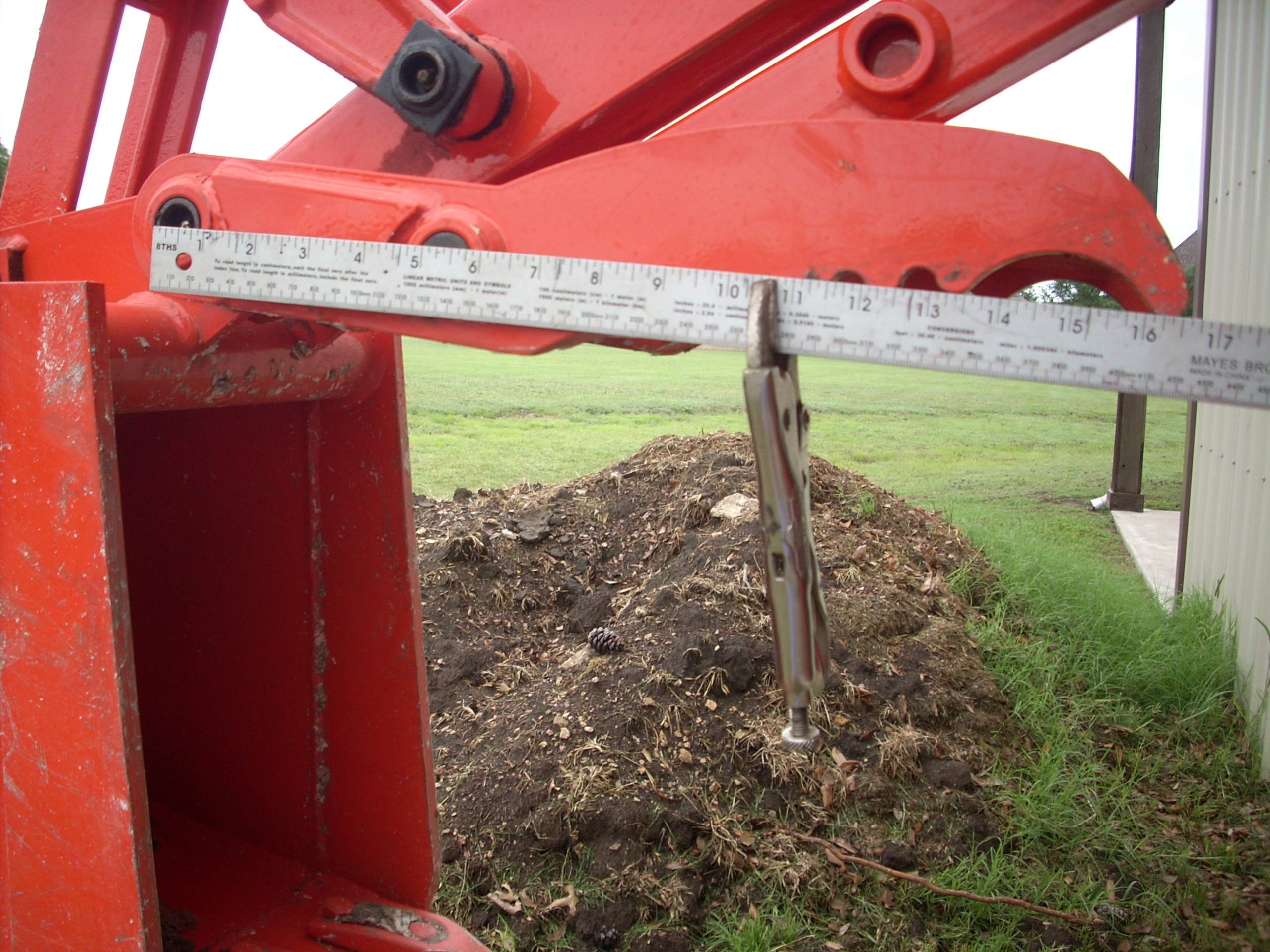

You are correct, the pin looks to be right at an inch, or just under. Total length looks to be 16.5" from center of the pin to the tip. Can't figure out what is wrong with my cheapo camera. It focuses and then goes out of focus when I snap the picture. I will keep messing with it and repost better pictures if I figure it out. Let me know if you needed any further info. Back out to the garage to see if I can repair my leaf blower.

Thanks again Russ. My bucket is just a little longer than the thumb, but I can weld a few teeth onto it if need be. Now to see if a dealer can give me a reasonable price on one. The Kubota config. lists them for $475. Can't wait to start this project.

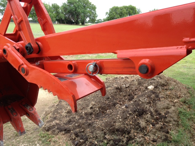

I can't figure out my camera issue. Here are a few pic's in focus from my phone. Have you checked out online with Lashley, Keller, or Messicks just to compare prices?

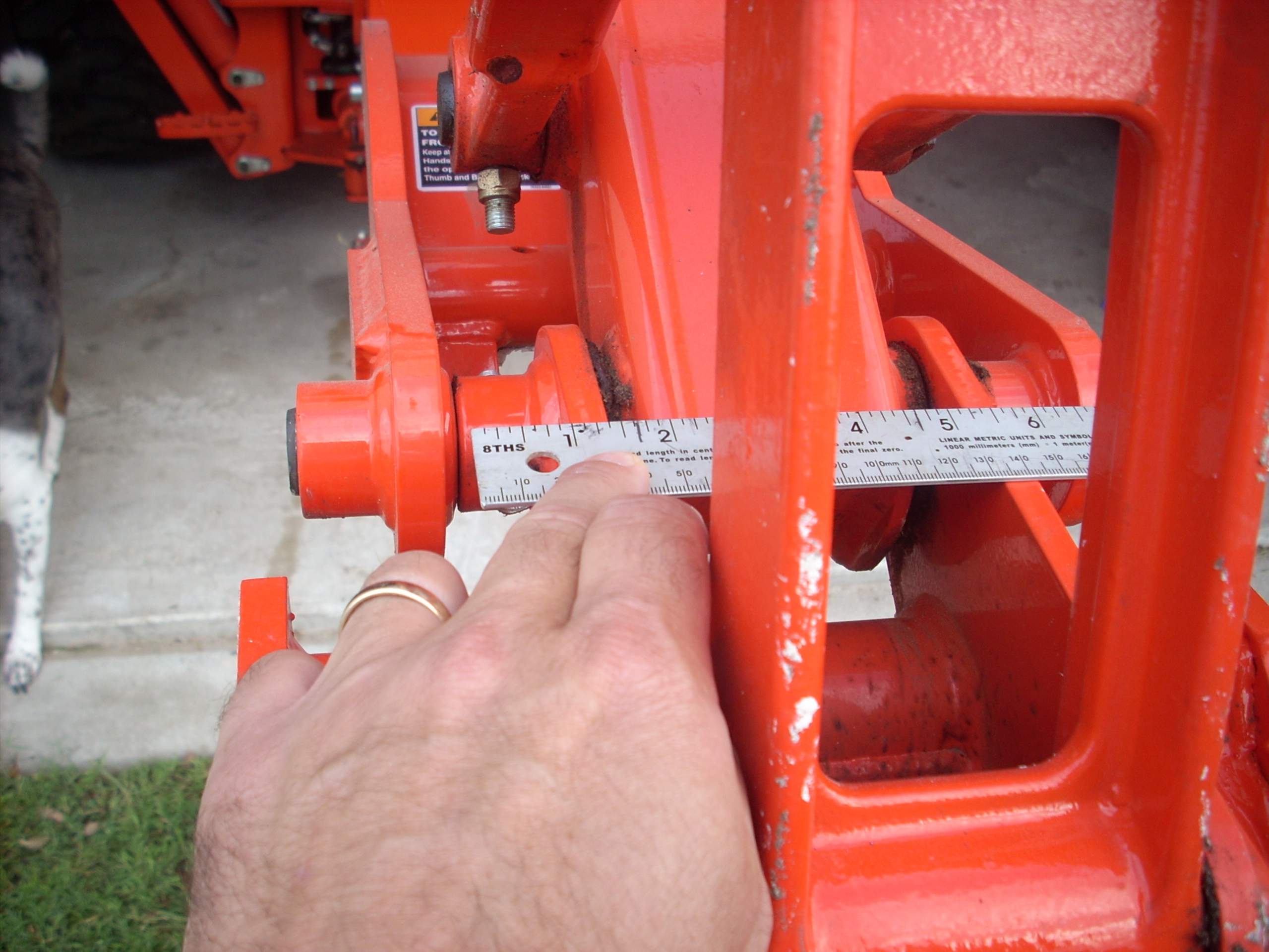

Russ, you've created a monster here. Gotta bug you for one more measurement. How much distance do you have from the main pin back to the small brackets that are welded onto the stick? My machine has about 28" or so to play with. I'll check around for prices. Thanks a million for all the help.

Hi Ronster,
No problem on the pictures. Glad I could help. I am not sure if this is what you were asking for. If not, let me know.

Thanks Russ. That's the measurement I was looking for. I believe this thumb will fit my kx008. Just need to fabricate the bracket for the pin on the stick. Got one price of $475 plus a little shipping. I'll shop around a little more.

Russ,the $475 was the price a dealer gave me and add some shipping to that. I'll call Messicks this week for their price this week. Also need to get a little steel to make the brackets to mount the thumb on the stick. Dose the BH77 use 1/4" or 3/16" steel for the factory brackets? Thanks.

The brackets appear to be 1/4" exactly. I am not sure the powder coating thickness, but it is hard to imagine it being 1/16" ????? If it was me, I would use 1/4". Hope you find someone willing to knock a little off on price, even though the $475.00 is not bad I guess.
