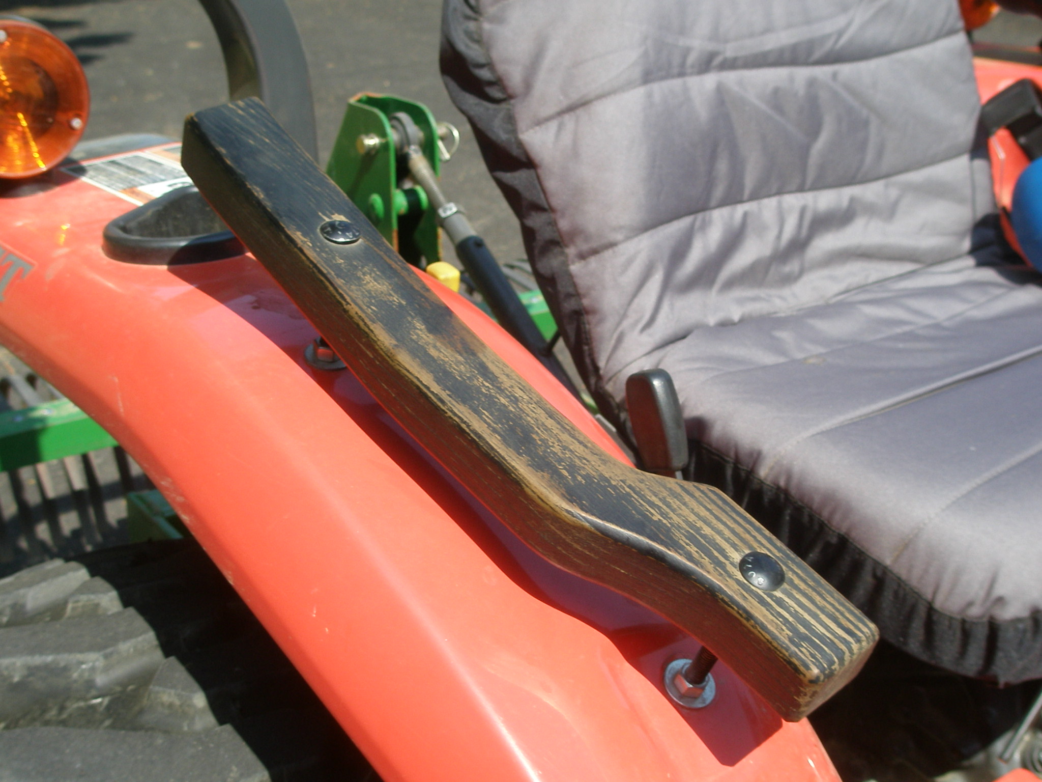

Well I have the bh77 backhoe on my L3800. Now I want the OEM thumb. So I go to my dealer and get a price last year $465. Then He says $200 to install it and tax. Thought I was capable of installing my own thumb or is it a warranty issue?? The reason I am a bit paranoid is that after buying the L3800 I noticed that the right side hand grip is missing and was told you have to buy the grand series to get that or pay extra for one. So I built my own out of a 2x4 and bolts. I use it a lot too. When I had the rim guard ballast put in, the home built hand grip was noticed. When I bought the tractor in Feb. 2011 I asked for prices and was told $950 for a thumb. I think the correct thumb is BH1976 but nowhere can I find that in any Kubota literature.
Anybody else have these experiences or do I have to find a new dealer.

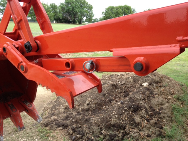

Thanks Russ. That's the measurement I was looking for. I believe this thumb will fit my kx008. Just need to fabricate the bracket for the pin on the stick. Got one price of $475 plus a little shipping. I'll shop around a little more.

Russ,the $475 was the price a dealer gave me and add some shipping to that. I'll call Messicks this week for their price this week. Also need to get a little steel to make the brackets to mount the thumb on the stick. Dose the BH77 use 1/4" or 3/16" steel for the factory brackets? Thanks.
Ronster
The brackets appear to be 1/4" exactly. I am not sure the powder coating thickness, but it is hard to imagine it being 1/16" ????? If it was me, I would use 1/4". Hope you find someone willing to knock a little off on price, even though the $475.00 is not bad I guess.

It's the high cost of our addiction to tractors and expensive pieces of welded metal. I can find some 1/4" stock somewhere and bushings at TSC. Thanks.
