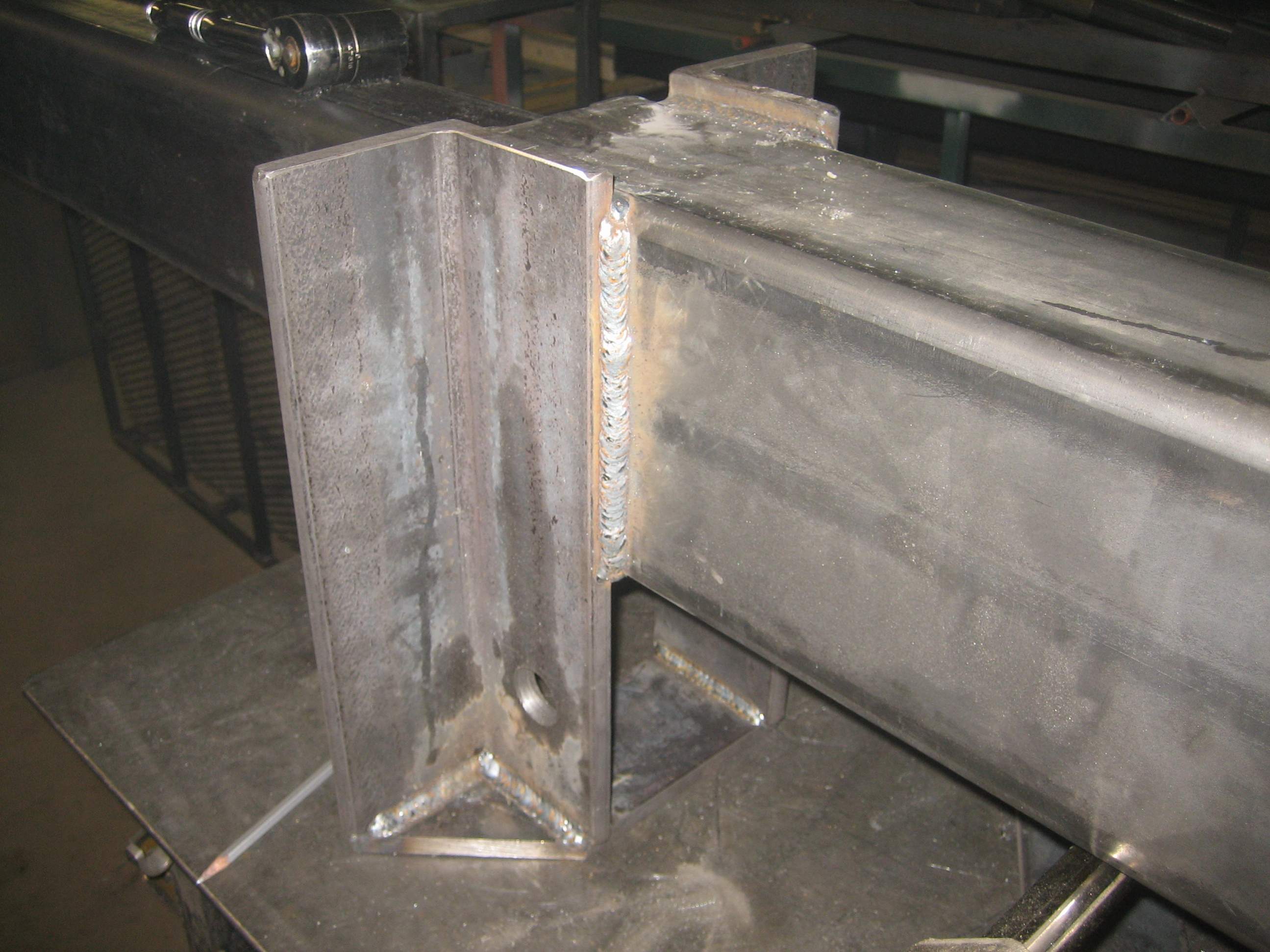

I had a little time this afternoon so I beefed up those angles a bit. Someone on another site said A36 angles have a tendency to twist.

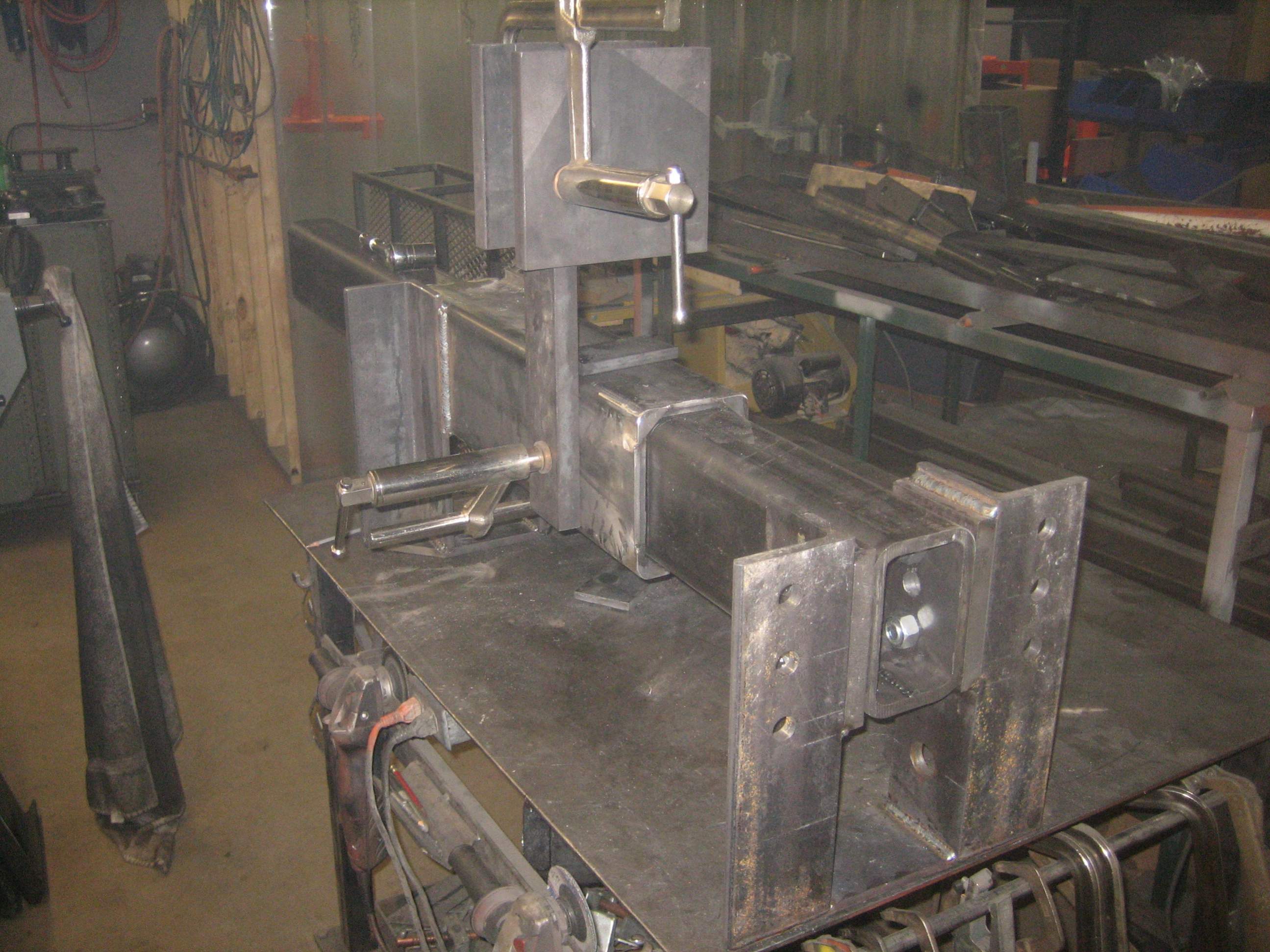

Here is a pic of the whole assembly sitting on my welding table right side up. I have mocked up the push block system. If you can imagine the working table top between the tube/slide and the push block you will have a pretty good idea about how the Erectus will function. There will be two slots along the length of the table where the 1" x 3" flats will connect the slide to the block. The upright flats have not been cut to length so the block is sitting further away from the slide eventually will.
I still am waffling between a plate steel top or 2 x 2 angles with the point up to create a corderoy effect to keep the logs from sliding around.
Keep the comments coming they keep the creative juices flowing.
Stay tuned the table frame is next! :thumbsup:

Here is a close up of the nylon I used to line the inside of the larger tube to prevent galling and give a real true slide with no slop. It is kind of hard to see because it is black. The steel is shiny from grinding the nylon is Flat Black.
The little angle pieces are there to keep the nylon from coming out. I just tacked one end so after 10,000 cords or so I will be able to replace it.

   / Bi Directional Log Splitter #27
Is the cylinder going to mount below the slide? Having the cylinder so far out of line with the push block will put a lot of undesirable torque on the slide. Conventional splitters have the cylinder totally inline. The dual split designs have a much longer tube-in-tube guide to handle the torque of the upright blade. If you are mounting the cylinder low I'm afraid it will bind up even with the nylon inserts.
#28
That is a legitimate concern. The reasons I chose this method are as follows.
1. I am able to keep the overall width of the splitter down by cantilevering the ram attachment in relation to the push block.
2. I do not have to put the cylinder inside a tube and have the hoses subject to kinking and wear
3. I can keep the cylinder out of the way and in a protected position.
I hope to offset the additional torque by having it spread over the 30 inches of 7 x 5 tube and use of the nylon sleeve. I guess I will find out if my judgements are correct.
Thank you for the input.
