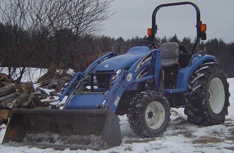

Hi Bob,
I own a TC35, and motor aside, has the same dimensions as your machine.
It's got R4s on the front and wide R1s (I think they're called wide-bar) Ags on the back (see attachment on this and next post).
The R4 industrials are 10.00-16.5, the Ags are 17.5-24 Titans.
I purchased the machine used this way and was told that the original owner wanted the traction of the R1s on the rear but the flotation of the R4s on the front...
So far I've used them in snow, mud, grass and gravel. I've been real happy with them.
I haven't done any scientific tests yet, measuring the rotation ratios of the front & rears, but I can tell you that it doesn't seem to bind up any worse than most others report, or what you'd expect. At times I can drive several hundred feet on gravel and grass with the MFWD engaged and switch over to 2WD by just letting up on the throttle and pushing the 4WD lever down. Other times I need drop it into reverse and roll a few inches (haven't cataloged this, but it seems to happen more when I'm doing lots of turning and maneuvering with FEL loads on mixed surface conditions).
I have gotten it momentarily stuck a few times, and needed to use the FEL to push myself out; one time I had opposite corner wheels barely touching (on very uneven ground), another the rears were coming up due to an excessive load in the bucket while at the bottom of a slope, one time I was trying to dig a bolder out of the mud and just couldn't get decent footing - realizing afterwards that I was still in 2WD... Cant really fault the tires for most of the 'em. /forums/images/graemlins/grin.gif
Bruce.
