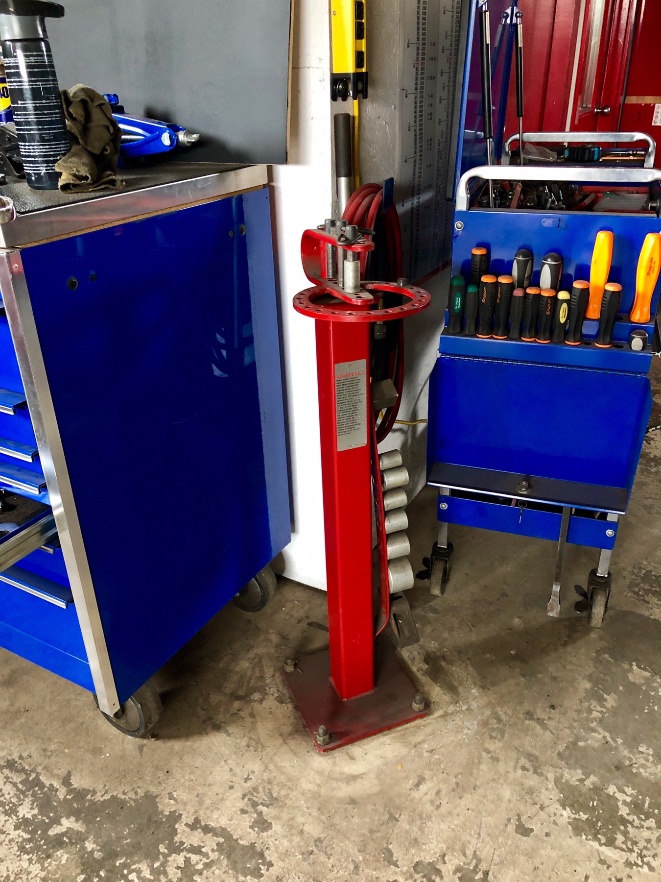

Thank you Rustyiron. Those “chain pots” were a terrific find. Glad you posted the pic in case someone wants to make similar.
My cheap import bender is “outside corner” located in my shop. It is concrete lagged to the floor. The outside corner location allows full usage (after moving my tool boxes) while not being in the way.

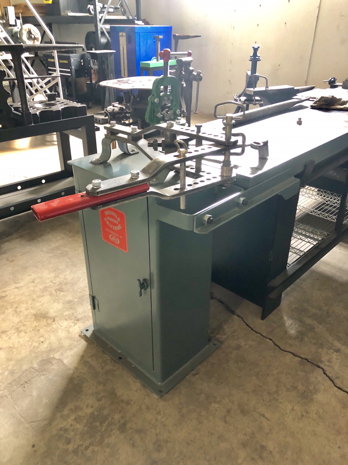

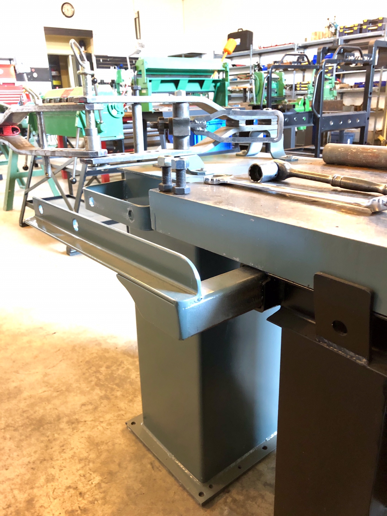

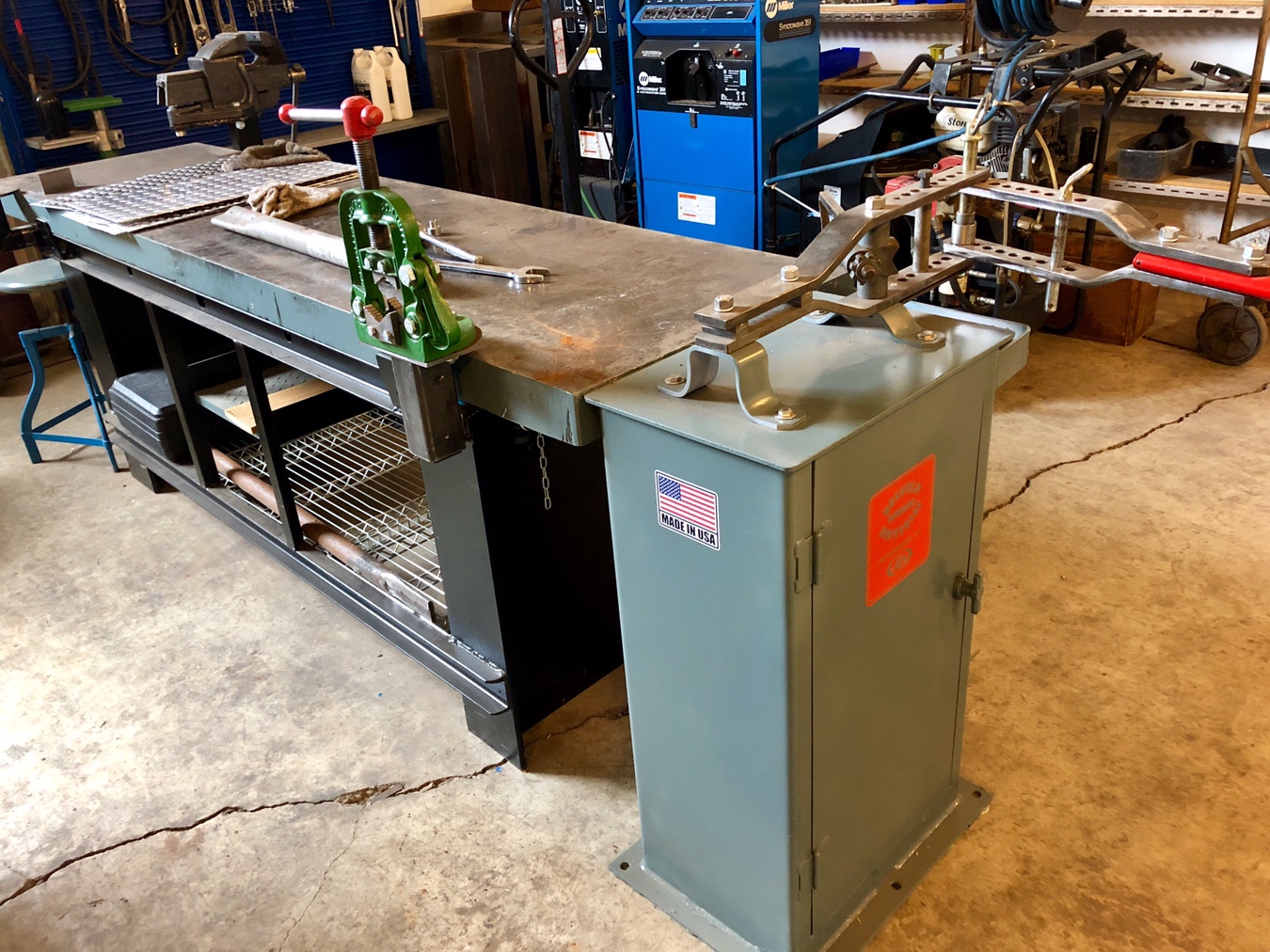

My Hossfeld is horizontal receiver mounted to my welding table for stability. The receiver mount is on the right as the bending forces are clockwise.

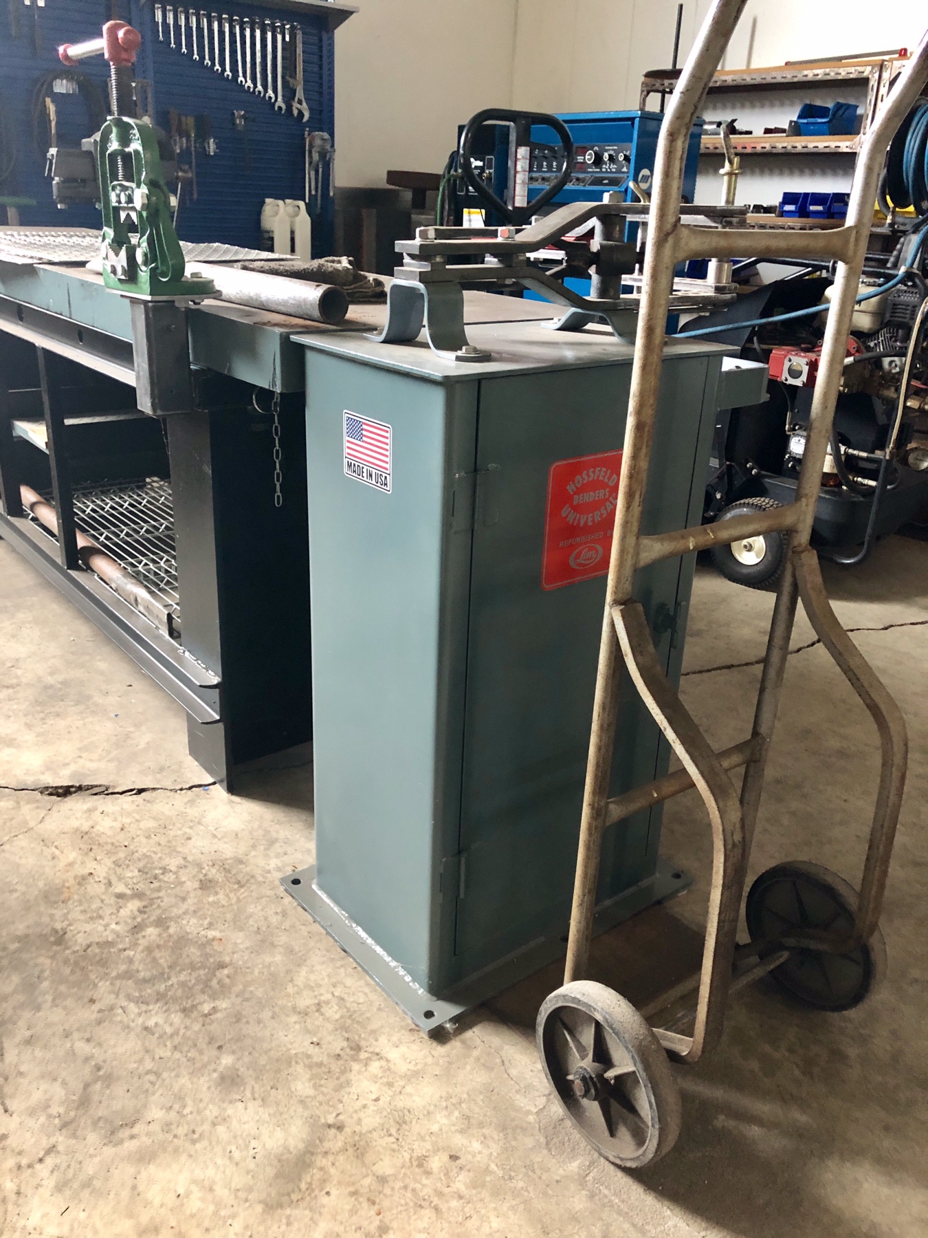

The cabinet base has two 1/4” strips of flat bar welded to the bottom which allows easy moving with a hand truck if necessary.
Is that a Hossfeld cabinet? Never seen one of those, all the ones I've seen are on a large diameter pipe style stand (mine included). Yours looks like new! Is it a No.1 or 2?

Yes that is a Hossfeld cabinet and the original No 1 bender. I refurbed everything and repainted. I even talked to the owner of Hossfeld but was unable to get new decals of any sort so I got the MADE IN USA decal off eBay and had my sign guy design a “custom” Hossfeld decal.
Sometimes you just gotta do what you gotta do.
BTW as you probably know a No2 bender is heavier and has larger die pins which make it readily compatible with most other popular benders.IIRC

Well I have to say it turned out excellent, you don't see too many No.1's, I remember looking and it seems dies were a bit harder to come by used, did they only put that style cabinet under the No.1? I was lucky and had the opportunity to purchase a No.2 a few years ago that came with a good number of dies and the 180deg arm and the hyd. setup

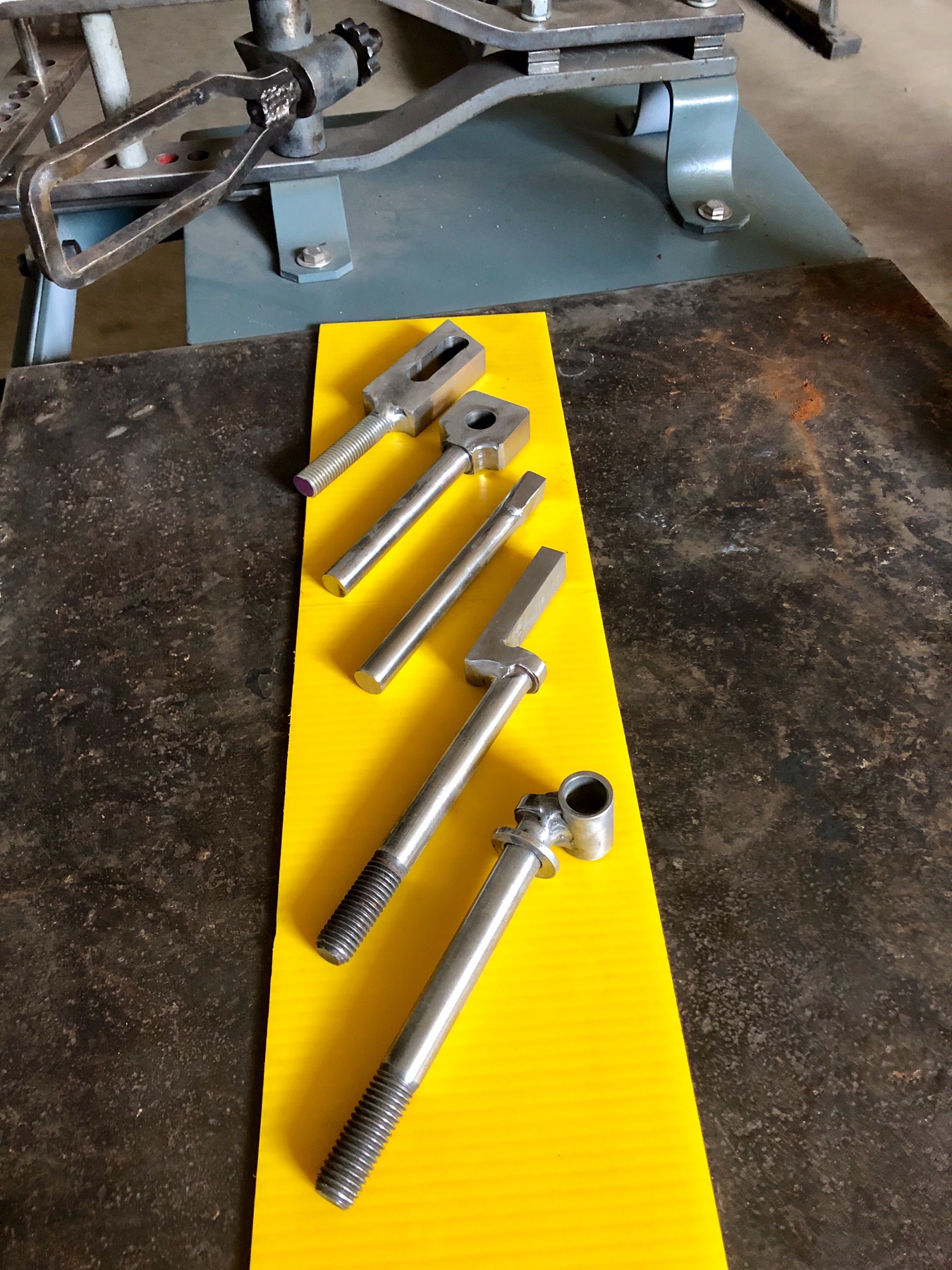

TMGT I’m quite certain the cabinet only came with the No 1 as an option and the pipe stand as an option on No 2’s like yours.
I came across mine from an old fellow who had purchased it used about 30 years prior. He never got around to using it and because it came with the OEM cabinet and a box of various dies I grabbed it.
However these parts which I ended up fabricating myself, were missing:
I was fortunate to find dimensions on line which eliminated having to purchase them. They would have been an outrageous price by the time I got them into Canada.
I figured close tolerances weren’t necessary and as you can see I DIDN’T use the milling machine to fab as it would have taken way too long with my limited machining skills.
