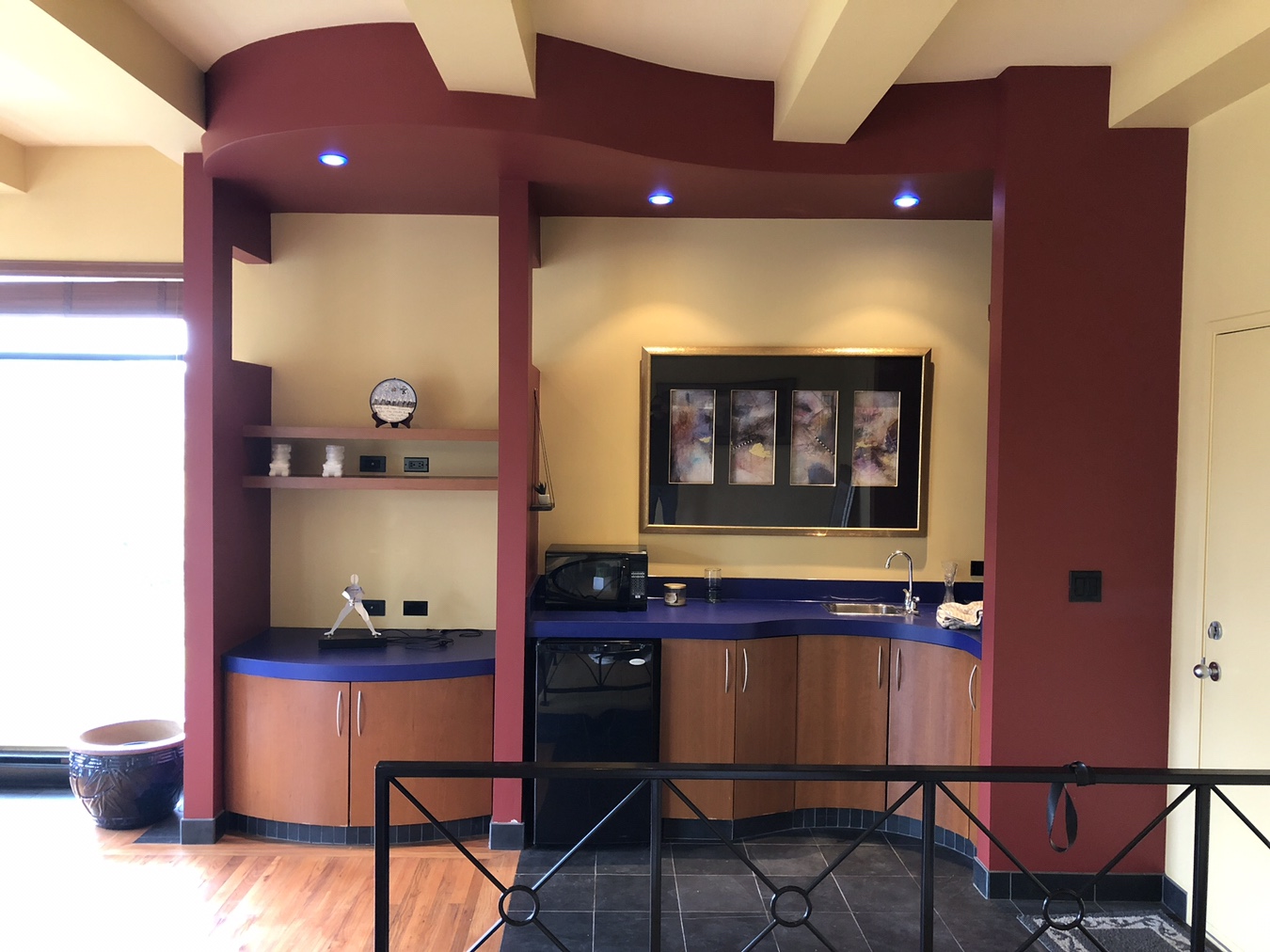

OFFICE
Here’s my small “outer” office in the “main” shop

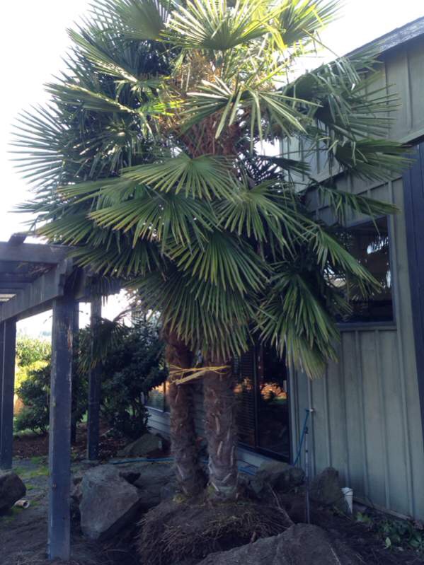

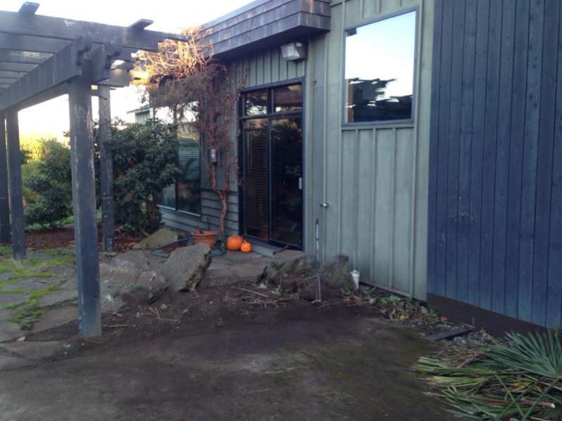

The rear of my shop and outside entrance to my “inner” shop. (Are you still following?). :D

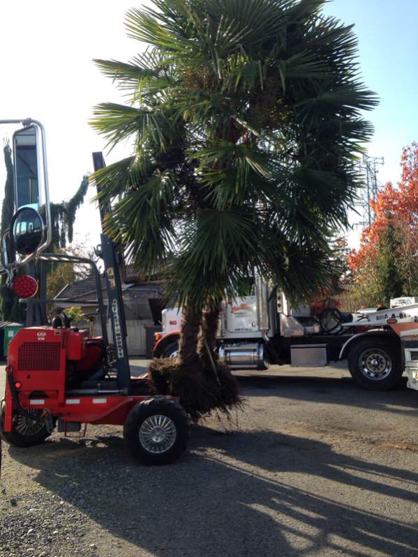

This pic was taken a few years back when the palm tree was getting out of hand. I dug it out and sold it to have more money for tools. lol.
Still have to get around to relandscaping.

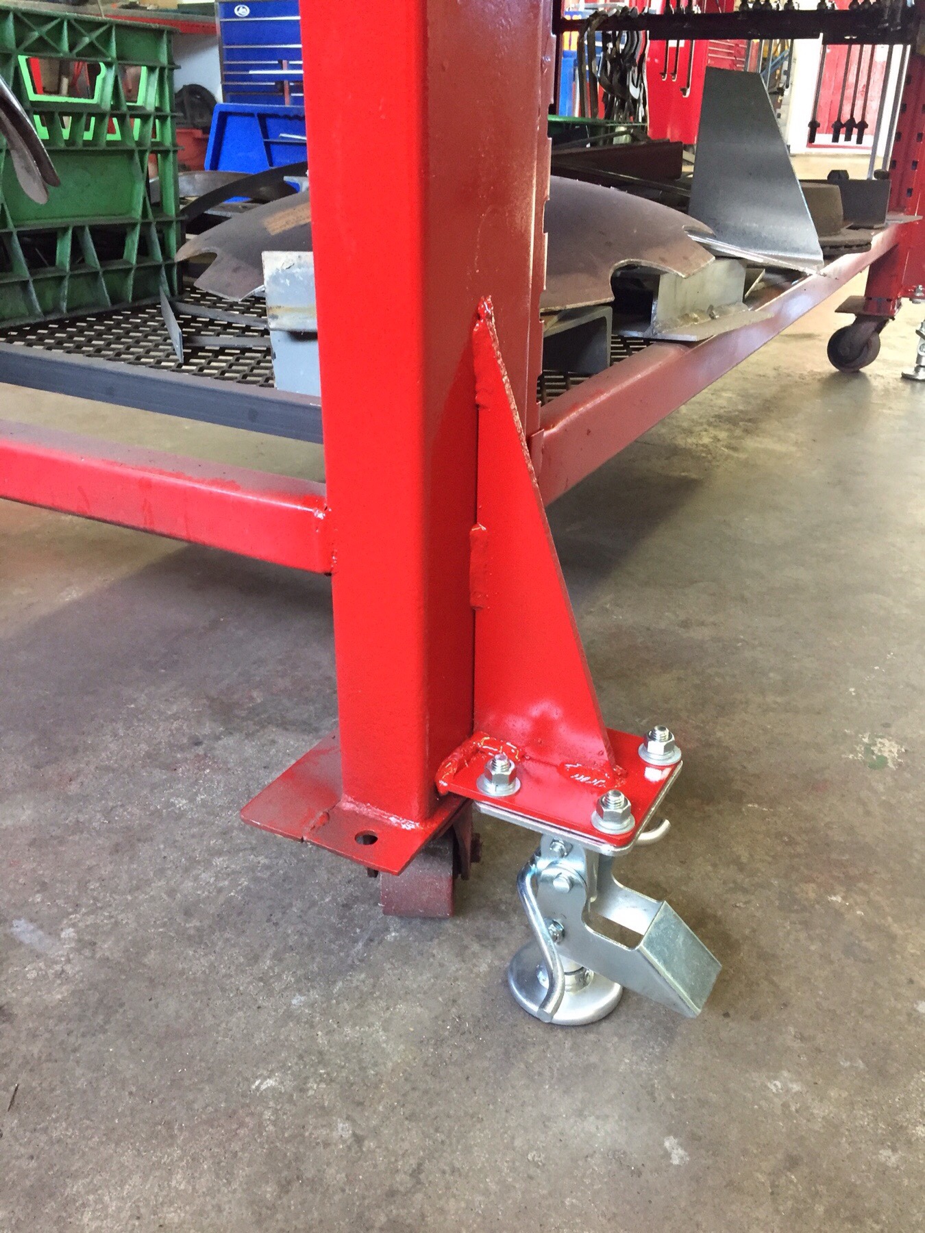

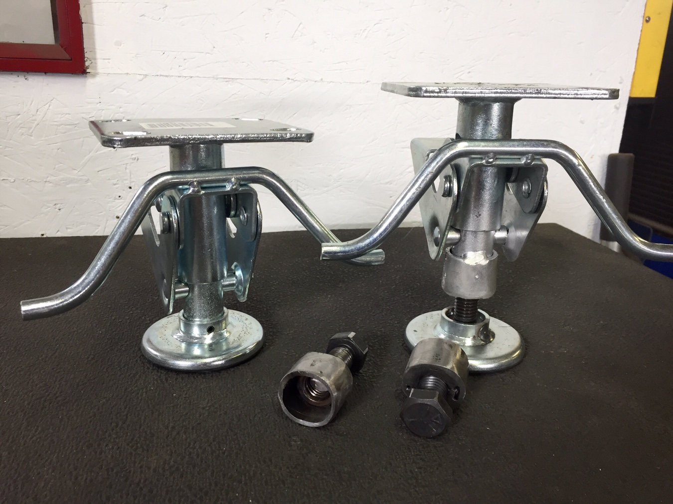

Terry, where did you get the pads or pedestals or whatever you call the things on your metal table to keep it fr moving? Looks like maybe foot operated? I used threaded pads that I wrench up and down. Not comvenient for a quick change from portable to stable.

Richard, I assume you are referring to the “wheel locks” on the corners of my 4’x8’ welding table?
This is it a few years back when I built it. 3/8” plate bolted (with a few added weld tacks to achieve flatness) to a frame utilizing salvaged pallet racking. It can be easily dismantled for transport but to this day I really don’t know why I went the extra effort to incorporate this feature.

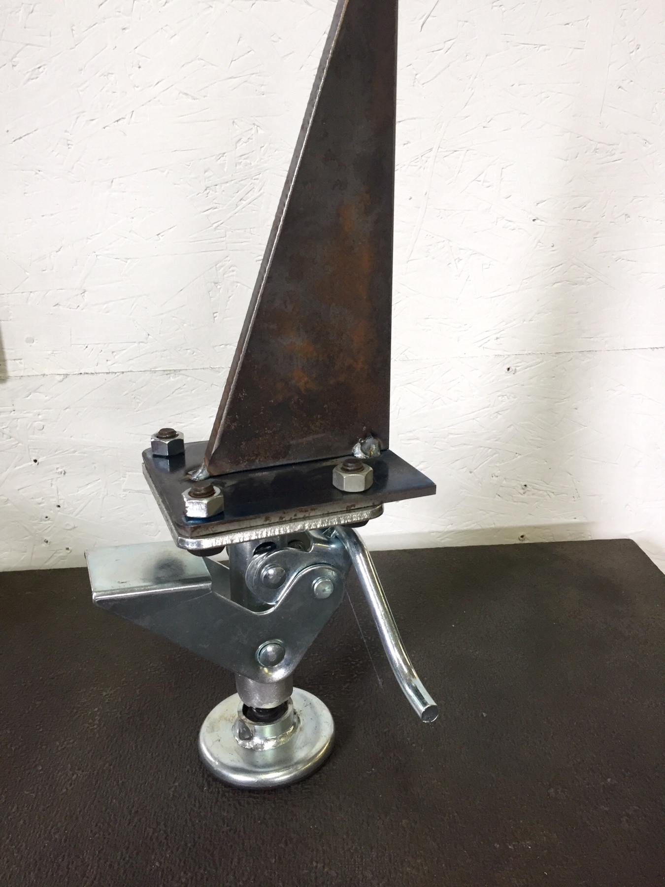

A year or two back Princess Auto featured these wheel locks for sale. Priced somewhere around $12 Cdn each iirc. By stepping on the foot pad the item is attached to, (typically a castered table leg) its lifted an inch thus stabilizing the fixture.
I further modified each of the four locks by adding a threaded rod enabling the welding table to be levelled.
Floor lock on left in original form. Modified one on right.
AFTER I modified these locks I found adjustable ones on line but to ship them to Canada would have been a spendy proposition.
