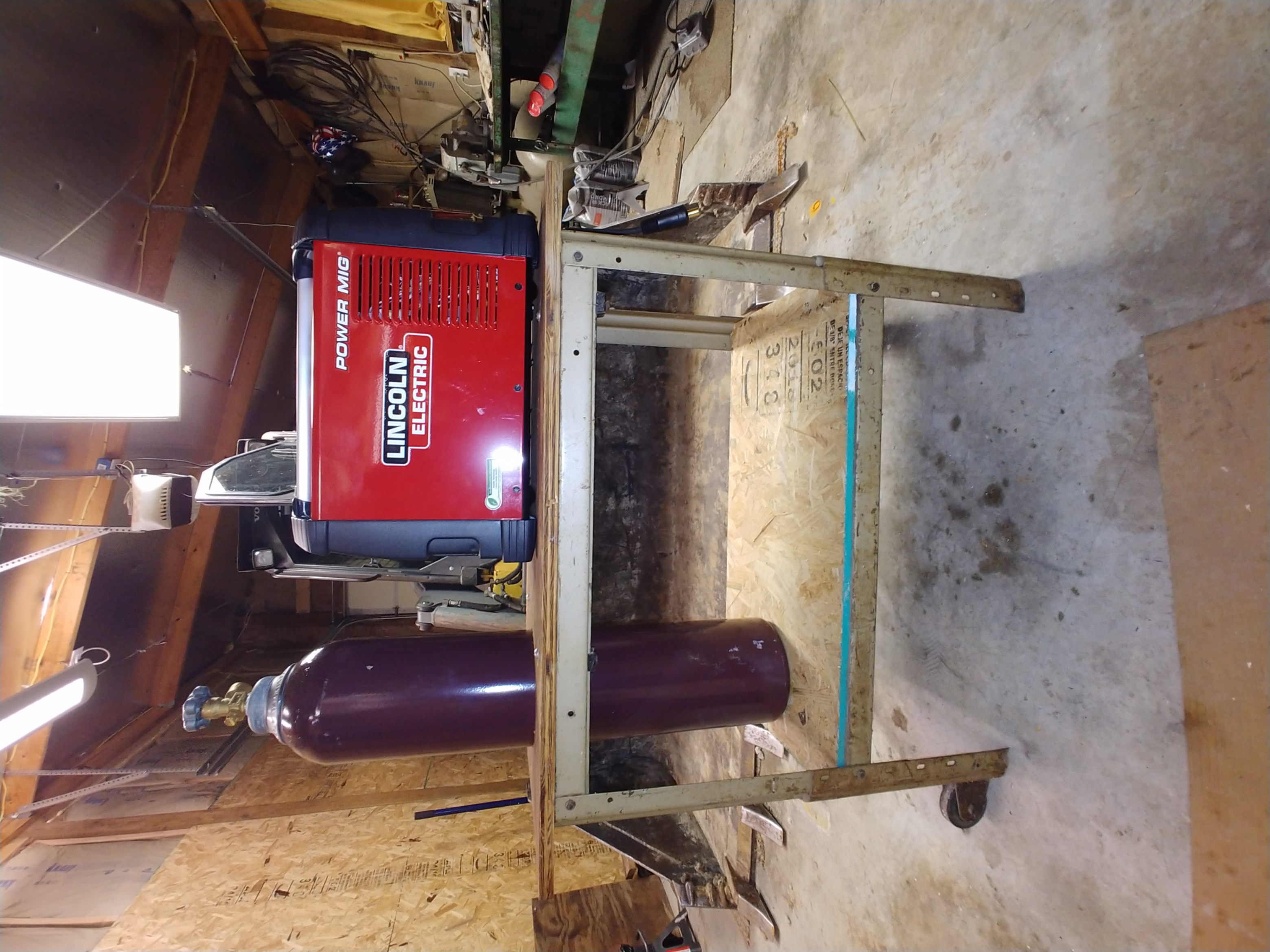

I ended up with red - havent fired it up yet, my wife picked up this cart on a walk. It was destined for the landfill so we rescued it and I knew one day i could find a use for it. Well that day has come. I added a shelf, a couple cross supports and cut a hole in the top for the bottle and viola' mig cart, it has wheels on the back legs so you just pick up the front a couple inches and away she goes..........

View attachment 643752View attachment 643753View attachment 643754View attachment 643755
Those are 2 nice machines :)

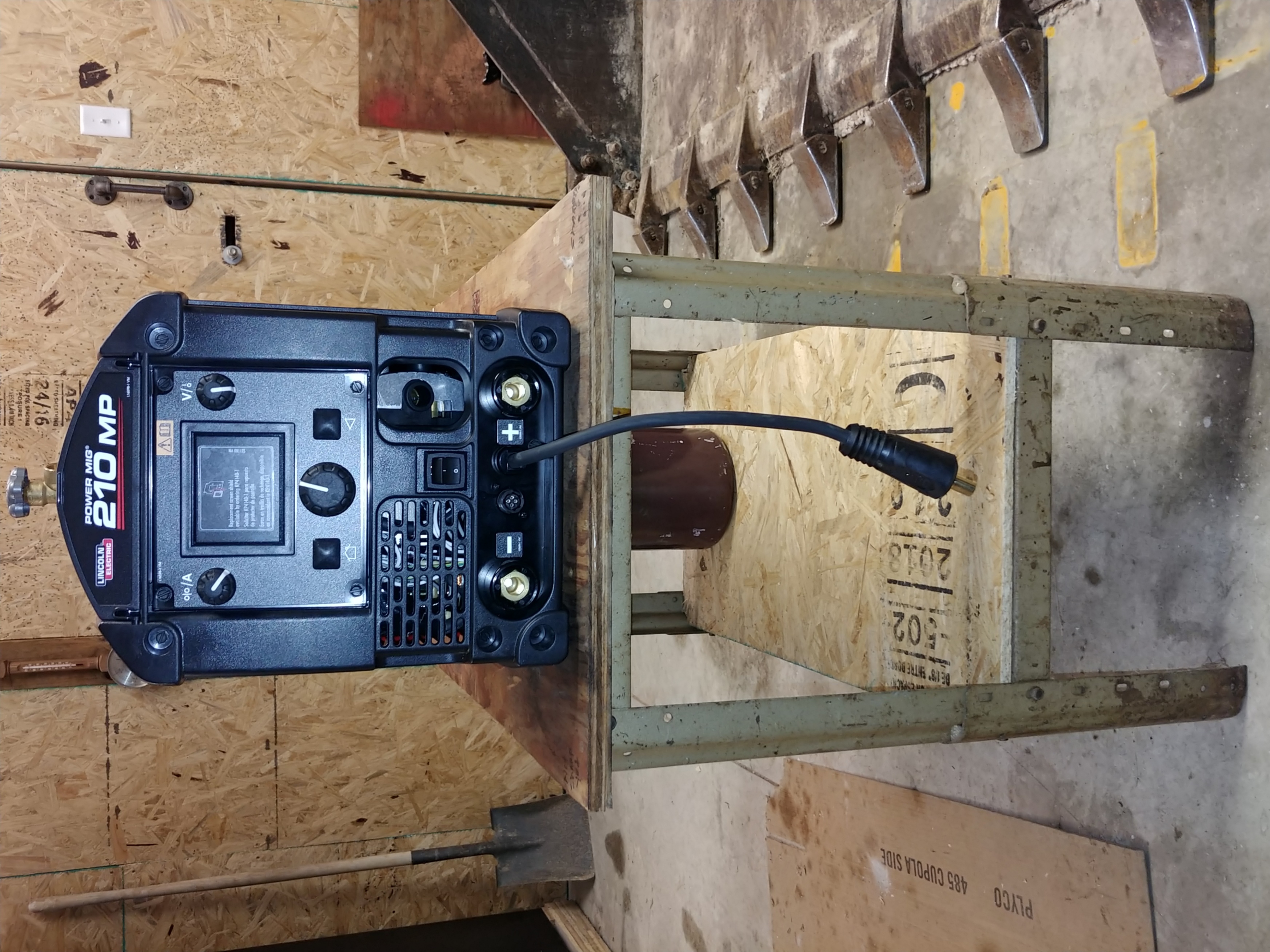

1st update - got regulator installed, hooked up gas, hooked up mig head, set it up for positive since on C25, gotta put the other drive roller on for .30 solid wire and wire guide plate, powered it up on 110 and it turned on. Pressed some buttons/turned knobs, went thru menus, pretty simple but the manual is a little weak in my opinion. For instance it doesnt have a picture or tell you how to change out the drive roller for different size wires on the quick start OR in the manual.
outside of that so far so good - havent decided how i will secure it to my cart yet - ground and mig torch seem a weeeeee bit short but i havent welded with it yet so will have to see what i think when i get to laying down some metal.
pretty quiet, fan comes on when you turn on power even cold so its evidently a full time fan like my idealarc - my neighbor has an old mig that doesnt have a fan, its from an autobody shop and he said it was mad that way so it didnt stir up dust.
i picked up some tip lube for it curious, is that for solid wire ? cant think you would want that grease on flux core ?

Could you be referring to nozzle dip? It helps prevent spatter buildup in and on the nozzle and tip.
It is best applied when the nozzle is clean and warm.
