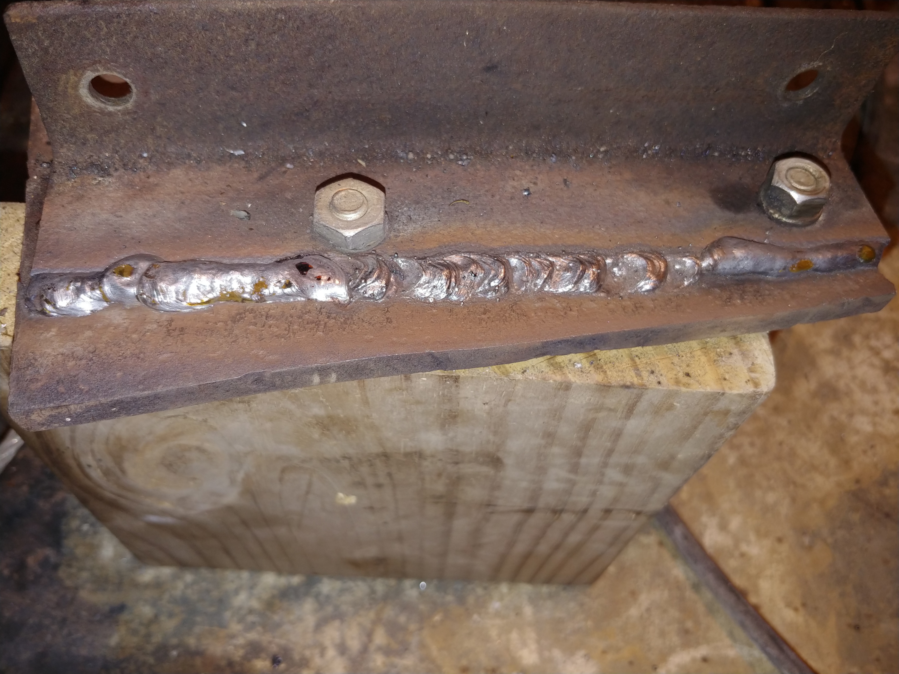

ok fellas..............here goes, my first attempt at welding mig with c25 gas and some stick welds with the same machine
.30 wire and all auto settings the lincoln chose for me
Left to right, first run was 1/8" 7018, next run was 1/8" 7014 - i didnt clean anything on that weld, total rust, had a lil trouble keeping the 7014 lit for some reason - 1/8 inch piece of angle on .345 thick place

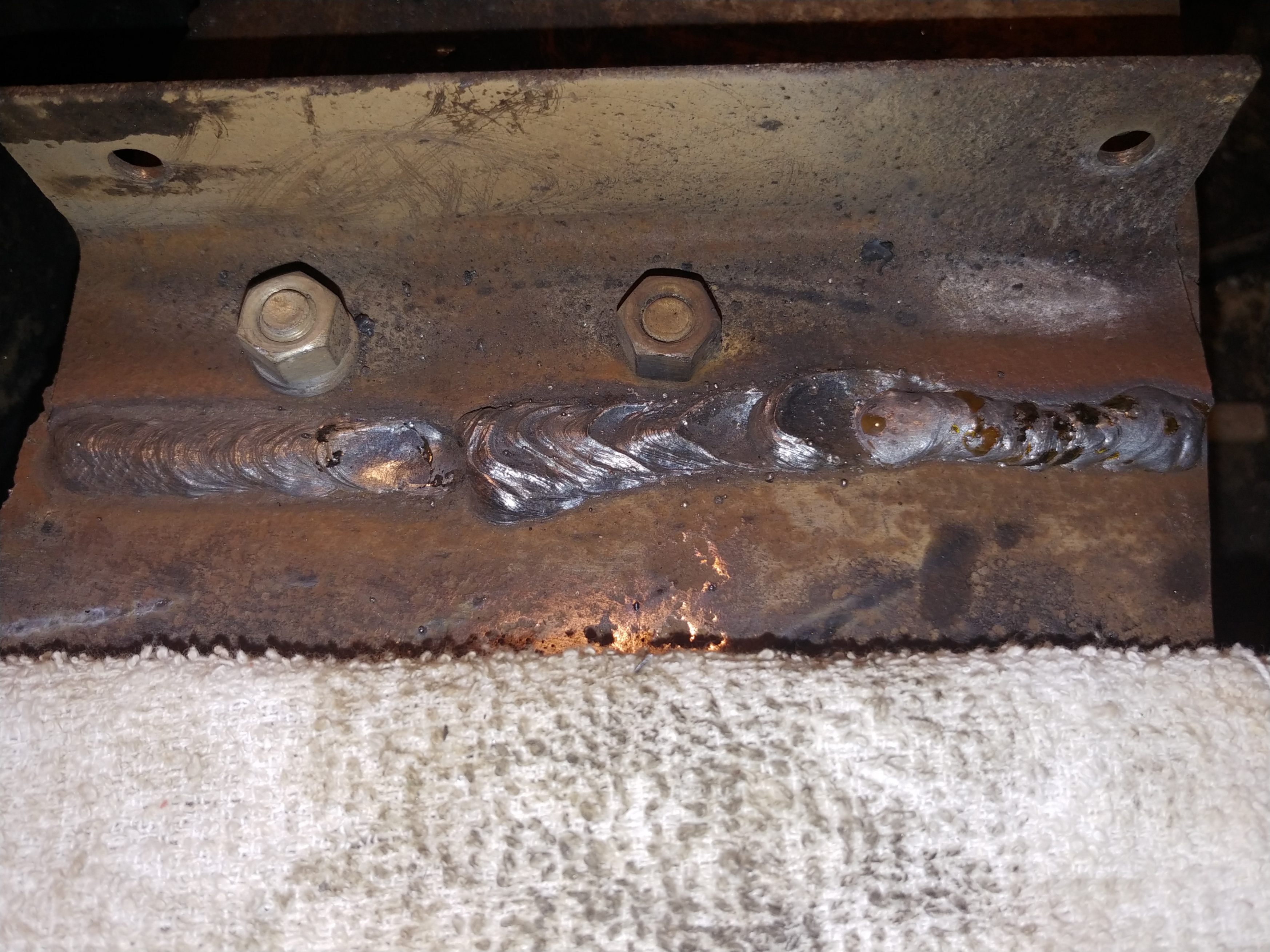

left to right in pic, short run of 1/8" 7018 and long run of 1/8" 7014 against .345 plate and .250 wall square tubing.

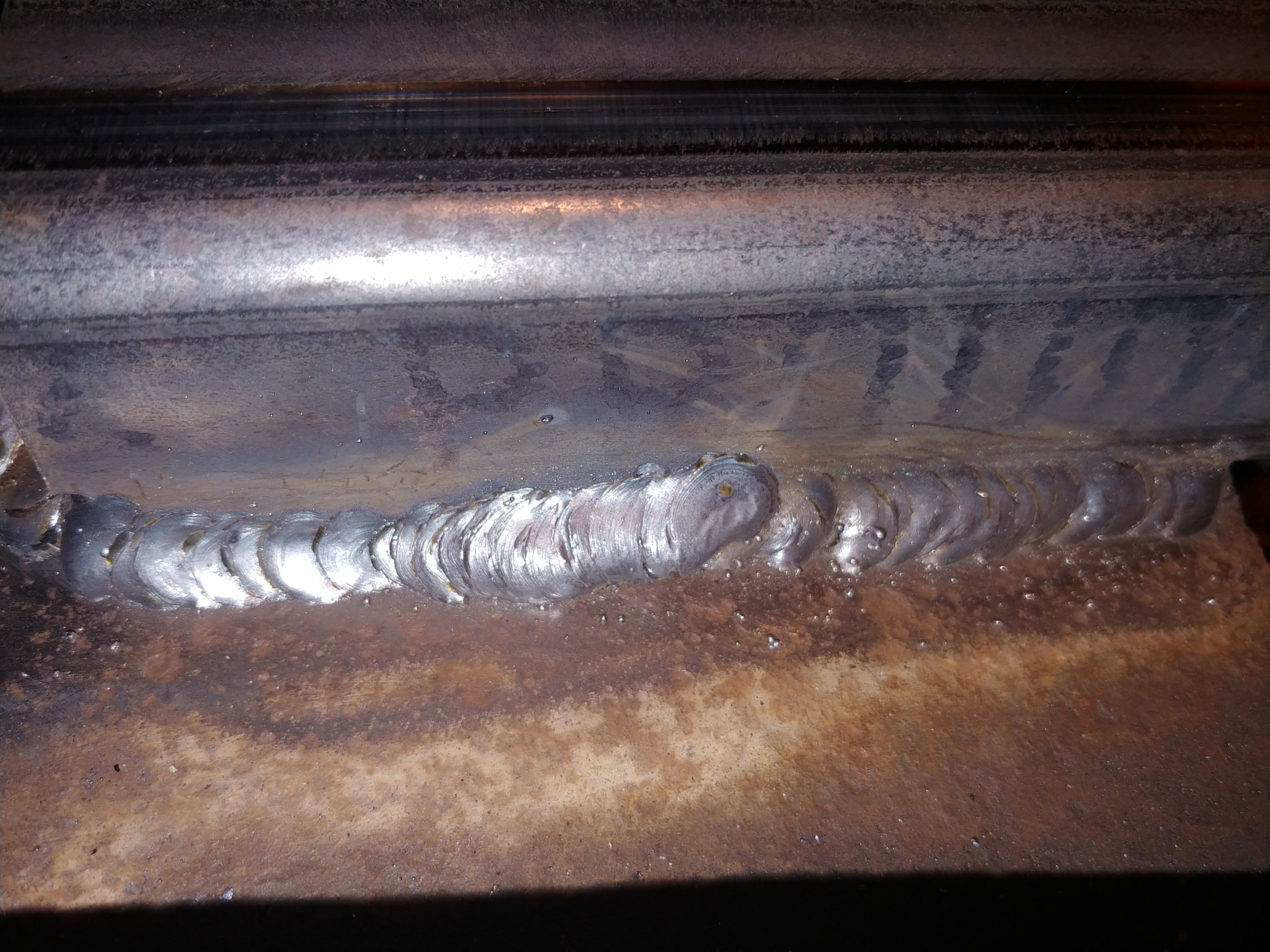

same .345 plate .250 sq tube, left side of pic is my left hand going to center and right side is right hand moving left to center couldnt get it positioned to run it with my right hand all the way.

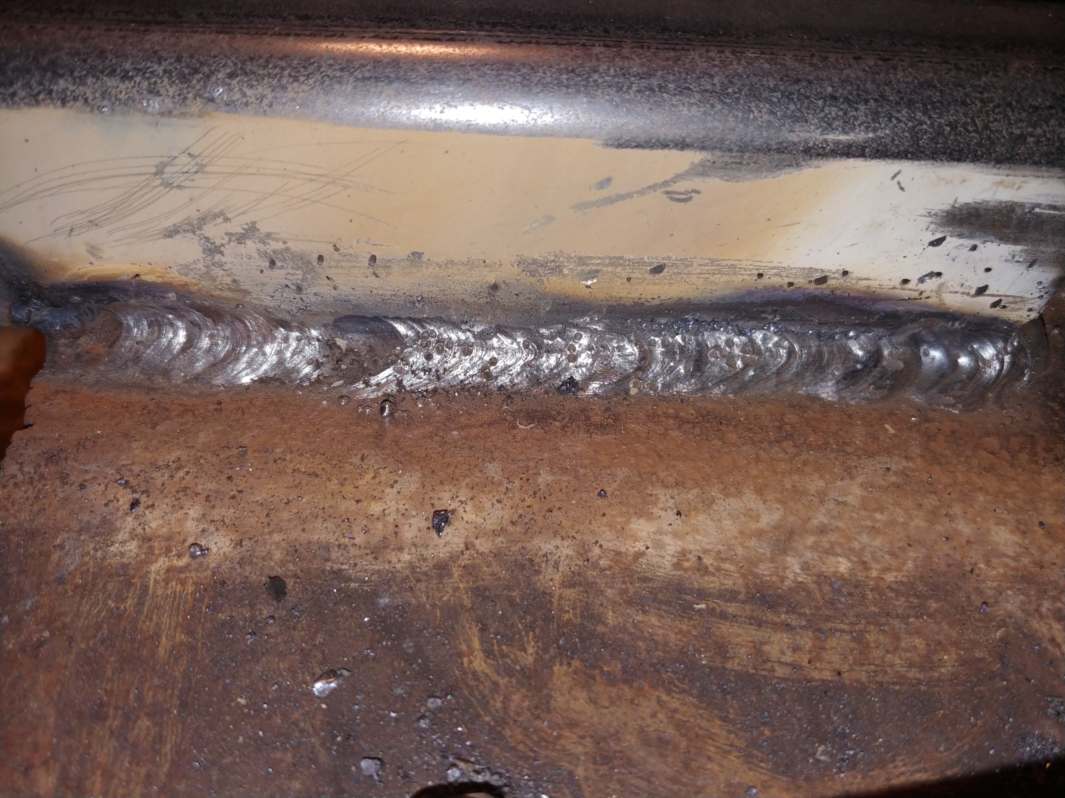

left to right, mig - center section 3/32 6011, had trouble keeping it lit - far right side i was trying to set manual mig settings to see if i could run different speed etc and find a way to see puddle better and it piled up on me with the mig.

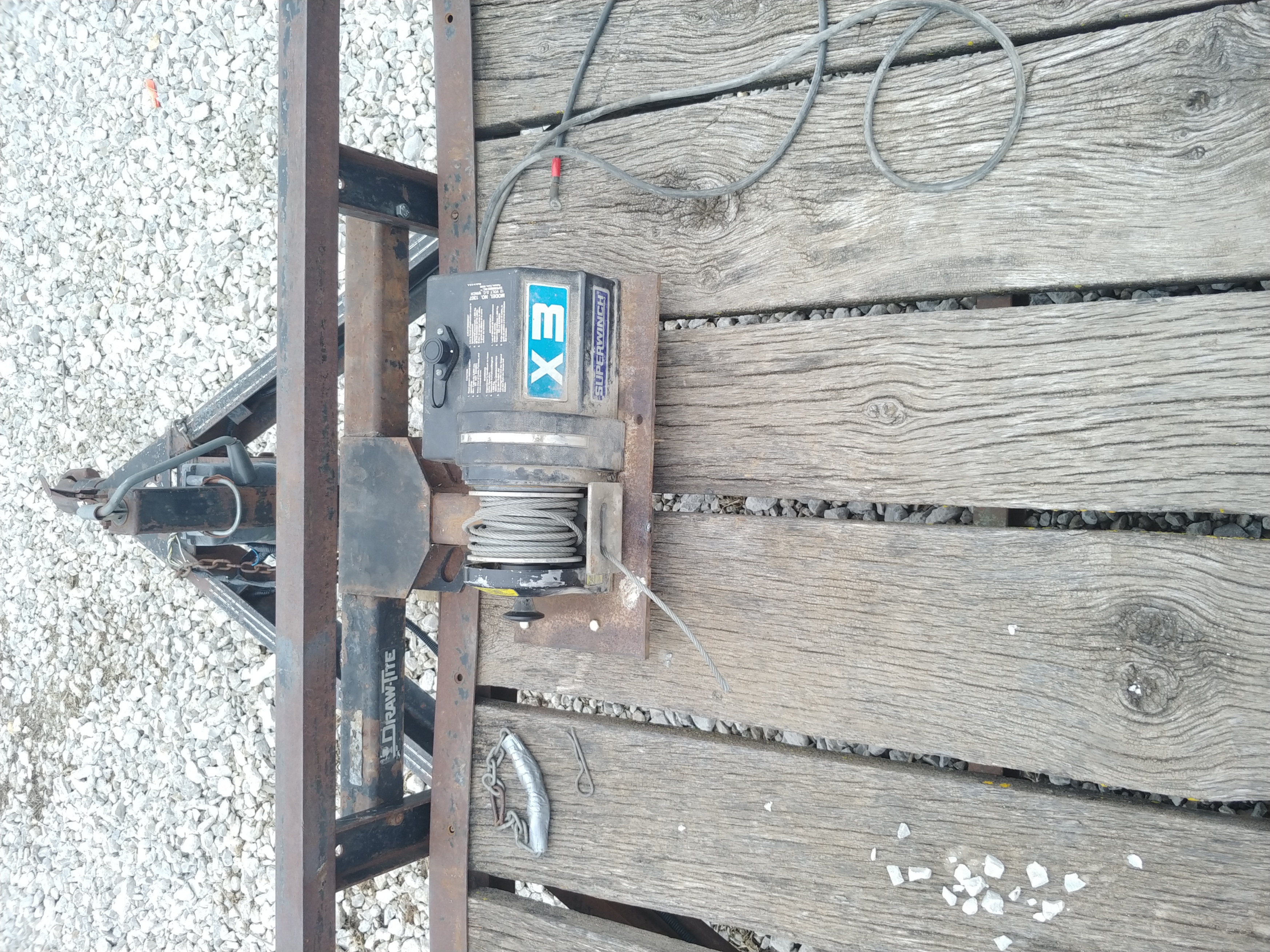

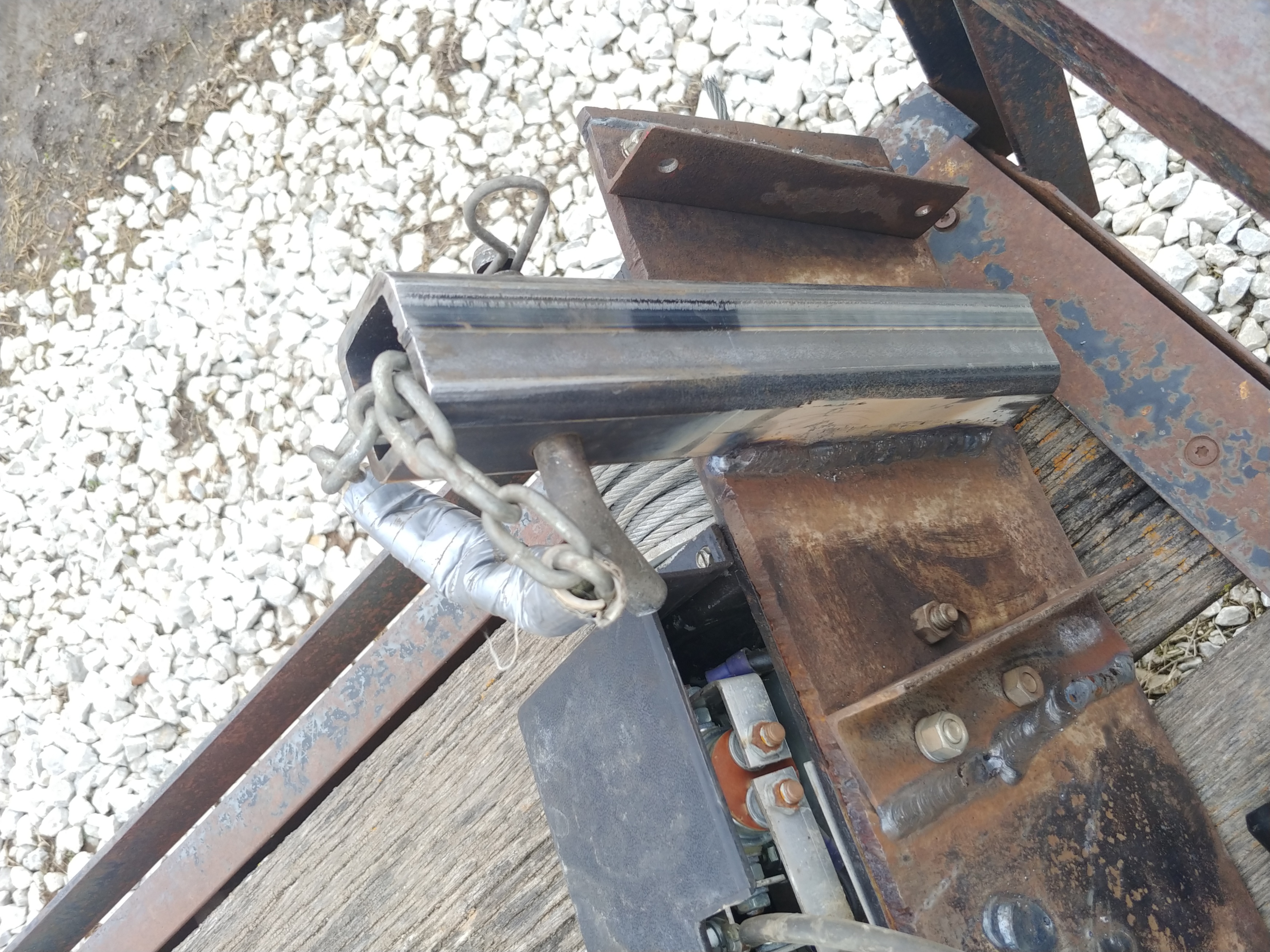

this is what i was welding on, adding the square tubing to my winch to allow it to slide into a receiver hitch for using on my trailer or truck or tractor by just sliding it into the hitch tube - i also made a handle to carry it with out of a piece of chain with a piece of garden hose to help it from tearing into your hand

this is the winch I was working on, got new control cable wired, receptacle replaced, now need to get end/hook crimped on

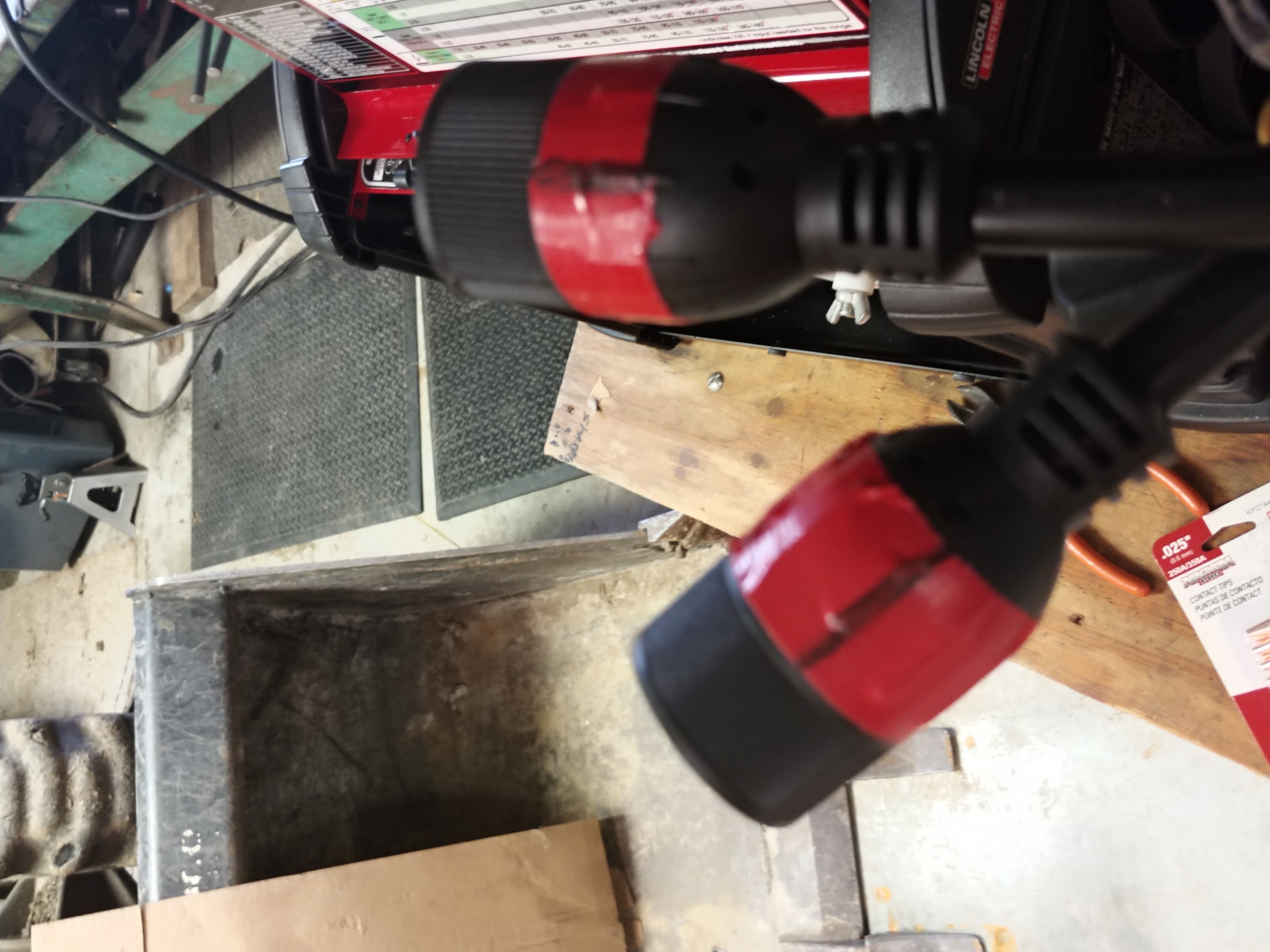

mu only beef at this point was they should have added a mark/locating arrow, indentation, something for the plugs, i wrapped a piece of red tap and made a mark with sharpie to get the locating pin for the twist lock at the 12 oclock position for plugging/storing/changing easier
well the pix didnt come out with the writing like i had anticipated, oh well its a puzzle you can put together - my first impressions were simple and easy to get running, however a little vague in the manual for rollers and guides but i figured it out. Could use a little better explanation for a first timer market machine.
