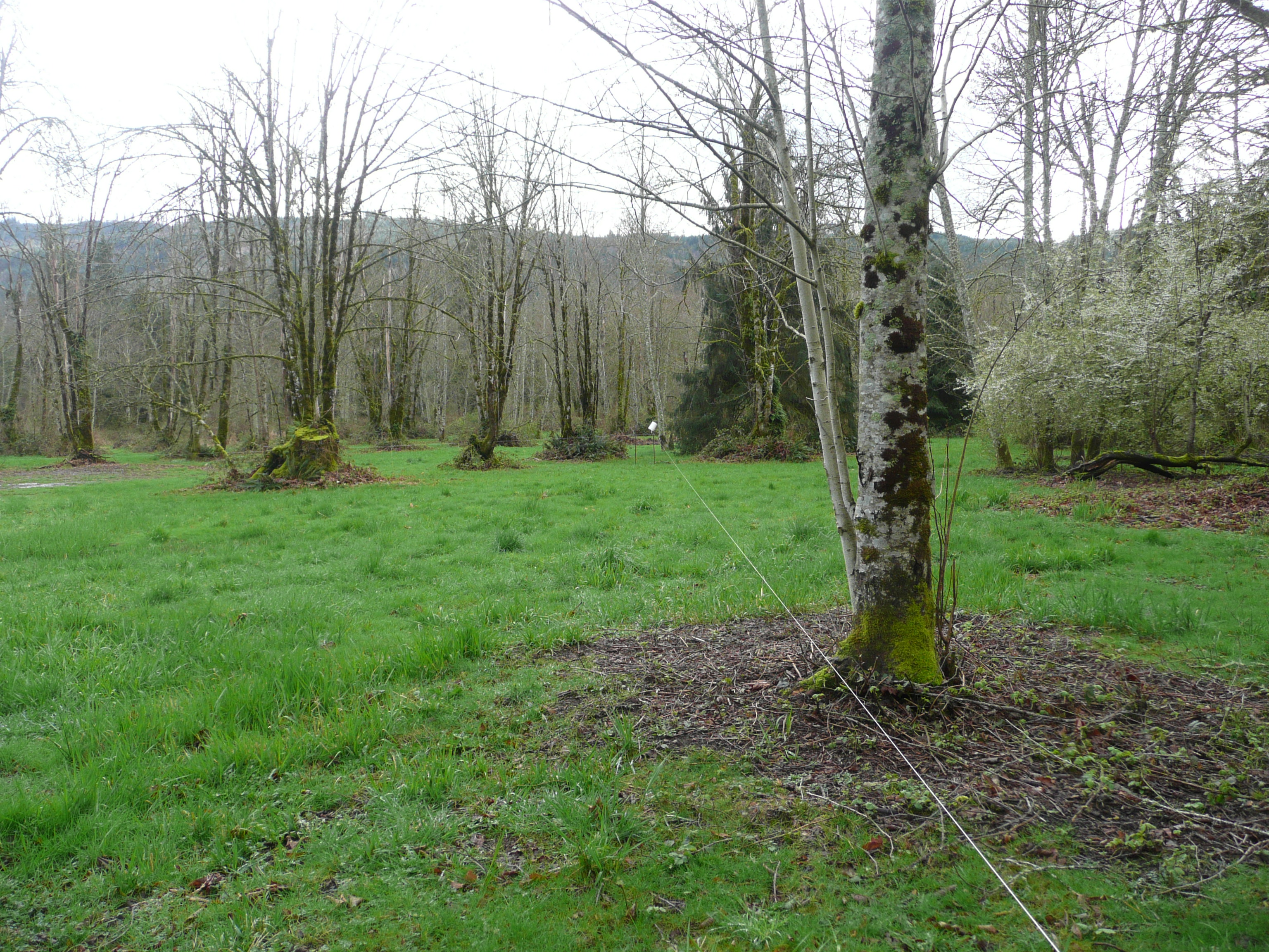

Here's a sampling of what my environment is like:
Reference picture for fencing: alder tree in foreground has been taken out and the stump is going to be removed this weekend. This is "established" pasture: about 70' to the rear is an area where you cannot take ANY machinery. Other areas are bit more difficult to work in, needing extensive clearing. It's the price for maintaining trees. I'll be running a flail mower on the tractor that I get; that'll help cut down on the outside swing (over using a rotary mower as I currently do).
