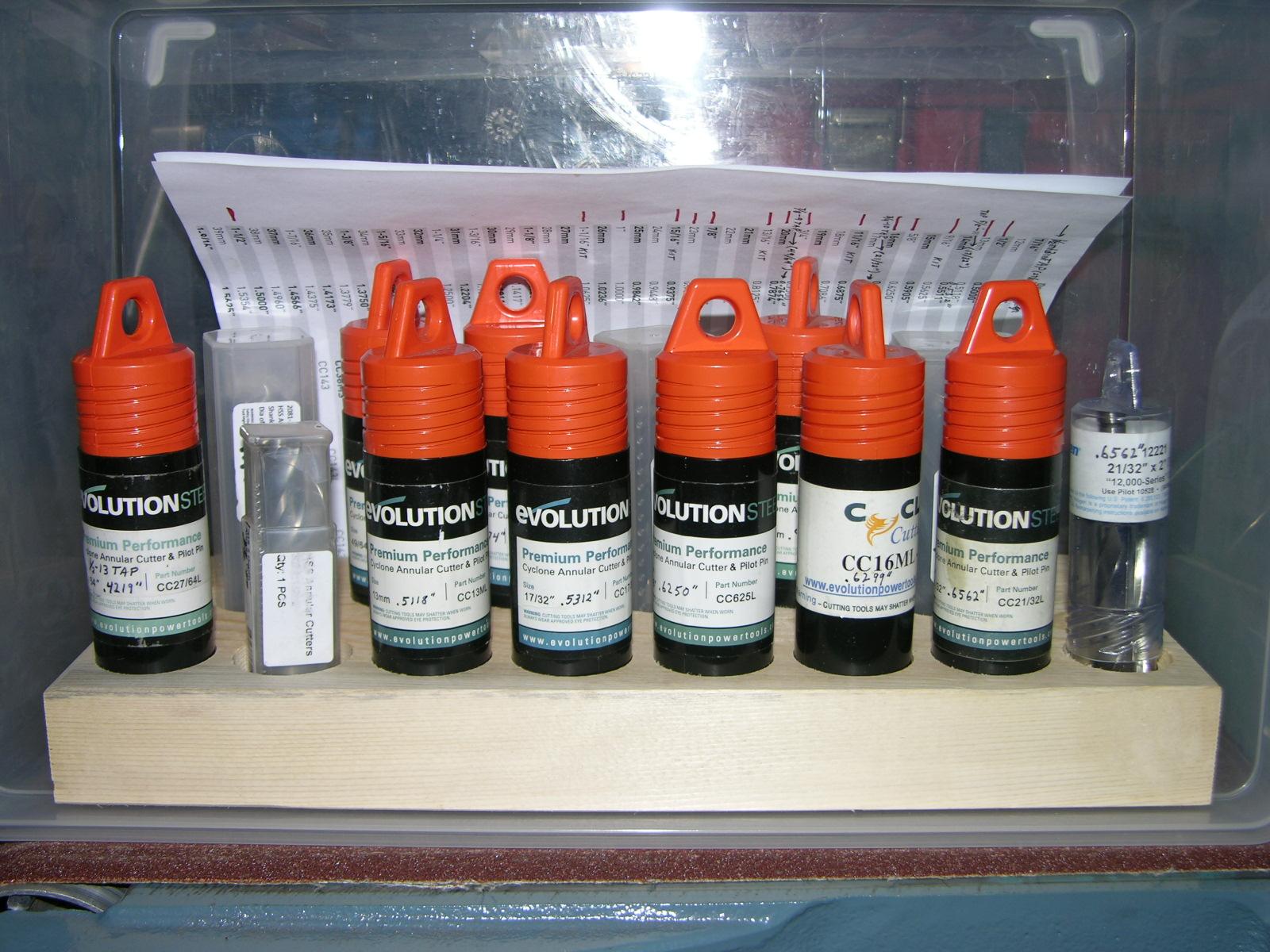

Wow, at $400 per size (not including the machine to use it) I'm kinda glad I got my mag drill when overtime was still an option - I went with a larger drill so I could drill larger holes easier, have about $2200 TOTAL (including 3 vises, xy table, etc) invested INCLUDING cutters from 7/16" up to 1-1/2" (the size of all the pins in my backhoe except 1) - most cutters up to 1" are $30-40 (the cost of a decent twist drill that size)
These days, if you don't need much bigger than 1" holes there are drills that'll do it for around $400.
Here's my setup
https://www.tractorbynet.com/forums...-table-build-6.html?highlight=mag+drill+table
I've added a few more cutters since this pic - DSCN1966.JPG - need to come up with a bigger "index" :D - if you only buy cutters as needed, the "onesie-twosies" aren't as painful as getting every size would be...
I do quite a bit of stuff using 1/4" wall square tube; I have over 100 holes on some of my bits, they're all still as sharp as new.
The part that ALWAYS makes me smile - a 5/8" hole in 1/4" steel takes me 20 SECONDS - NOT a misprint; no pilot hole, just do it. Anything I can't do on the table I can usually find a way to clamp a piece of steel to it (if it's not big enough by itself to just hold the drill to it and turn on the magnets)
For stuff that even the mag drill can't get to, the Blair rotobroach kit can drill down to 1/4" holes with a HAND HELD drill. (as long as you don't get TOO wobbly holding it; they CAN be broken, DAMHIKT :rolleyes:)
I know, not for everybody; but worth considering if you see a lot of bigger holes in your future... Steve

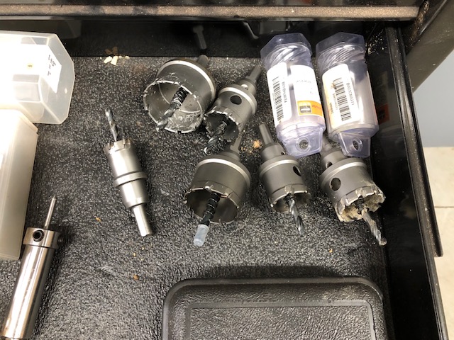

I tend to use hole saws for anything 3/4" and above.
Are you drilling free handed or with a press?
Same here. Go slow, lube, clear chips. Do't burn up the holesaw. It is a lot easier on the drill too.
/ Big drill bits #59
I unfortunately destroyed a 6" Millwalkee hold saw on a stainless electrical cabinet. Even used SS cutting fluid and went slow!
