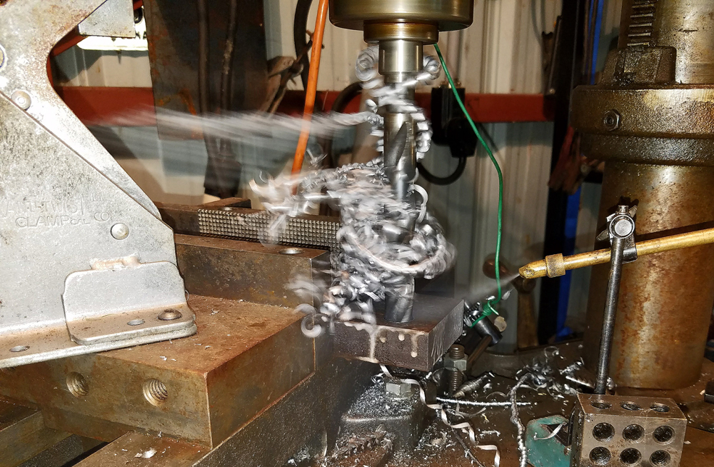

The drill bit is mostly not the issue, the drilling technique is the issue,,,
I have a power feed drill press, I can drill 1 1/2" holes, no problem
This pic shows the result of power feed,, continuous chips.
Without power feed, the pressure is intermittent, the metal being drilled will "work harden" the hardened steel quickly dulls the drill bit.
You can tell poor technique from the chips, little flakes means the pressure on the drill bit constantly is changing.
You can make continuous chips with a manual drill press, but, only when using small drill bits.
Using power feed, I have drilled hundreds of large diameter holes oven the last 15 years with this drill press, without needing to sharpen, or replace a drill bit.
Proper coolant helps also,,,
