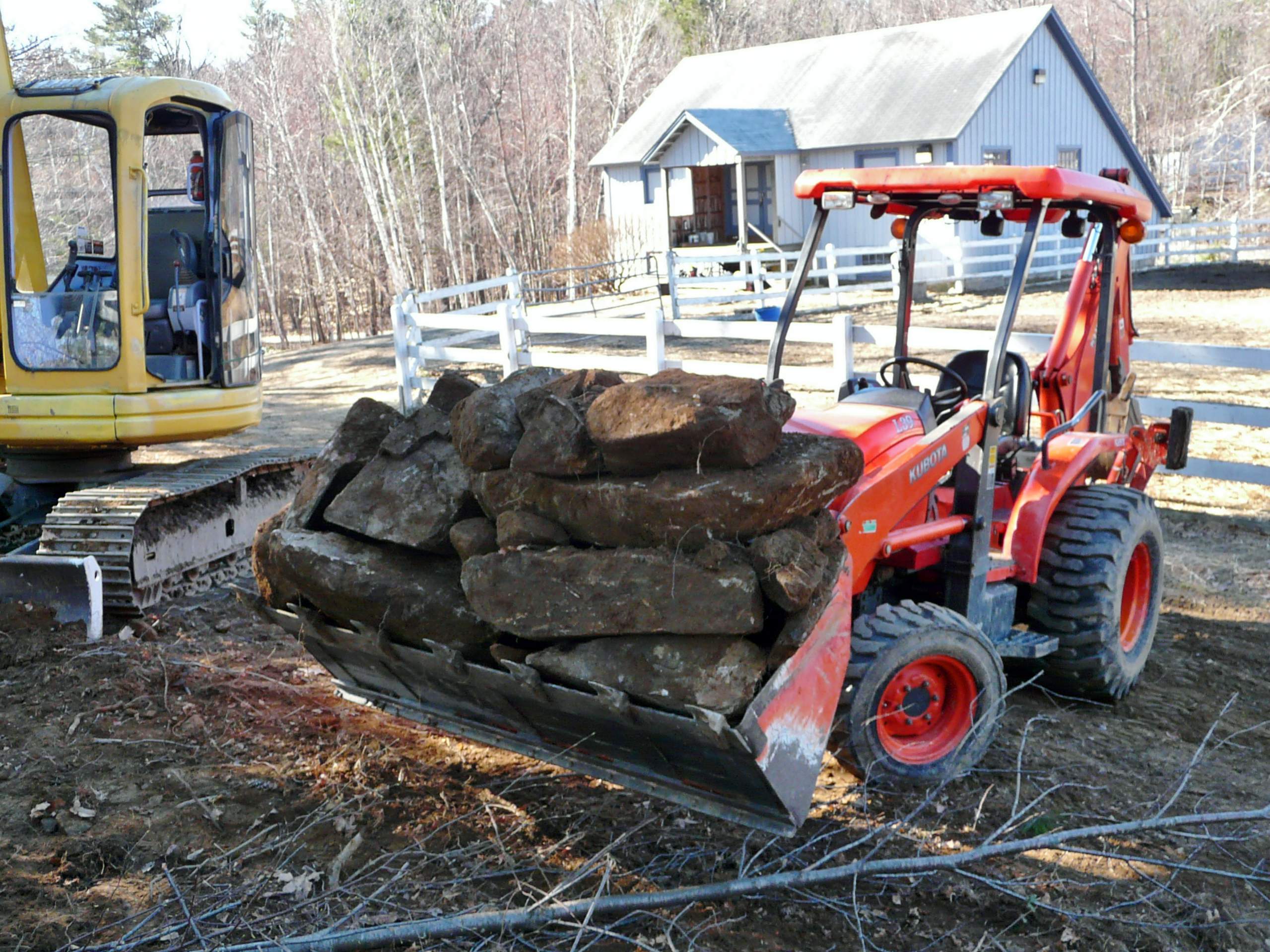

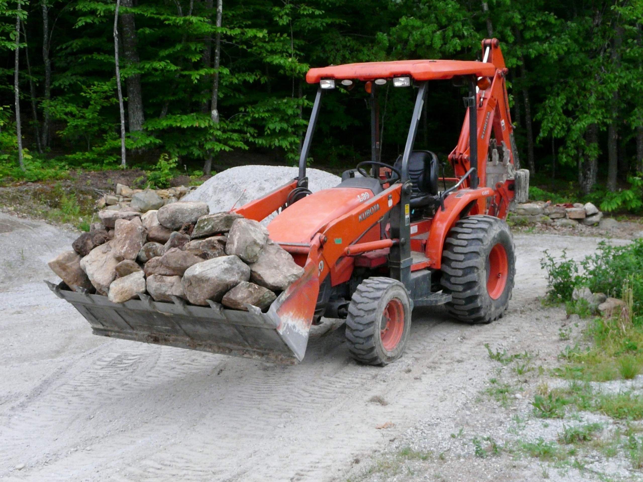

View attachment 439509Great choice. About as rugged and capable a unit as you'll find without getting into full-scale construction equipment. If you haven't already done so, spend some time searching the Kubota subforums here regarding the M59. There are a number of informative discussion threads and several M59 owners who may have useful comments.
If not already so equipped, would suggest the addition of a "toothbar" for the lower lip of the front bucket. Greatly increases the digging power of the loader's already considerable ability, and reinforces the bucket when dealing with rocks, etc. You can see the toothbar on my tractor in the attached photo; also note the chain hooks welded at the upper corners of the bucket for attaching a log chain, useful for securing, lifting or even pulling objects. There are many separate attachments that can be connected in lieu of the bucket, but those hooks are very handy regardless.

So what tooth bar is that, and is it bolt or weld on?
It's bolted on, dealer added it when I bought the tractor new in 2002, and it hasn't ever been removed. I think it's from W R Long.
