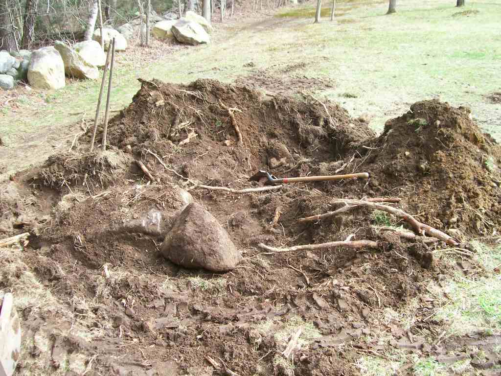

When I had my BX, I moved some pretty large rocks by getting the bucket under them, and using the curl function to lift the front edge of the bucket just slightly. This kind of uses the back of the bucket for leverage. I then chained them to the loader, and drove backwards to where I wanted the rocks moved. In essence, I was using the bucket for a stone boat. As others have mentioned, I have also rolled some pretty big ones too, like the large ones in the background here.
