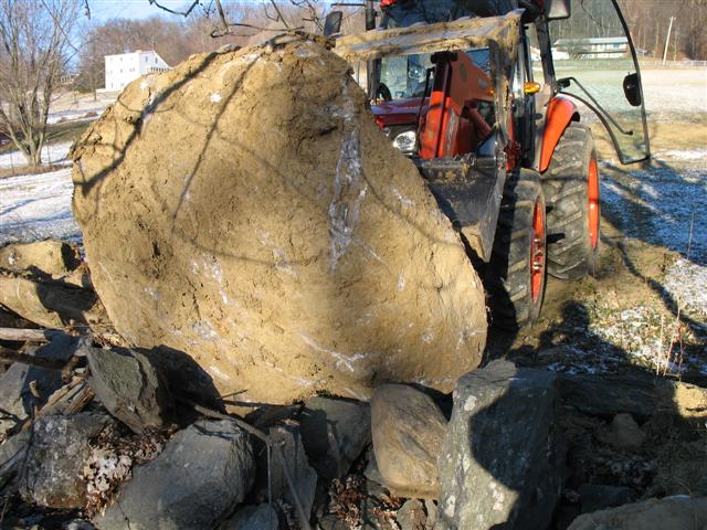

You will be surprised how big a boulder you can move by pushing it. This boulder was dug out of the ground and then pushed up a ramp to level ground and further pushed over in a fence line to the property
