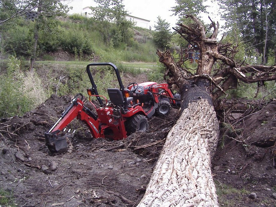

I thought I would post some pics of my latest project because I was impressed with my CT230 and Woods BH80-X hoe. I wasn't really sure it was going to be up to the task because this is by far the biggest tree I have attempted to take down. But, I thought if I could get the roots all around the tree broke, I could pull it down with my truck since most of the weight is to the west side where I wanted it to fall anyway. The other side of the tree had broken off before we bought the place, I still hated to take it down but it was kind of ugly with only half of the tree being there. I have planted plenty to replace it anyway.
It took me about 2.5 hours of digging to get it to the point I was ready to try to pull it down. That is a lot less time than I had figured it would take.
I measure the tree once I had it downed and it is around 85' tall and had a circumference at a couple feet up from the base was 9'9". I had dug down around 5-6' all around the tree and had several straps, cables and chains to get me far enough away from the tree when I tried to pull it over.
Now once I get it cut up, I don't know what I will do with the root ball because I am certain that my loader will not lift it. I may have to see if I can drag it back to the burn pile. I think I can knock a good portion of the dirt off it with the hoe so that should help.
I am very impressed with some of the jobs my tractor and hoe have been able to handle. I think it has been by far one of the best things I have ever bought. I certainly would do it all over again!

Well, I know it's alot easier dealing with the stump/root ball while it's attached to the rest of the tree, to use as a lever.
You would be there for 2 days trying to get that stump out of the ground, if you cut it down with a saw.
Did you need that space where the stump would of been?

I would much rather saw a tree up on the ground, it is just easier for me. I am sure others have a different opinion. I have cut trees down before and then tried to get the root ball out and yes, it takes a wole lot longer.
The stump would have been in the front yard so I didn't really want to leave it there and have to mow around it. I used a stump grinder on a few I cut down when we bought the place and it seems like every year I end up putting more dirt over them where they keep decaying. So I typically try to remove the stump if possible.

I take trees down like that fairly often with my full sized backhoe. Once I get enough dirt out of the way, I can push them over just about exactly where I want them with the hoe stick. I was wondering if you had enough weight to do that? and how much leverage you can get?
Once I decided on the side that the tree will fall, I dig that side first and try to get under the root ball as I go to the sides. That really helps in getting it to go the direction that I'm wanting it to go. I've never had a surprise doing this, but my dad has had a few go off to the side instead of the direction he's pushing. He's taken out thousands of trees this way, just like I have, so I really don't understand why this happens to him and not me.

Did the same but used a hitachi 135 trackhoe. You can reach much further up the tree I do this with my cottonwoods Which are about 80-100 feet by 30-40 inch diameter. Will have to try with the Kubota sometime. Nice job though
