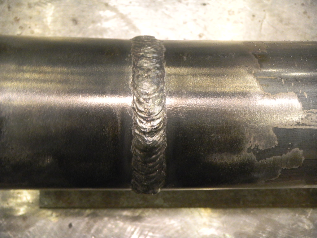

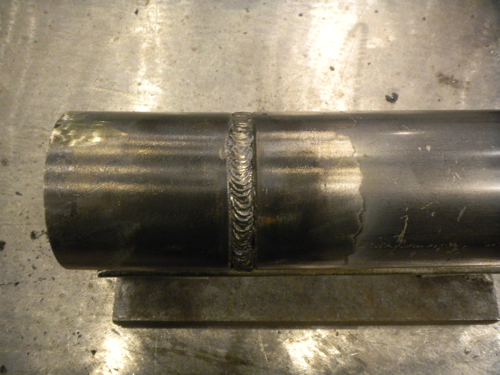

Had a little anxiety attack first thing this morning:laughing:, thought I had a DOA machine! Took a minute or two to figure out this machine doesn't like the arc force all the way up to +10. The power acted like it was pulsing. Changed back and forth from crisp to soft arc, then started playing with the arc force.
First picture is the hot pass with some 1/8 inch 6010 on 2 1/2 inch pipe 5-G. The second picture is the cap. Don't blame the machine, I'm not a pipe weldor!:ashamed:

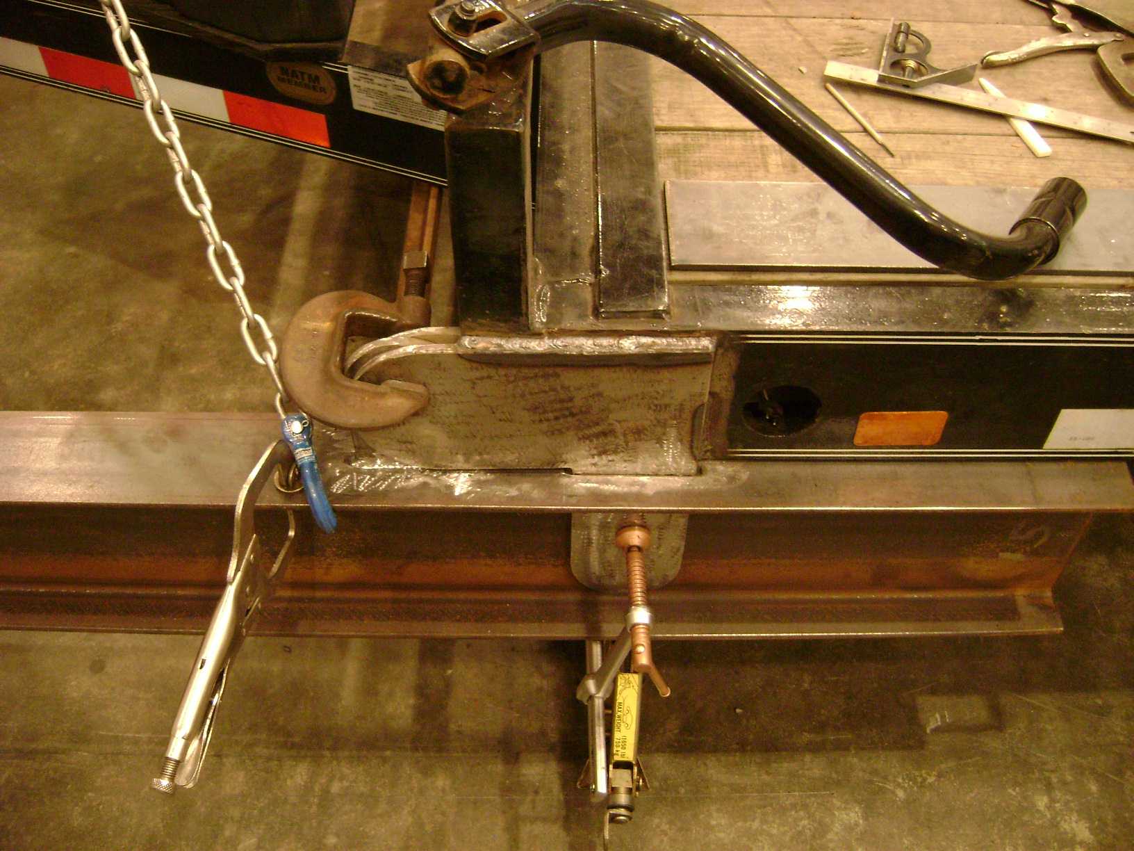

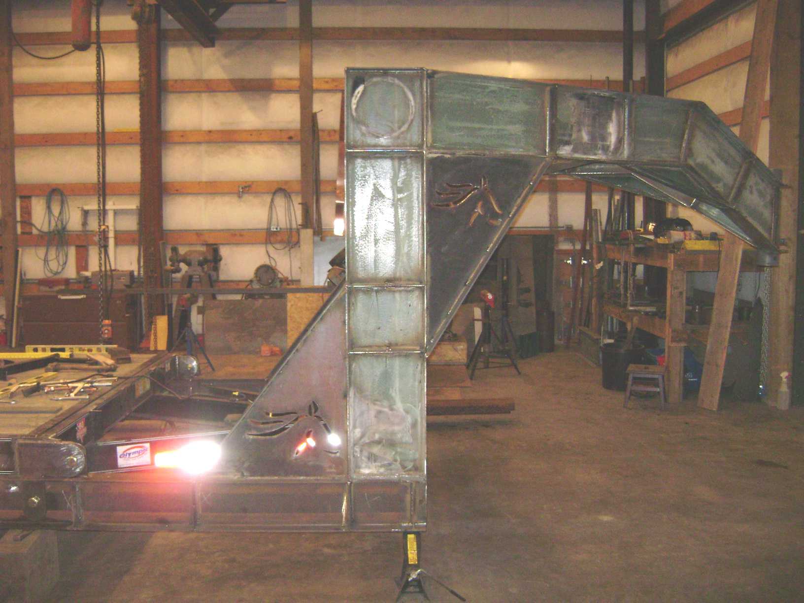

I generally only use Mig for big projects, like when I built my gooseneck adapter for my flatbed trailer.

Now that's pretty slick! I guess it comes off to still use the bumper hitch?
I have an old tandem axle trailer with a really overbuilt frame but only 3500# axles. I've been trying to figure how to get better use out of it and I may just turn it to a gooseneck and bob the tail. I got to quit reading all these threads, my project list is getting too big!
   / Big truck just arrived.
#17

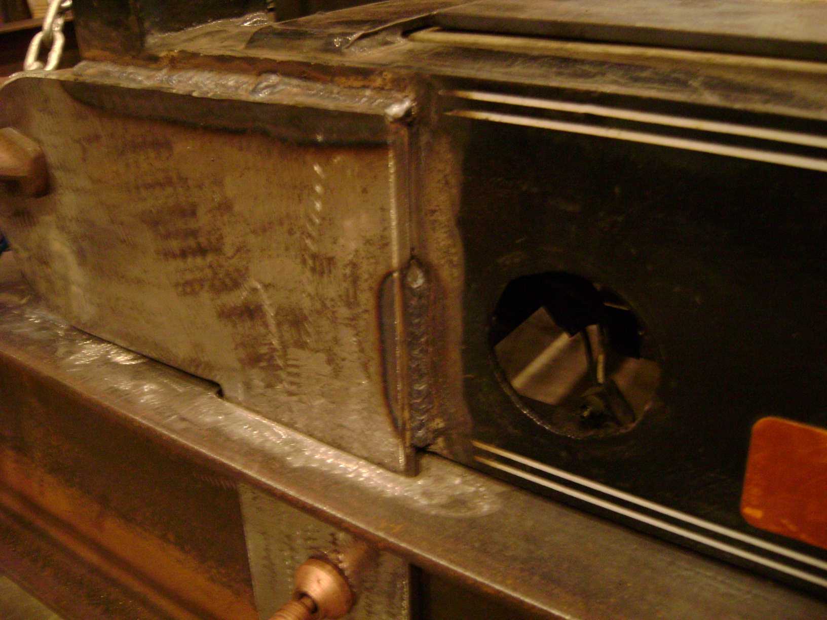

Yes it's bolted on. Can't remember if I used 1 inch or 1 1/2 inch A-325 bolts. 3 bolts per side.
