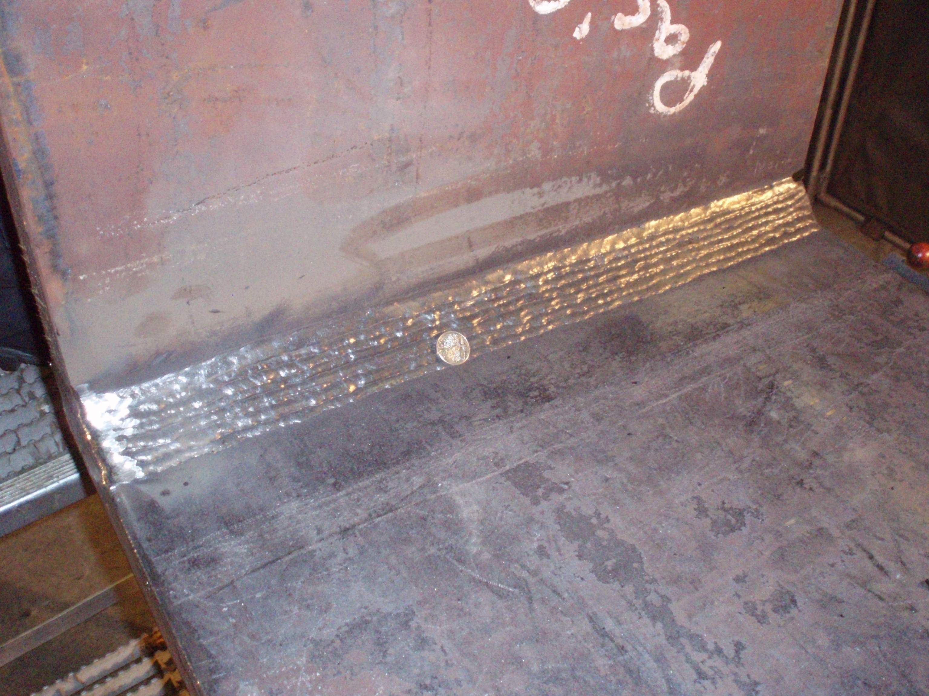

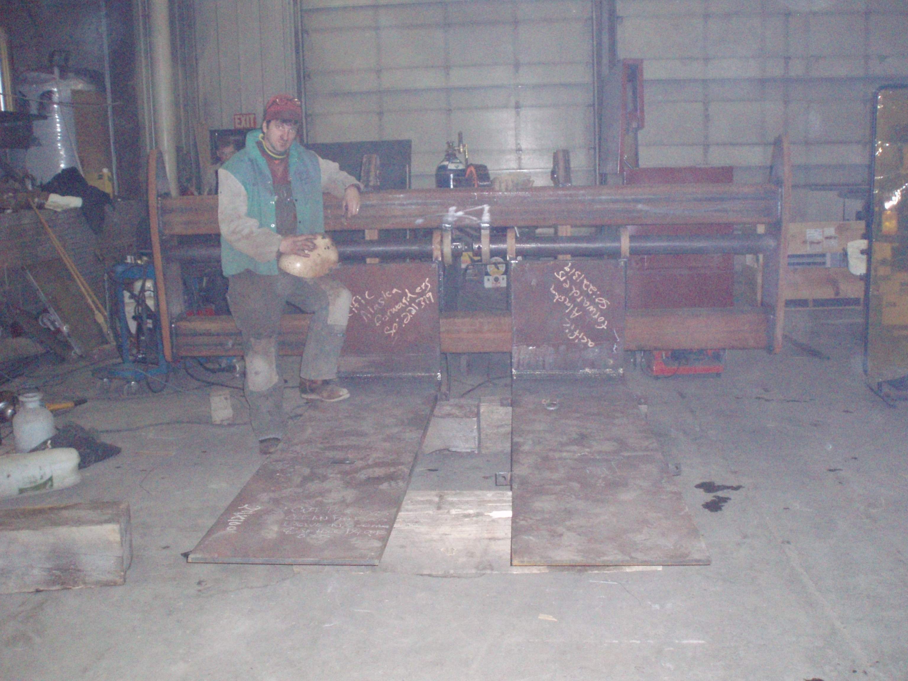

They had me build these monsters at work for a special application. Sorry about the poor quality pictures.
The picture of the weld is the 90 degree point of the fork. The small circle is a quarter.
The two welds on the forks took 77 pounds of wire, and three 10 hour days. Each fork is 8 foot long 30 inch high and 2 1/2 inches thick.
they ordered the T-1 steel from the east coast, and had it milled so the forks taper the last two feet to 1 inch thick. All the welds were inspected and UTed for safety by a 3rd party company.
They fit a large front end loader, a Volvo 180 or something. I also attached a quick coupler

Nice job! Those things must weigh nearly a ton each.
What size MIG did you use, and what preheat and postheat was required for the T-1?

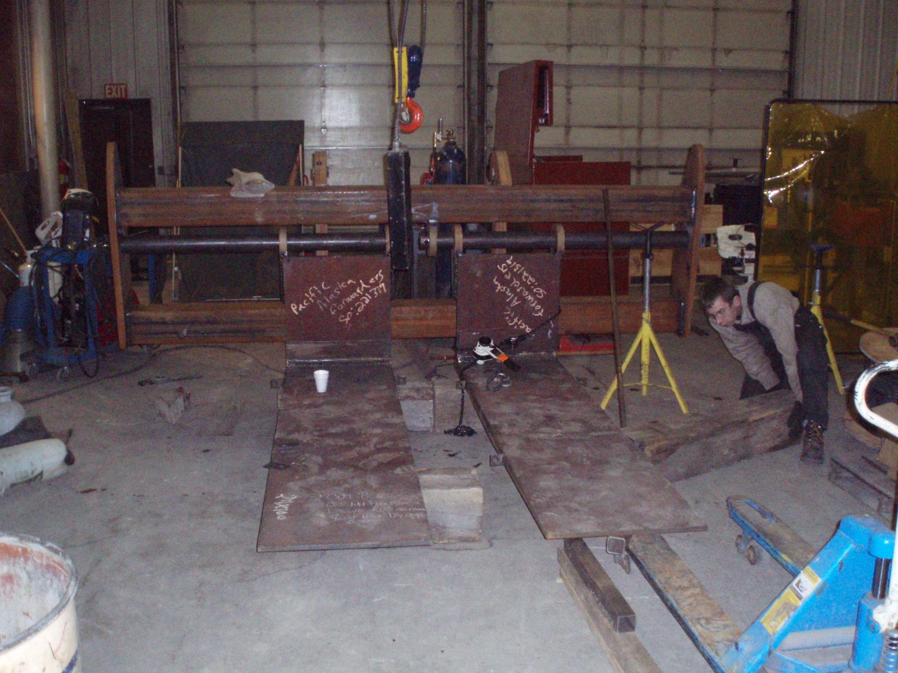

The forks are for a LARGE front end loader and I had to install the quick coupler on the back so the loader can drop them and add them as needed.
All of the none fork plate is cut by CNC water jet at a local shop.
No, the upright portion of the fork is 30 inches tall.
The weight? I have no idea, the plate steel is 1-3/4 high yield, the box tube is 8 x 8 x3/4 and the pins the fork is mounted on is 4 inch high yield steel.
The mast is 11 ft. wide
While we were building them we used an overhead crane and welded picking eyes wherever needed.
30 hours of welding just for the forks, me and an apprentice took 6 1/2 days at ten hours a day.
The welding on the forks was nothing abnormal, minimum preheat was 250 degrees, maximum interpass/preheat was 400 degrees. since this was not to crazy on the weld we used a DC-400 power source and a LN-3 (?) squirt feeder wire unit. I used .045 dual shield wire with a yield of 110,000 PSI and 75/25 backing gas.
On the rest of the unit we used what ever 80,000 PSI dual shield wire we had available, 81K2H mostly with 75/25 gas. The preheat was not as critical and the weld did not see anywhere near the stress. Most welds were 3/4 fillets.
We insulate pipe for oil field use here, the short of it is we wind a sprial duct around the pipe and cap the ends of the duct, then inject liquid foam in and let it expand and cure. If you use narrow forks to pick up the pipe when insulated it crushes the insulation. So we build one of a kind forks to use. Also has been discovered that the wider forks are better on all kinds of lift applications.

I would love to see the forks mounted to the unit if you get a chance to take a pic.
