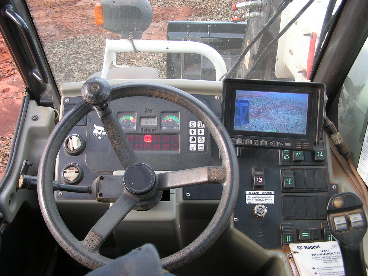

That's a really interesting tractor. But I don't understand a hand control for fwd/rev rather than a peddle. How do you operate a loader like that? One hand on the loader control, one hand on the fwd/rev control, and one hand on the wheel? I must be missing something.
You're missing a third hand.
My V417 has a F-N-R lever on the left side of the steering column and a foot pedal that controls the speed.
Usually leave my right hand on the joystick and steer with the knob. It only takes a second to change directions since it is an electric switch:
   / Biggest tractor with hydrostatic drive? #36
Same with our Toolcats. It takes no more time or effort to switch directions than it does for someone to move their foot on the peddle.
   / Biggest tractor with hydrostatic drive? #37
Yes, its the same setup as most commercial front loaders
Flip the forward/reverser with your fingertips and your going the other way.
Easy, don't know where the "need 3 hands" comes from. Simply false.
Yep, the only problem is after using it for a while and parking it, I get in the truck, flip the lever to back out of the garage, it doesn't move, the turn signal just flashes :eek:.

That’s right! Your brain goes with what you know... Sometimes I actually say to myself, why is this things not moving.
That’s the same setup my backhoe has. And it has a twist knob to change the gears. It works fine and you don’t need 3 hands. I like the ability to change the gears on the go, a feature not found on many HST transmissions. Anyone who falsely says a HST is a complicated system better stay far away from these systems. My buddy’s wheels loader has 2 push buttons on the loader control stick that change the direction. It works fine and is operator friendly but he only has a hi/low transmission and it’s not a shift on the fly setup so essentially the throttle is the only speed control you have.
