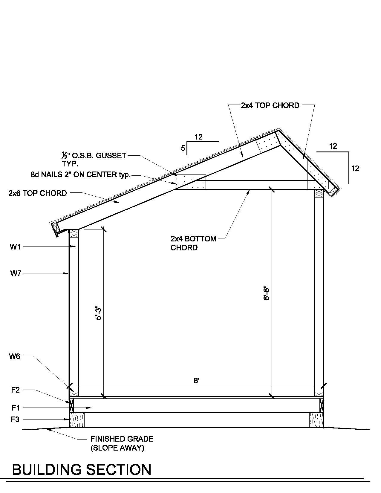

I've sort of been curious what the concern is about making the bird's mouth cut. Once you get the hang of it, it's not difficult. Structurally, the metal plate connectors are much more resistant to pullout and uplift.
I'm not that concerned about them. I was just trying to plan out the project in my head. I figured that taking my time getting 1 rafter made right would allow me use it as a template. Although connectors do seem simpler.

If your walls are equally spaced, then you should be able to make one template and cut the rest of the rafters with no problem. If your walls are't equally spaced, then it changes your rafter dimensions.
I do this just often enough that I have to look at my carpentry reference books to make sure I'm on the right track and then I compare the rafter table measurements with the measurements I get on the calculator. Then I cut a pair of rafters and see if they actually fit.
The traditional method is to toenail the rafter in place, but metal connectors have a much stronger resistance to pull out and are easier for me at least than the toenail method. Whether or not the code requires them, they make for a stronger connection in your building. When it's all done, it's your building.

I want to build a woodshed that looks pretty much like a run-in shed. Some plans I've seen call for a salt box style roof using bird's mouth cuts on the rafters. Can I eliminate those cuts and use rafter ties instead?
I drew up a section of a salt box shed. It is for a 8' deep shed. The back roof uses a 2x6 top chord and the front uses a 2x4 top chord. The front top chord runs over the top plate like a typical truss because with the 12/12 pitch there would not be enough wood left after creating a birds mouth. I hope this helps others to build a salt box shed.
I have drawn full plans to this shed at Building A Shed | icreatables.com
Hope this helps,
