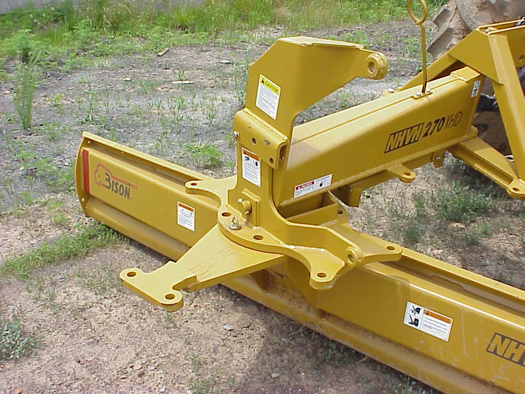

   / Bison Rear Blades
Guys,
It turns out this is a great blade.
Very well made. Might just outlast me.
Phred
   / Bison Rear Blades
#9
Here is an up close shot.
One of the things I like about this blade is that It already is all set up for hydraluics. I just have to add the cylinders.
Phred
   / Bison Rear Blades #10
Hi Fred...
It certainly looks to be an extremely hefty unit from your pictures... can you get a "front" shot of the A-frame...?
If you put a couple 3/8" side plates on that brute... it will become one big mean 9' box blade... /w3tcompact/icons/blush.gif
The index plate looks about 1" thick... and everything is ready for a rear wheel, hydraulics all the way around... the moldboard looks very well designed with the enclosed gussets/support across the entire span, with end support as well for "ditching"...
Fred... I like it...! /w3tcompact/icons/smile.gif
Can you explain their number/model system...? 240/270/300 ? I checked their website, but don't quite understand the differences...
You have one mean blade there Fred... you'll break something on the tractor before that moldboard bends... /w3tcompact/icons/eyes.gif
