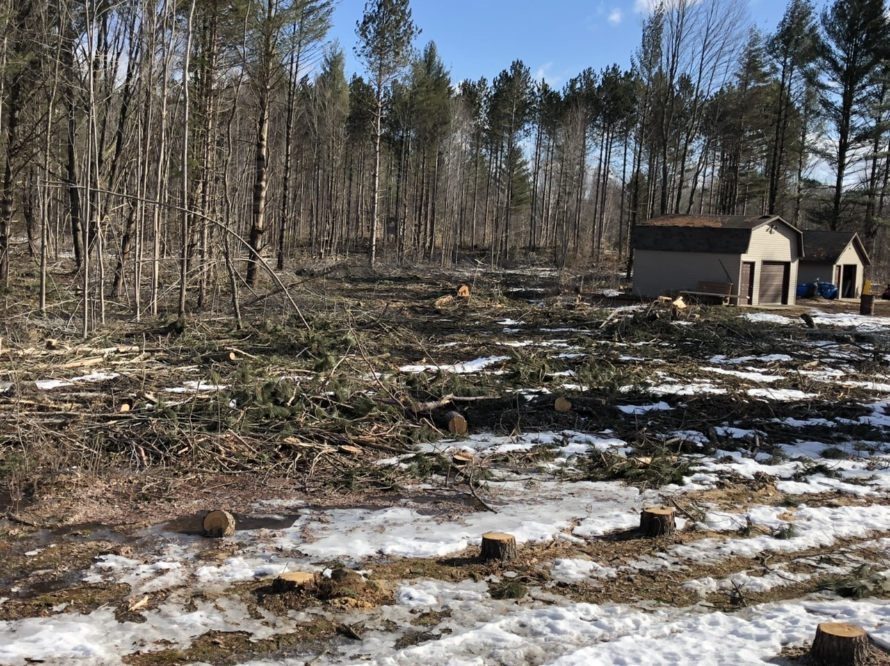

From this to this .
   / BIY tooth bar - CRS/Mild Steel ok? abbrasive resistant metal a must? #12
Made my removeable tooth bar with buying bucket teeth $50 a piece and a piece of scrap steel laying around the shop. It's easily removeable with 2 bolts that tie into the sides of the bucket. Couple hours work, couple of buds, worth its weight in gold. 🍻
